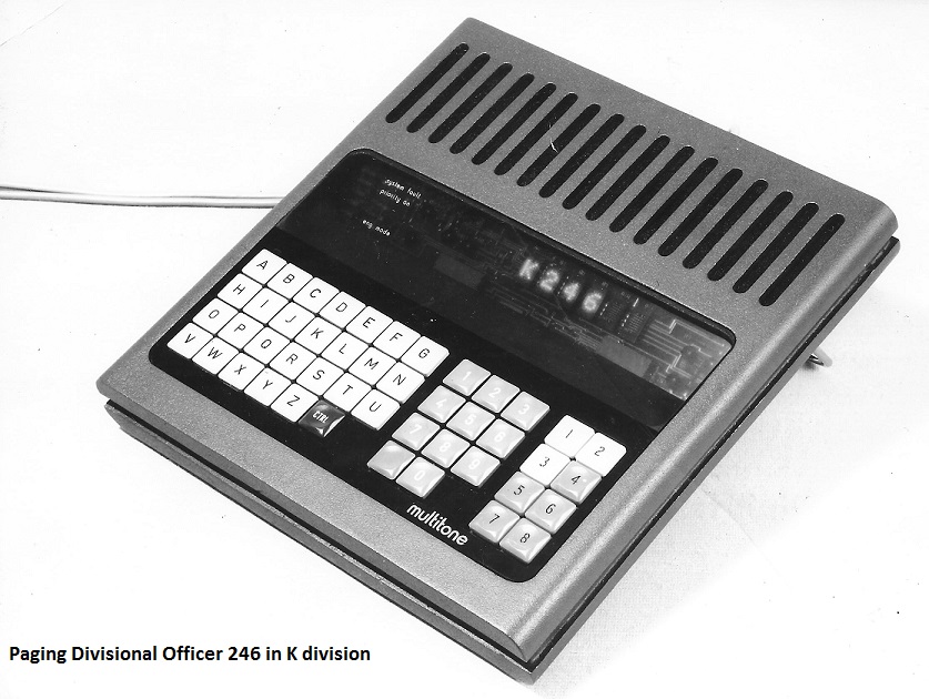

I have designed display systems where limited power required over current pulsing to achieve a perceived inscrease in brighness. This was late 1970 using the TIL311
