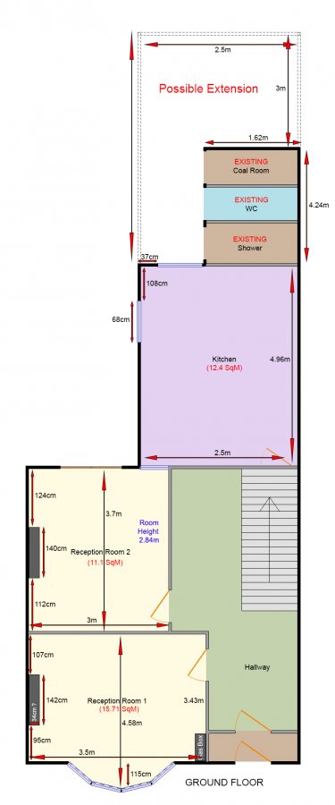

Hi I have just purchased a 3 bed mid terraced house in Acocks Green Birmingham and am trying to decide if planning application is required for the following setup.
I am unclear if a brick build outbuilding define the end of the current building so that I can build 3m measuring from there or the external kitchen wall is where to start the 3m from ?
(I have done a similar extension at a different property and did not need planning where I simple replaced outbuildings for a small room but did not extend out, only building regs were needed).
I am also aware that some of the neighbours have built extension similar but they might have built using planning permission.
I am also aware of the 45 degree rule and have to be mindful of this.
The configuration is as follows :
Any help would be greatly appreciated. Thanks Kuldip.

Plans will cost the same in Acocks Green as they will in Hall Green, Sparkhill, Shirley or Solihull. £400 for crap ones, double for better ones.
Despite what Acivico have told you, the plans need to be accurate and scaled and they are concerned if they can't make head nor tail of them. It's not just about the plans, but about the detail and specification on them.

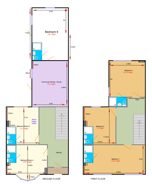

Also, I ultimately will be converting this to a 6 bed HMO i.e. (3 beds upstairs + two reception rooms + extension) and I am presuming both the extension and creation of en-suites in each room don't conflict.
Planning. I do know for a fact that I do NOT need planning permission for this HMO as its less than 6 Bed on 2 floors. I have confirmed this by emailing a senior planner in Birmingham Planning Dept (who I know from another house conversion).
I also have been in touch with HMO team who advise me that this constitutes an unlicensed HMO because its less than 6 en-suite rooms.

I don't know the rules you are talking about but less than 6 would be 5 or less. Not 6.
Also where are the 2 reception rooms you mention.I only see a kitchen/diner and 6 bedrooms.
Do any other houses have such deep extensions at the rear? How longs the remaining garden?
The rules in question (6 Bed) come from a planning document that was forwarded to me from the senior planner at Birmingham planning dept. I had it spelled out to me in an email. Basically, a 6 bed change does not require change of use from C3 to C4 “Sui Generis”.
Sorry, so there are 3 bedrooms upstairs + the two receptions rooms converted to bedrooms + the extension forming the 6th bedroom.
Yes, a few houses have got extensions reaching to the rear. These gardens are huge, like 15 x 6' fence panel.

Well, an update. I have had an architect come round and he says I can go 6m to the rear on a "Prior Planning Approval" with no fee and just get on with it. this would give me a room of 2.6m x 5.7m (13.11Sqm).
Otherwise its a full planning application with could takes up to a year OMG!.
Anyway, this chap says it will be £750 (inc) for planning & building Reg drawings!. Is that good I am not sure. There would only be fee of approx £135 for the building regs (which includes a the en-suites in the 6 rooms).
Look like that might be the way forward. : )
