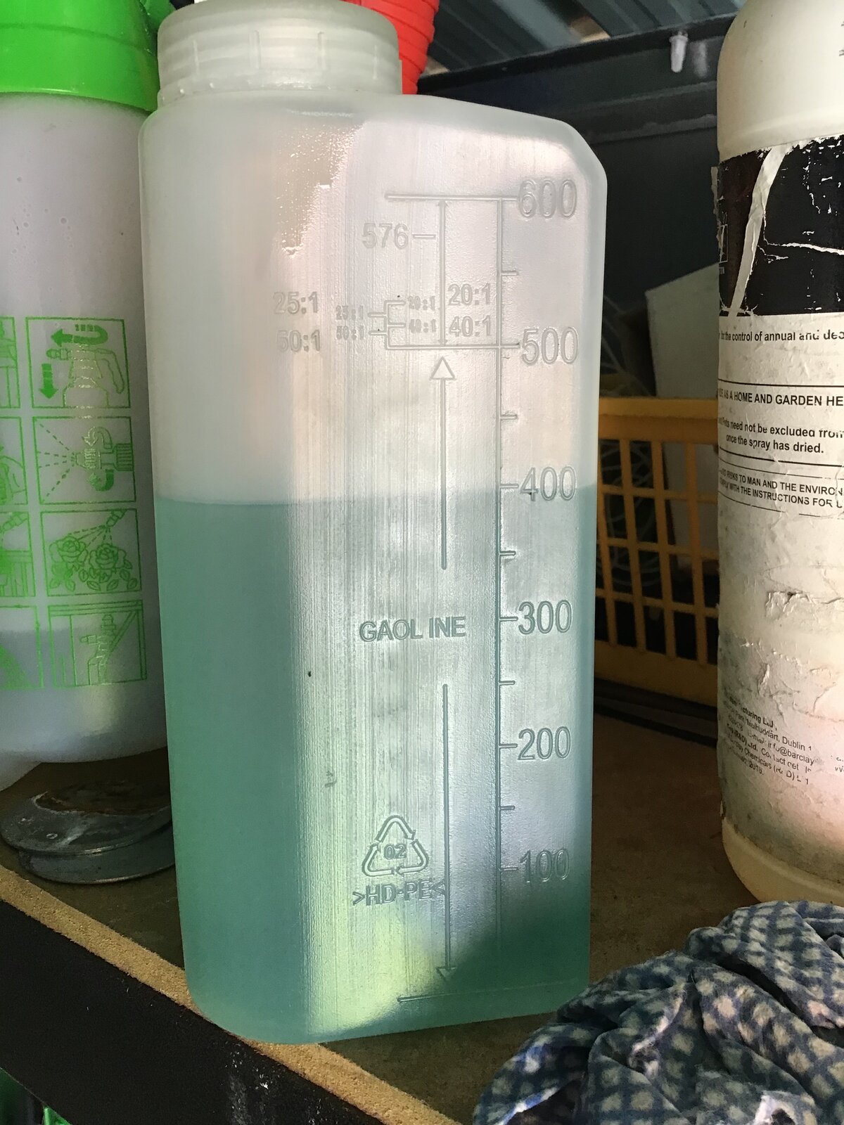

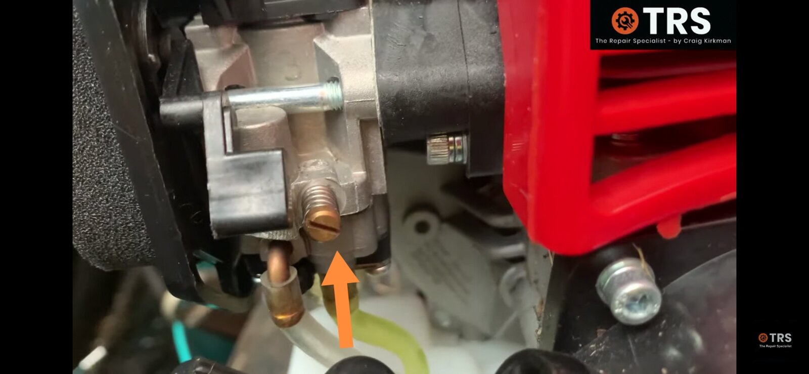

Afternoon all.
I have a cg430 brush cutter petrol strimmer and a couple of days ago it cut out as I think the fuel was low but now it will not start after refuelling. I've checked the air filter and took apart the carburettor just to have a look which all appears fine and I checked the spark plug which again appears fine. When I put it all back together it did start for only a couple of seconds then dies. Any ideas what else I can check. I've not got a manual for it but what is the setting for the single fuel adjuster screw? Thanks in advance.

Adjustment Screw: For the fuel adjustment screw, it can depend on the exact model of the engine, so it's difficult to provide exact instructions. As a general rule though, you could try gently turning it all the way in (clockwise), then turning it back out (counter-clockwise) about 1 1/2 to 2 turns as a starting point. From there, you can fine-tune it based on the engine's performance. Turn the screw in small increments, waiting a moment for the engine to respond. The aim is to find the point where the engine runs smoothly, without any stalling or excessive smoking. Be careful not to over tighten the screw as this can damage the seat.

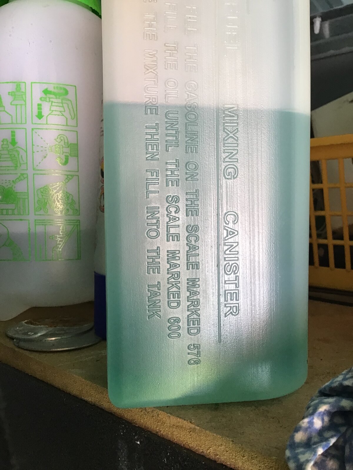

I took the carburetor apart again last night and cleaned it through. Took the fuel filter out also which appeared ok but wasn‘t really sure what I was looking for. Put it all back together today and it started and ran for a little while but after a squeezing the throttle a little bit it cut out. Started it again and it would tick over for a few seconds and then cuts out. It then wouldn’t start. With regards to the fuel/oil mixture I just follow what it tells me on the plastic mixing bottle which is a little confusing because on one side it says to fill up with fuel to 576 then top up to 600 with oil but on the other side it says to fill up to 500 with fuel.

Fuel/oil mixture instructions can indeed be a bit confusing. However, it's important to get the mixture correct as using an incorrect mixture can cause engine problems.
As a general rule of thumb, many brush cutters use a 50:1 or 40:1 fuel to oil ratio, which equates to 20ml or 25ml of oil per litre of petrol respectively. This is what the instructions on your bottle are likely referring to.
So, if you fill up the fuel to 576 and top up to 600 with oil, you're creating a 50:1 mix. On the other hand, if you fill up to 500 with fuel and top up with oil, the ratio is different and likely not suitable for your brush cutter. Always follow the ratio recommended by the manufacturer for your specific model.

Thanks for your help. Just to cover all bases, I ordered a new spark plug as I noticed it was quite oily on the tip so for sake of a few quid I might aswell just change it. A new fuel filter purchased also and I'll check the exhaust when the other bits arrive. I'm going to empty the fuel tank and replace with fresh fuel and I found an online manual which if I've read right it says 25:1 mixture so I will try that ratio I'm now thinking, especially with your advice that it's not set up properly and maybe it never has been. I think it might not be getting enough fuel through. The reason I'm thinking is the cutter only runs with the choke on, it has from the day I purchased it which was over a year ago. As soon as the choke is closed even though the machine is warmed up, it just cuts out.
