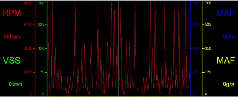

Hello!
I have some idle problem with my 206.
first i found that my turtle body is broken. so change it, then
I barrow an OBD2 scanner and i think i found the trouble maker
what do you think?
is it fault?
I've tried to clean it from all of the oil it has absorb bot its still going up and down like crazy.
thanks, and sorry for my bad English.

its doing this only when the car is hot-after a20 min of driving.
the RPM is going from 400 to 1200 and the engine light is going on and off.
after its sit for a while the car is back to normal till its getting hot again.

I used an ELM327 and don't know how accurate it is.
i have:
P0350 - Ignition Coil Primary/Se....
P0200 - Injector Circuit/Open
P0105 - Mainifold Absolute Pressure/Barometric Pre...
P0002 - Fuel Volume Control...
Hopefully some of those are old codes, did you try clearing them and going for a drive. It might flag one or two codes to point you in the right direction?
well, i cleared the codes, took it to a drive and after 20 min when the car reached to 90 deg the car start to staling and the light came on and off, checked the code and got only P0200 - injector circuit/open

found the problem finely,
second injector from the right is stop tiking - when the engine is staling.
dissemble the wire connector and spray with contact cleaner,
still the same, coming on and off,
is it possible that the injector is bad?
or the wire some where is bad?

You need to test across the 2 injector terminals with a multimeter set on ohms, expect to see roughly 12 to 16 ohms for a good one and open circuit for a bad one.
ive change between the injector and the problem is in the injector.
