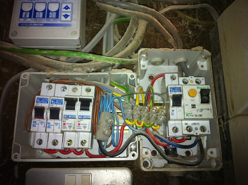

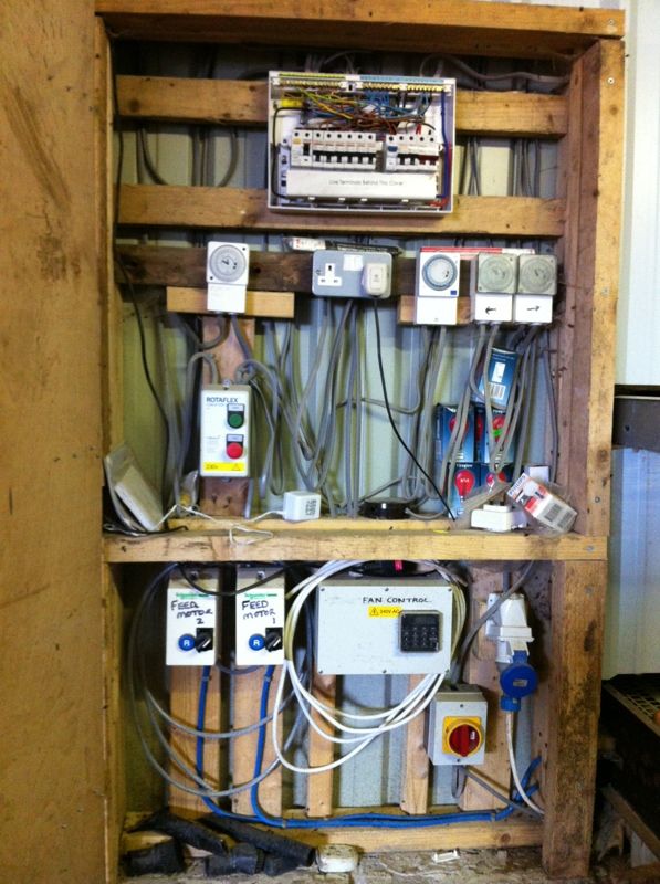

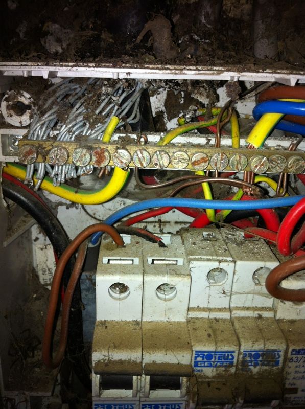

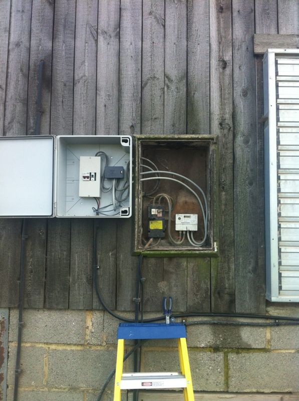

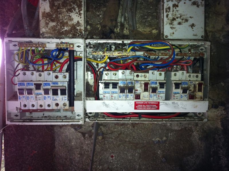

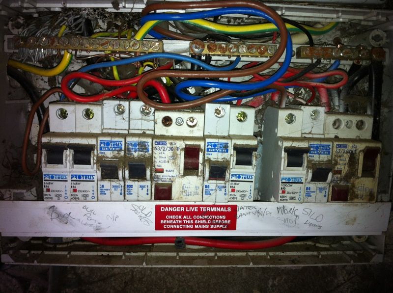

Sorry it's been so long, but I thought it time to ressurect this once great feature.

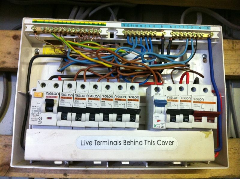

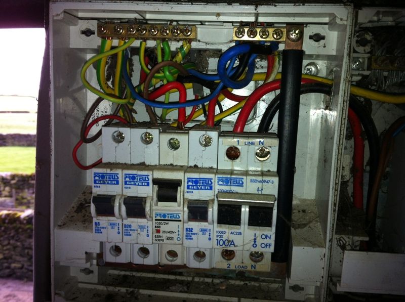

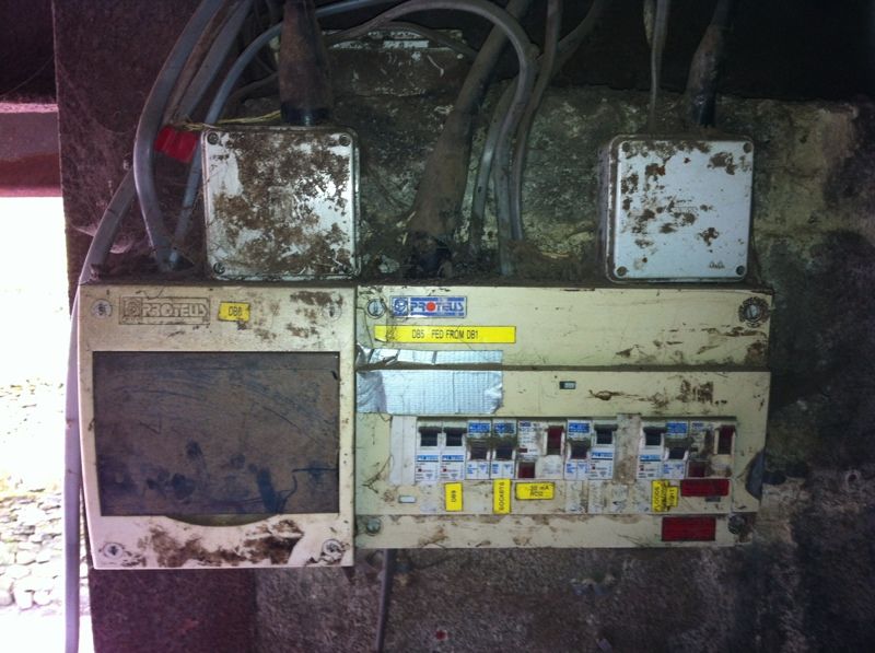

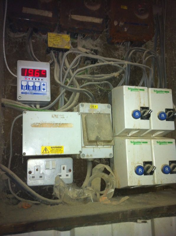

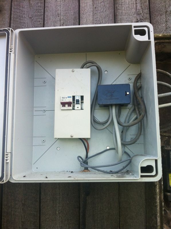

I went to do a periodic on a poultry farm this week.
:x
I would love to see a copy of your report!
A clucking good read I should imagine.
thats a clucking mess,and i know nuffing bout electrics.
but wtf is a chock block doing in there????
To be honest as sloppy an install as it is, there's very little we could actually fail it on. There's a whole heap of C3s, a couple of C2s and that's about it.
