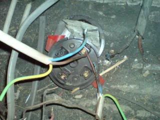

Lamenting the passing of RF's excellent regular feature, I thought I'd post a piccy of something I found recently.

This was a call-out to a flat above an Indian restaurant. Complaint: sockets not working.
We traced it to this mess. The rubber cable you see is a spur from a socket below in the kitchen. It was found in that position, live and free of the JB.
It has no cpc, hence the cpcs of the 1mm² flexes going off to the individual sockets were not connected either.
There were four flexes attached and they were well-overloaded. 3 of the sockets were running a 3kW heater each, plus other loads besides. i'm surprised the B32 didn't pop, considering the circuit also ran most of the kitchen's appliances.
But you can see signs of burning where the 1mm² (or more likely, a loose connection) was complaining about the load. I did not manage to take a piccy of one of the sockets, but it was well crispy...
