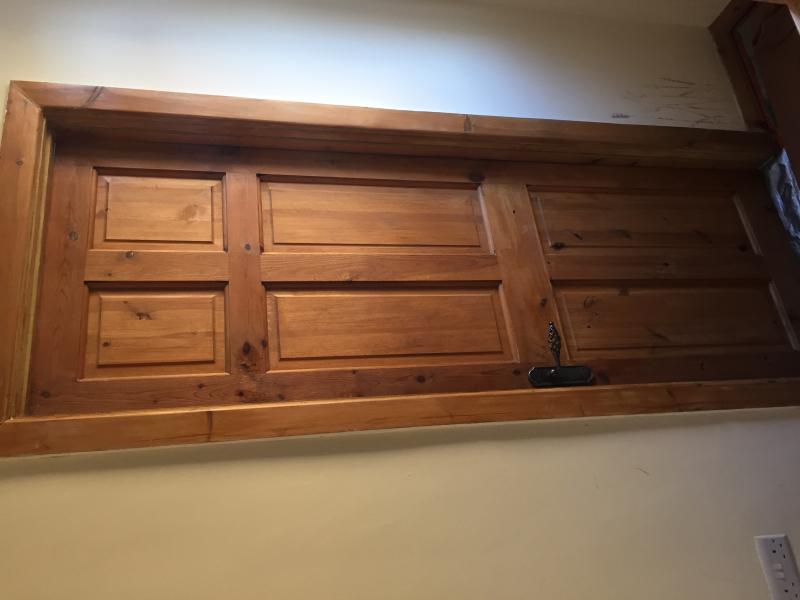

Hi, I have a couple of new unfinished 6-panel knotty pine doors from B&Q which I need to match to the existing ones. I've uploaded a picture below of one of the finished ones. Can someone advise what might have been used in these? I don't want to waste a load of money trying random things, it just needs to be close enough! Thanks in advance, sidx
That could be a sadolin stain of some shade.
Some test pieces is what you want to try on first.
Looks like a medium oak , but photo's can be deceptive, try wood dye on scrap of timber.Alternative shades are 'Georgian oak', 'light oak' maybe even 'antique pine'.
