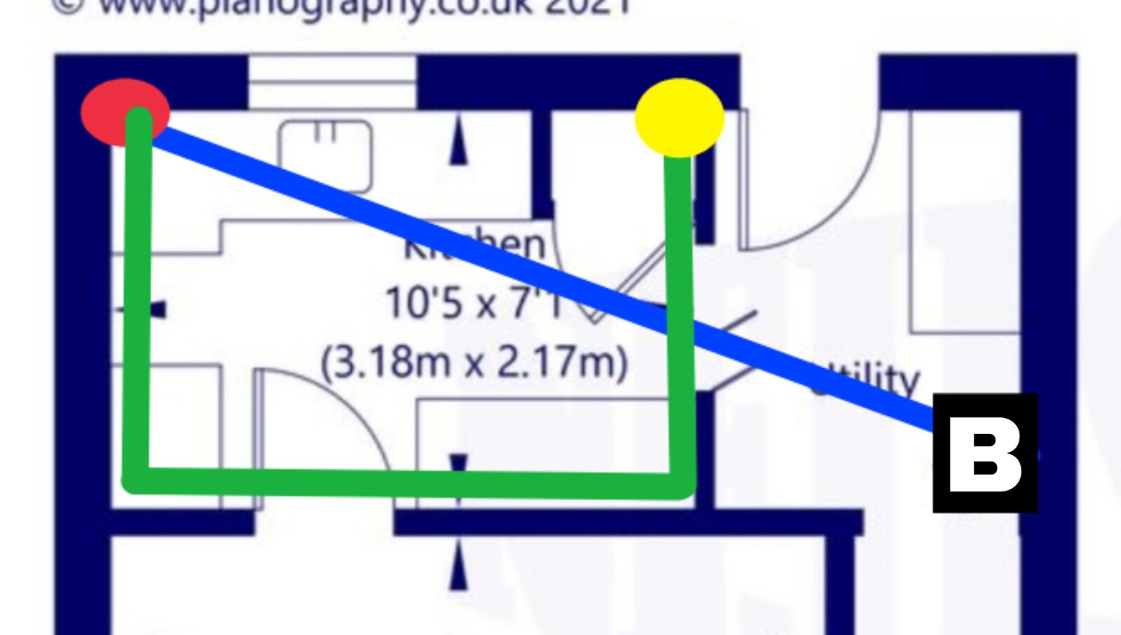

Hi folks,
Whilst recently in the crawl space. I've figured out why the hot water takes so long to reach the bathroom upstairs (directly above the combi). The pipes go under the utility room, across the floor (blue) and up the wall in the corner (water stop valve marked with red), around the kitchen ceiling, boxed up (green) and finally up to the bathroom (yellow circle).
Would it be easy enough to redirect, so it can come straight up from the crawl space (blue) up through the cupboard (yellow)? I've attached an image that hopefully helps.
AS long as you have the access then no reason not to, though I would suggest there may be a reason why it's run the way it is but of course that could always be legacy from an old system.
