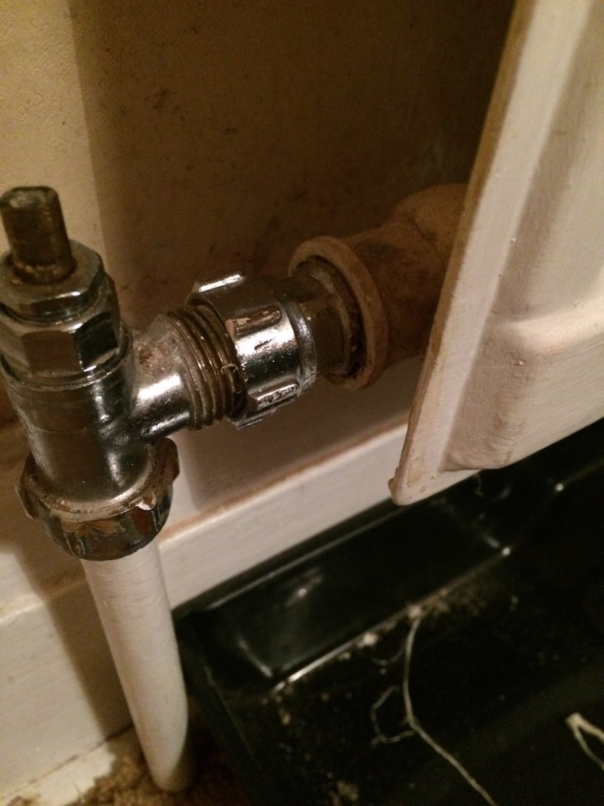

Pipe wont budge from Union nut
14 Feb 2015
132
London
taking a rad off the wall for decorating.
The union nut is undone (just spins and can see the PTE tape) but the pipe won’t move away. Any ideas?
Seriously? A fair tug does nothing
I’ve undone the other side, maybe less water will help...
Get a screwdriver. Insert between the slight gap in the 2 faces. Tap sharply.
I’ve done that (accompanied by sharp intake of breath) and it worked - cheers
Tape was acting like glue
Glad to hear it :).
I probably should not have used the word "sharply". But the experienced have a feel for it.
