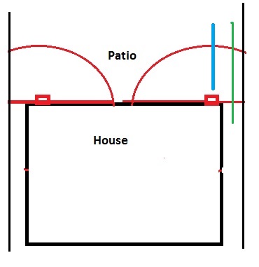

Covering just the entry points is as effective as covering the whole area. PIRs are far less sensitive to a person walking directly towards them ( blue line ) than they are to a person walking past them ( green line )
My suggestion would be a pair of 180 degree PIRs on the corners of the house.
As far as I am aware there isn't a PIR that has both the ability to directly switch mains ( for the lights ) and also has the anti tamper features that an alarm system would need. ( at least not one that is cost effective for the domestic market ).
So either use alarm type PIRs to an alarm system and the system provides a contact closure to operate a contactor to switch the mains to the lamps. Or mains switching PIRs ( with no tamper detection ) that switch the mains to both the lights and a mains operated relay. (230 volt coil ). A contact on the relay then informs the alarm system that the PIRs have activated.

I would fit two Steinel IS 180 sensors wired in parallel to control the lamps. They do not have tamper detect features but would detect the person before they got close enough to tamper.
There are various ways to notify the alarm system when the lamps are lit. The method would depend on the input circuit of the alarm you choose.
