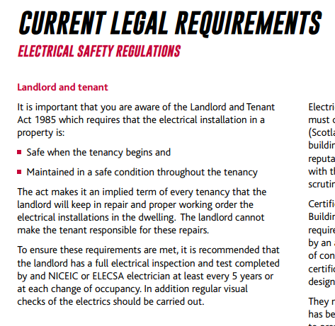

Doggit - I wasn't being critical of you (if that's what you thought).
I was trying to get EFLI to see the inconsistencies in claiming that an electrical trade organisation has no authority to give advice whilst approving of a private individual doing the same, and in conflating the giving of advice with the issuing of instructions.
It does say "it is recommended" but it is, along with the rest of the document, in my opinion, formatted to look like all are legal reqirements.
That is the heading.
It does not say "NICEIC recommend" and you know full well that NICEIC frequently acts outside its remit as a trade organisation.
Yes, the heading says "legal requirements".
Does it then go on to say anything false, or misleading, about legal requirements?
If it's on a NICEIC website surely it must be something which NICEIC are recommending? Unless they are representing that "CURRENT LEGAL REQUIREMENTS" text as being independent, third-party etc.
Are they?
They certainly do, but not in this case, surely?
You may argue about what they advise, but surely not about the basic principle of them giving advice to their members?
