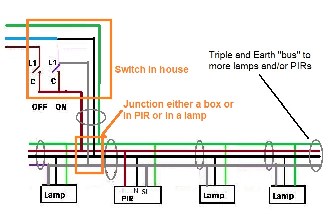

... You DO need a 'permanent live' to the PIR (to connect to the 'input' of the PIR). In this context, "permanent live" means that, when the PIR is being used, that remains live all the time, even when the PIR has not switched the lights on (the lights are fed from the 'switched live', aka 'output', of the PIR)....

The full circuit is here. An improvement would be be to use a double pole switch ( Live and Neutral ) for the OFF switch, This would enable full isolation of lights if (when) needed due to a faulty or waterlogged lamp causing the RCD to trip.
