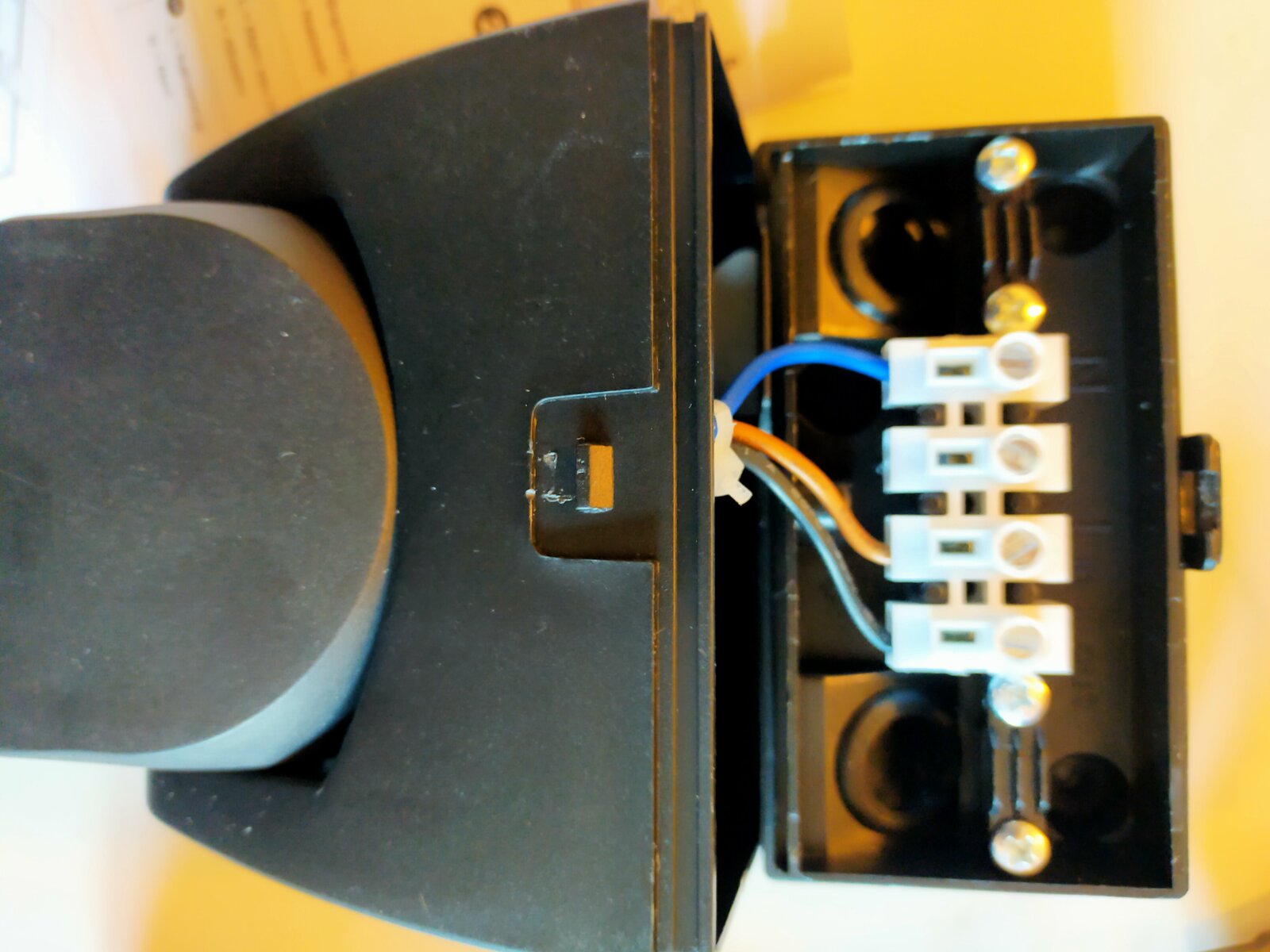

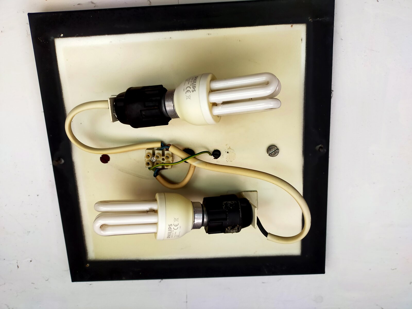

Can d someone help please how do I connect this pir to my outside light I've attached pics any help really appreciated.
Am I right in thinking I just take the brown wire in the light to the"live in" on the pir and then a wire from " live out" to the light?
Yes, but you will need to connect the neutrals and earths as well - 3 core and earth cable.
What are the locations? Could you interrupt the light supply cable anywhere?
