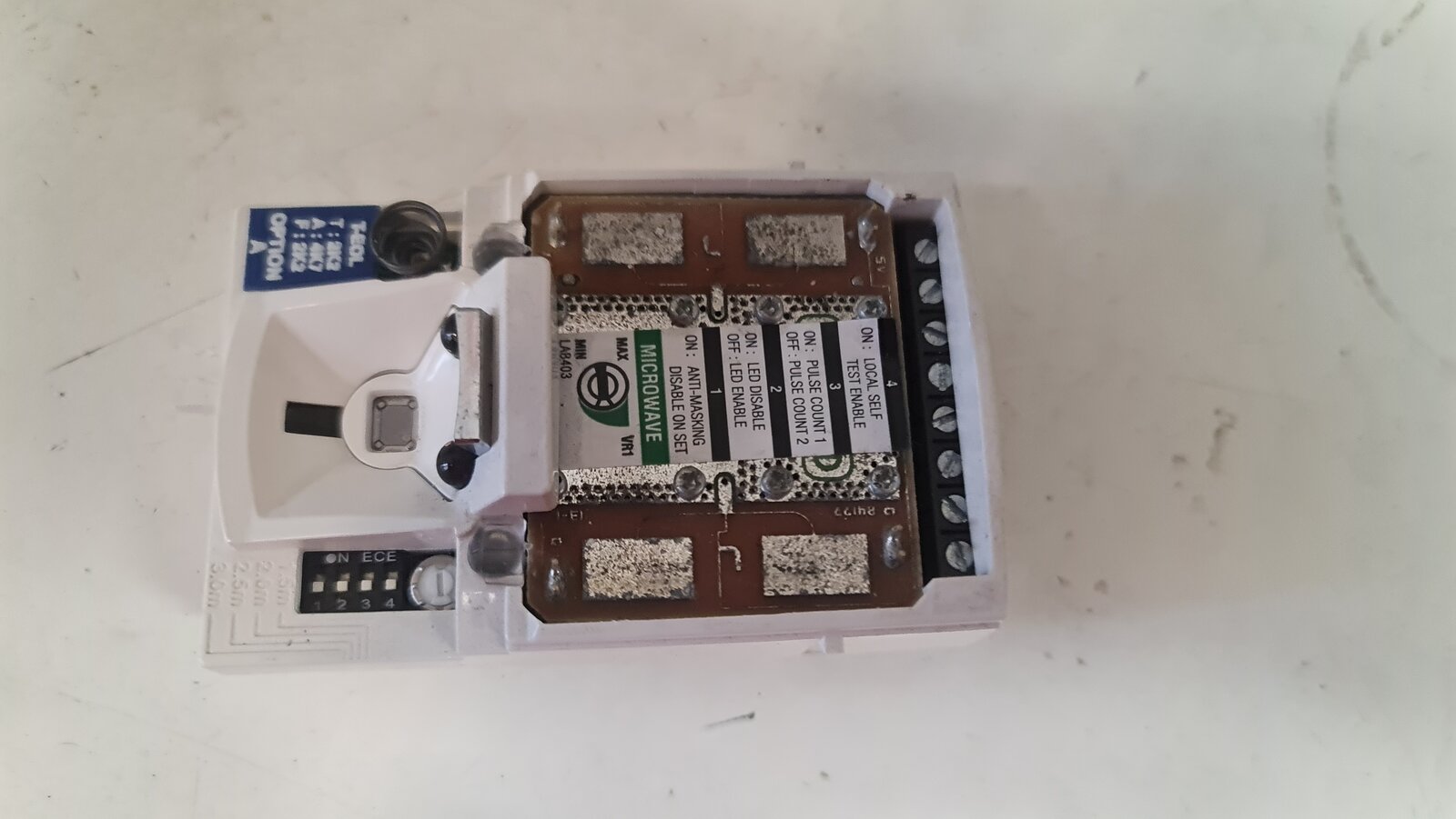

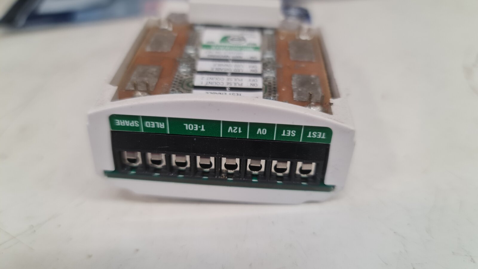

Yes - looks like another one....i have looked through the other threads and cant see mine....this was left behind by the installer...im presuming the usual + - and the two tamper wires...but this pir isnt marked out with the latter wires labelled??
Pics from my phone...

It’s a grade 3 pir and would normally come with various plug in resistors ( see bottom left ) blue module with values on it , wired via the triple EOL terminals

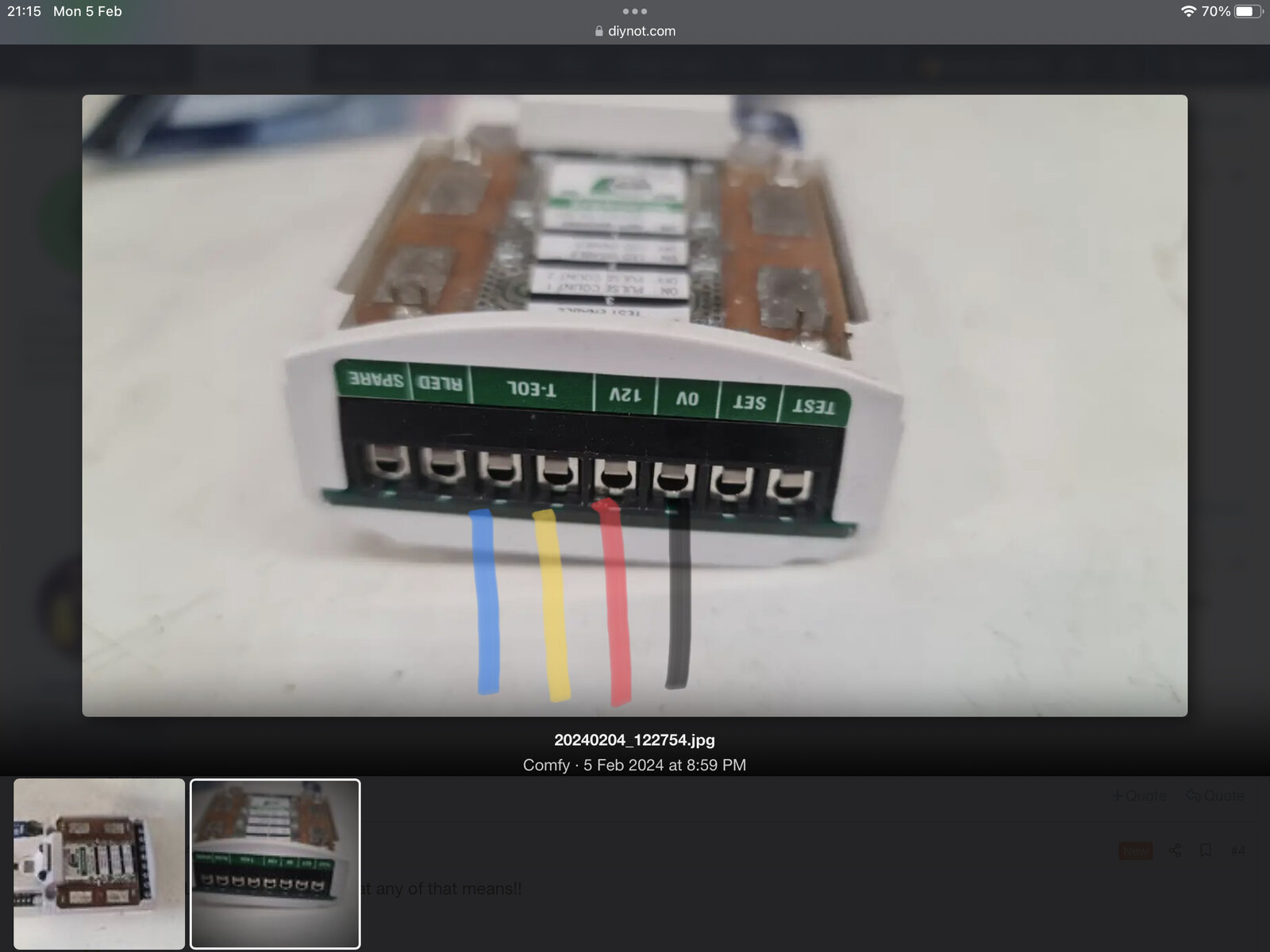

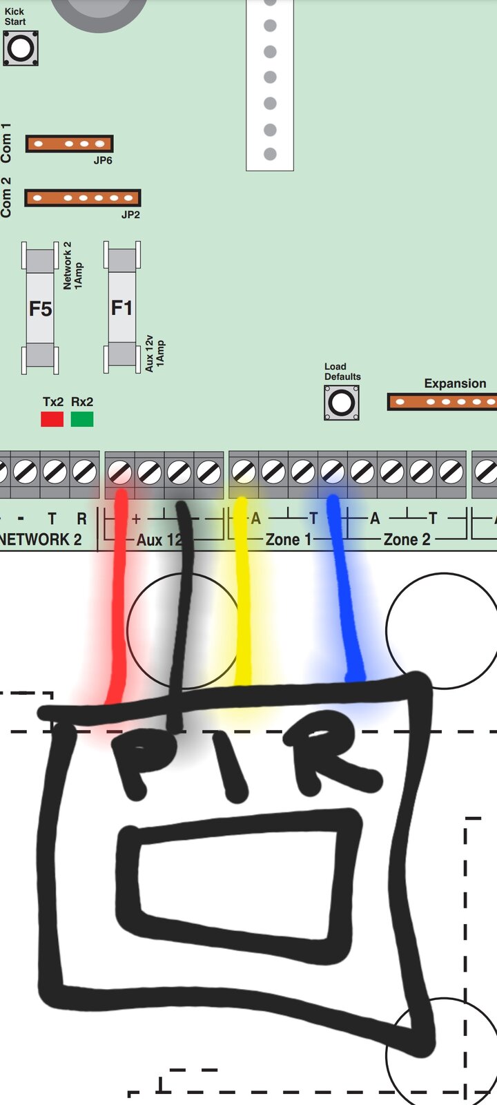

Wire the blue and yellow to the outer terminals on your texecom premier eg ….zone 1 first terminal …miss one , miss one , last terminal …
Righty....i understand that....i think the main panel is full (ill have to double check) but theres loads of zones on the expander next to it...so i find a zone on the expander and then wire those 4 into a "zone" - where do theresistors come into it?

Been tracing the wiring in the garage tonight ive done the above and wired the pir end as the above pic....so im planning on wiring this into the expander - im just looking at what i think are the PIR's that are alread attached to the main premiere....so the zone (for example for the kitchen) has the wiring yellow, blue, white, green (in the zone wiring area) and im guessing the red and black go off to the other end for power....the above pic shows only 4 wires....is this because its a different type of PIR?
The dualtech you have can only be wired as EOL(2wire) and has built in resistors. Most pirs will have 2 alarm terminals and 2 tamper terminals. These can be wired EOL using resistors or double pole (4 wire) with 2 unsupervised loops, 1 for alarm contact and 1 for tamper. Aswell as your + and - obviously
Thanks for the reply, ok - i dont understand all of that, so, i take red and black wires to the "output" on the expander [ thats the power out, i think ] take the tamper wires to the zone, and am i right in thinking that i put a loop in there as well? [ in two outputs in the zone ]?

Red and black to + and -, blue and yellow to the 2x TEOL terminals
