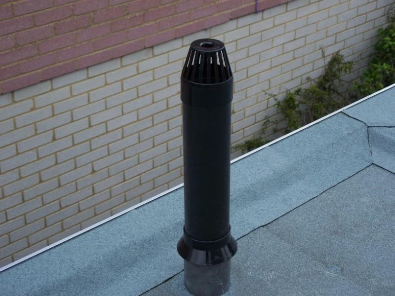

Hold up :!: the soil pipe with the lead slate round it - has it got a rain sleeve solvent welded @ the top of the lead :idea: I`ve seen many with water getting in there
Can anyone help? How can I find where the water is coming in?
I only just saw this reply and I wonder if this is the key? Since last posting 2 months ago, I've got a roof ladder and have been up there with my hosepipe trying to figure out where the leak is. The problem is it can take up to 5 minutes of water before any leak shows itself so its difficult work.
Anyway the last time I did this was last weekend and pouring water around that soil pipe definiately caused water to leak under the channel where it shouldnt't (as previously posted).
I thought it was getting in on one side of the lead mat type thing so I tarred that up. Next day it rained, and as usual it was still leaking !
Are you saying that a common problem is at the top of this rectanglur lead section at the base of the soil stack? From memory it is just tucked under the tiles above so presumably that's good enough isn't it?
the top of the square of lead could have sagged under it`s own weight over the years and water running back :idea: . That looks like a standard size -off the shelf - slate . Where it`s situated I would have made a larger one and taken it into the valley - also it needs a weathering collar on the pipe over the lead - glued on after the slate is sorted . You would be surprised at the amount of water that can trickle down the side of the pipe under the lead "tube" ;)...... Look at a Screwfix product code 25918 or similar
I'll check the top of the lead for sagging at the weekend.
I did some searches but still not completely clear what the collar does. Is it to protect where the base of the stack meets the roof as in the attached pic (not from my house) ? But in my case, the lead sheath around the stack looks like its welded or otherwise stabily joined to the base lead tile.
Also I made a small mistake in my previous post - I tarred up a regular concrete tile very close to the lead slate not the slate itself which is open on both sides. Could water get in their as it runs down?
