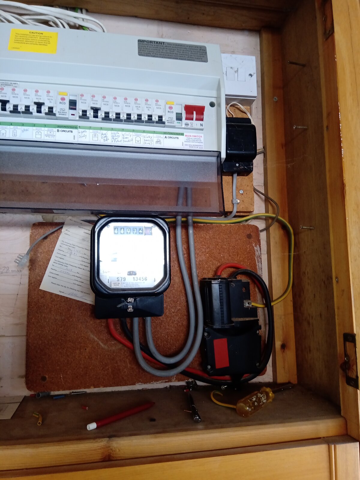

Just wondered if anyone knows anything about this. I had been told by someone for UK power that you cant have a meter repositioned under the stairs anymore. My Electrician hadn't heard about this rule, another one I know said its not true and someone else from UK power who I spoke to on the phone seemed to think it is sometimes possible.
Any ideas?

I'm not sure what the dno is. The electrician pointed at something the other week and said only UK per can move that bit. In now assume he was talking about the dno. It's a Shame because British gas want to upgrade the meter and apparently could move it a couple is metres for nothing,
The dno is going to cost over£1100.

That's correct - in your case, UK Power Networks is your "DNO" (Distribution Network Operator).

Just to be clear, what exactly is it that you want to be moved - literally just the meter, or also "the bit" (belonging to the DNO) which your electrician pointed at?

I've attached a picture of everything. I assume it's one of the black things that's only power UK can move?
