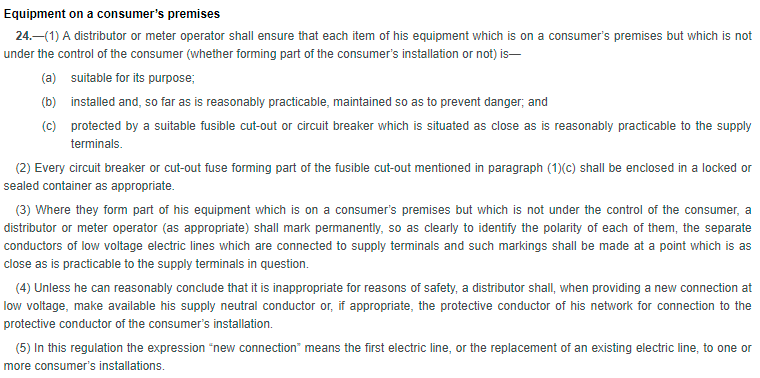

Doesn't ESQCR 2002 cover this?
If any legislation/regulations restricted the location of service heads/cutouts (or meters, which is also mentioned), one would certainly expect it to be ESQCR.
However, ESQCR (here) is surprisingly brief, and the entirety of what it has to say about "Equipment on a consumer's premises" is:
The only conceivably relevant bit there is 1(b) ("installed and, so far as is reasonably practicable, maintained so as to prevent danger") - but that is so vague as to be capable of almost any interpretation - so, essentially down to DNOs to decide.
Kind Regards, John
TBF, the BBB can be just as vague.
No argument about that :)
However, to interpret "installed and, so far as is reasonably practicable, maintained so as to prevent danger" as meaning "must not be installed under combustible stairs" (let alone "must not be installed in a 'confined space' ", which is apparently what the DNO told the OP), surely cannot be more than a (very!) 'personal opinion', can it ?
