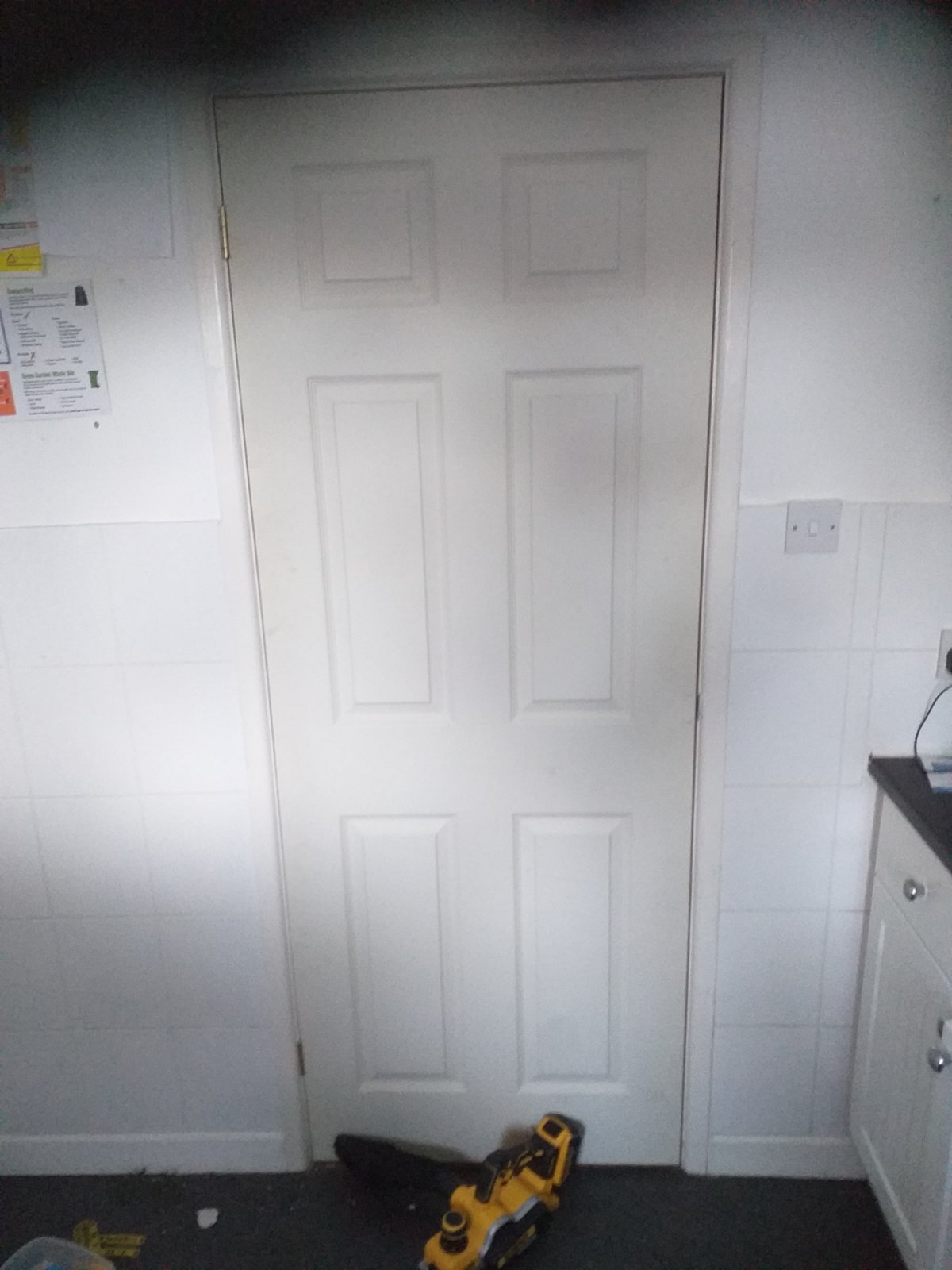

Just wondering if I need to drill lower for the lock? (Where I've put the arrow in the picture.) The old lock is higher in the lining. I know these old interior doors only have solid wood to drill onto in certain places.
I also noticed the gap on the lock side is 4 or 5mm but on the hinge side 1 or 2 mm. I planed a lot off the lower hinge side. Wonder if I did too much with my new toy

Cheap doors will have only one lock side indicated on the top of the door .Would fit lock centred between lower panels (arrowed).

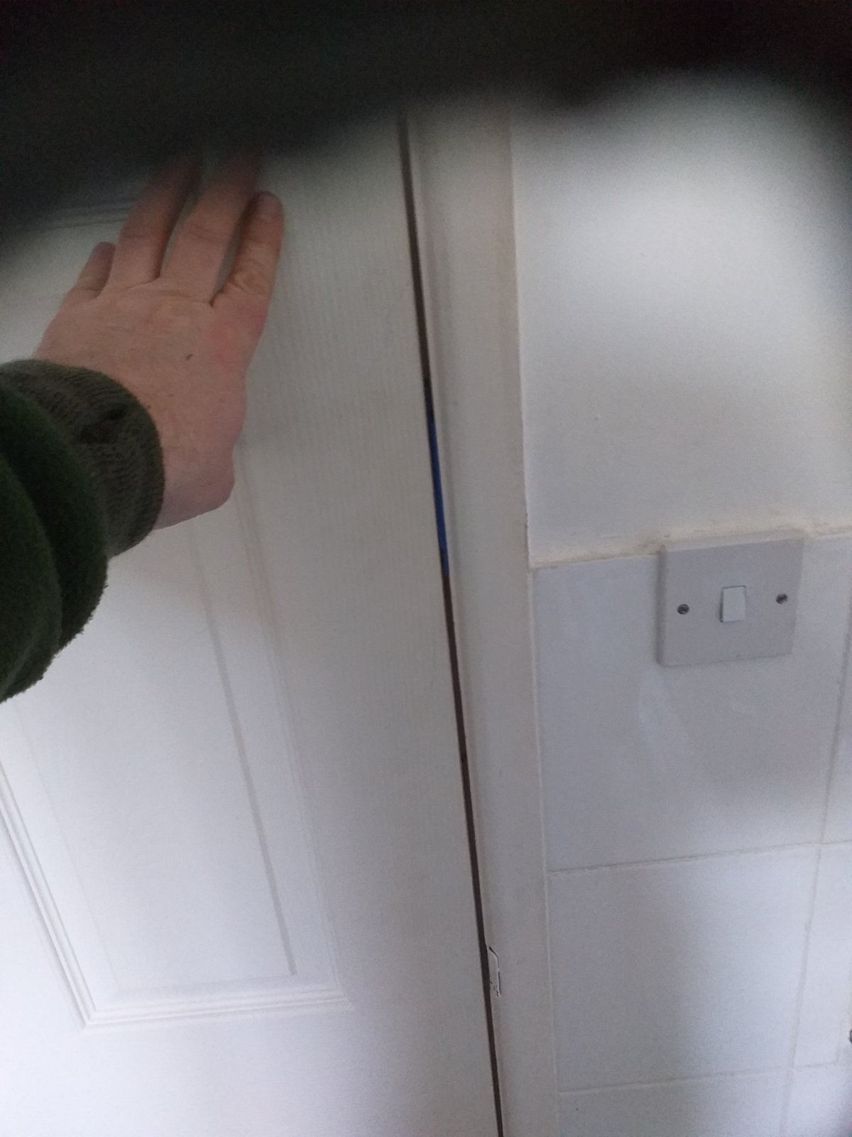

I've worked out its rubbing on the door stop; it just closes but it's putting pressure on the door itself. Shall I move the door stop back a couple of mm?
Yes. Far easier than adjusting the hinges. Before painting I aim for a gap of 1.5 to 2mm between the stop lath and the face of the door to avoid binding
