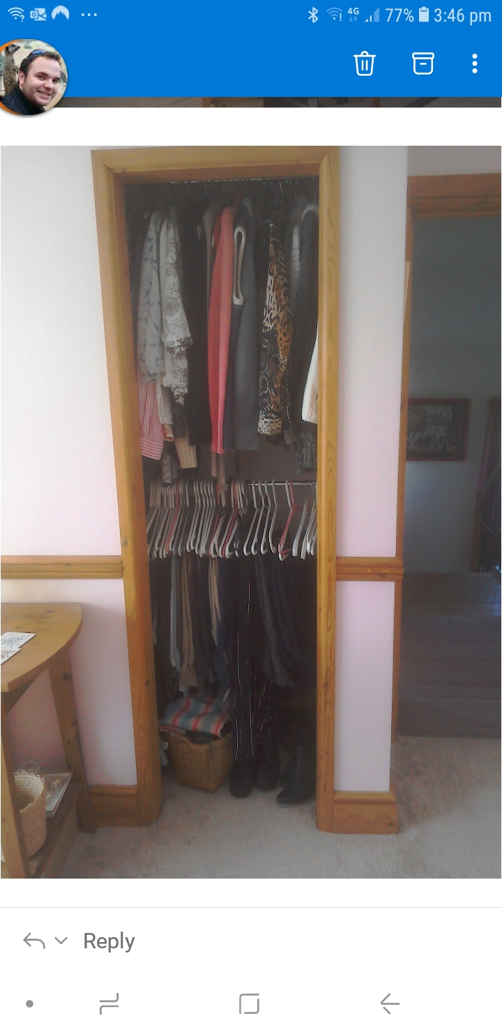

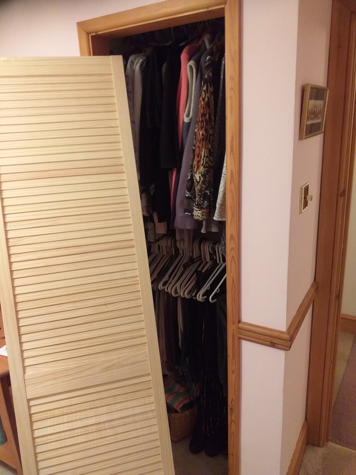

What hinges would be good for two of these wardrobe doors? Are they easy enough to hang? Should I put a magnetic door stop on them. I need to take about an inch off the length do I guess circular saw half inch off top and bottom.
Lourve doors are very light so a pair of butt hinges will work nicely
You will need to fit a door stop all around
How you keep the door closed is totally up to you (and how you open it too)
Some lourve doors are not suitable for trimming however

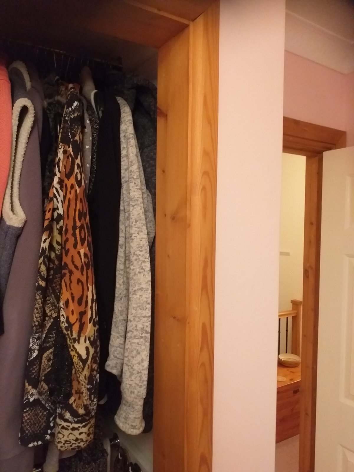

I was going to use one magnetic stop in the middle, is that not enough? Do you think baton on both sides of lining and top as a door stop?
I was thinking flush hinges as it would save cutting into the nice door lining
I think it looks better with a door stop all around , but you're right it would ruin that nice door lining
Flush hinges will be fine don't forget to bevel your edges to stop the door binding
Have fun!
What does the instructions say about trimming? Otherwise you can take more off the bottom rather than the top. With lourve doors whilst light they do have a tendency to move - use three hinges as a minimum.

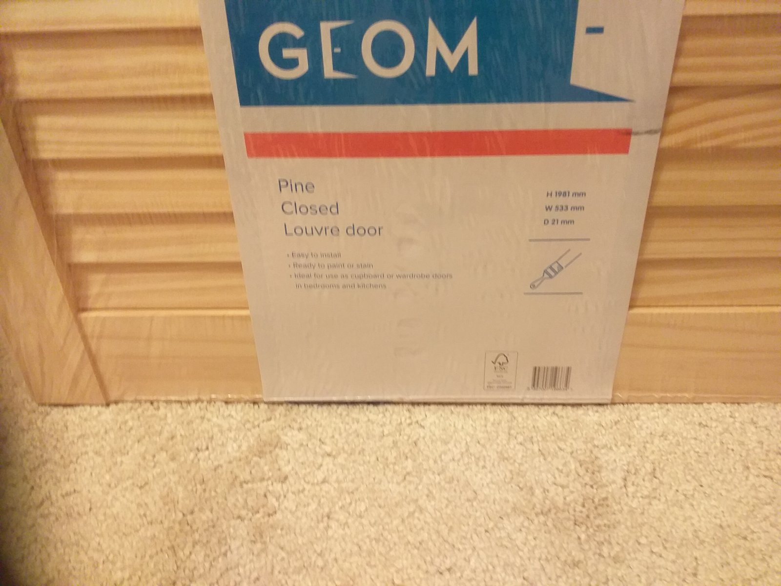

Cant find any info on the trimming. I need to take an inch so I guess just do it. Think I read about Louvre doors generally you can take 20mm.

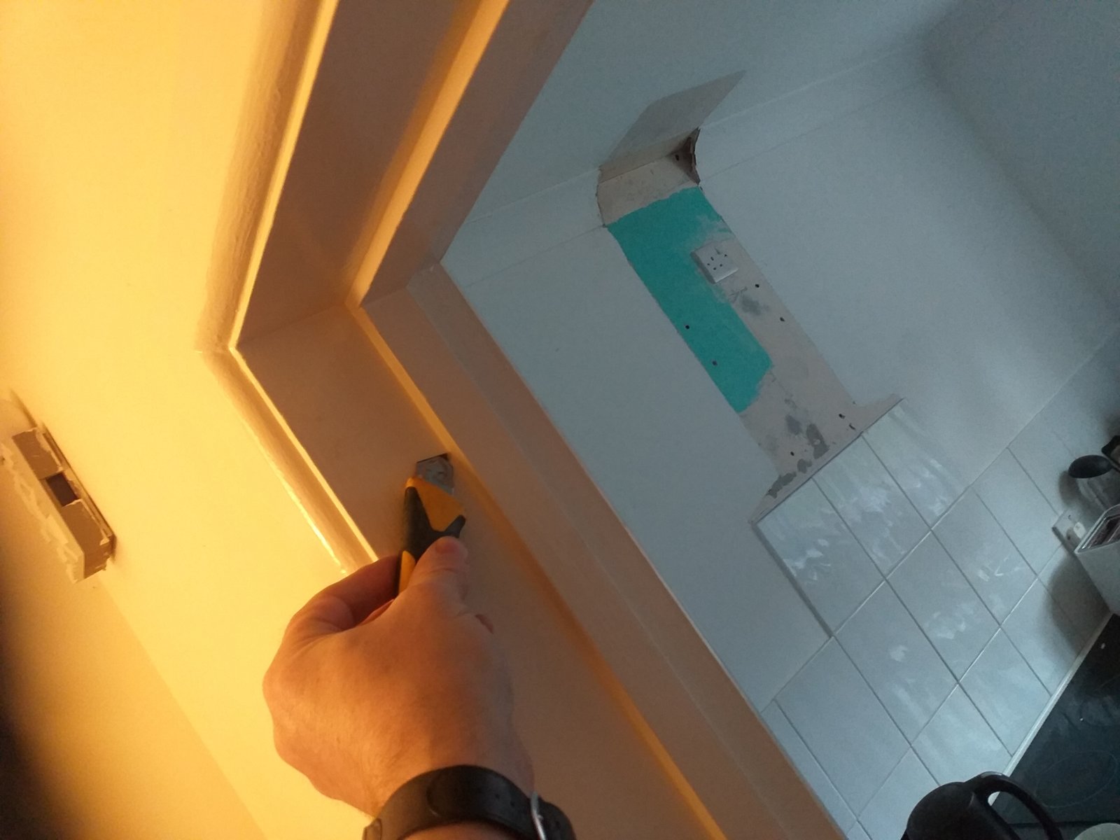

I scored the door stop with a Stanley because there was so much paint then hammered in a scraper and prized the stop out and moved back 2mm. Looks a bit of a state though. I guess sand then paint
Should use a wood chisel to remove, door stops are disposable items , cheap to replace.
