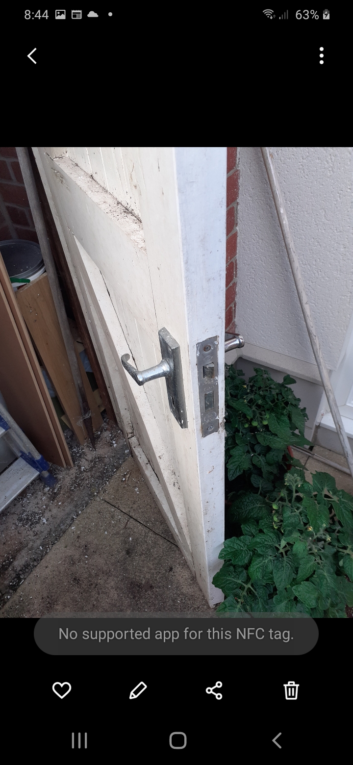

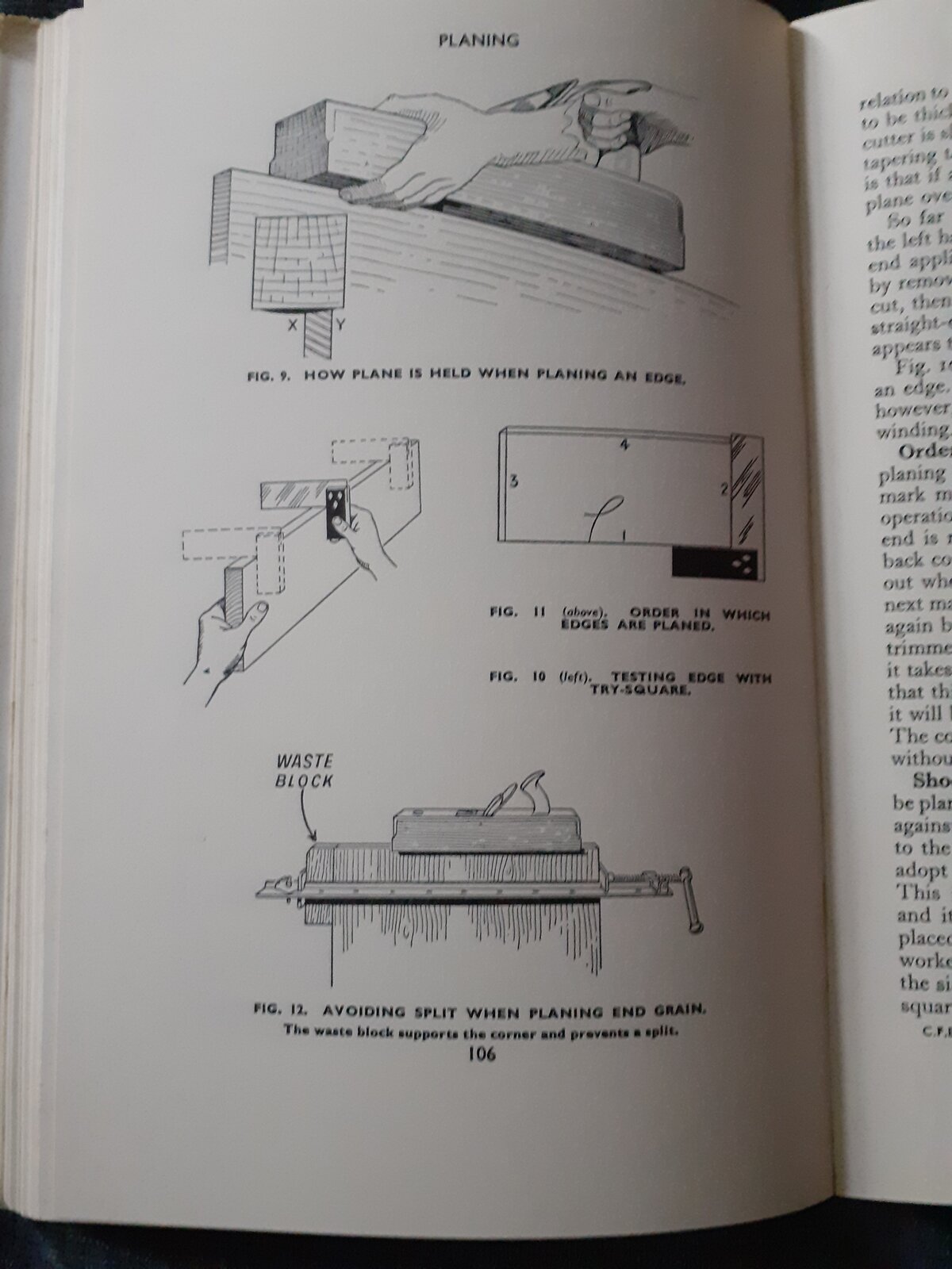

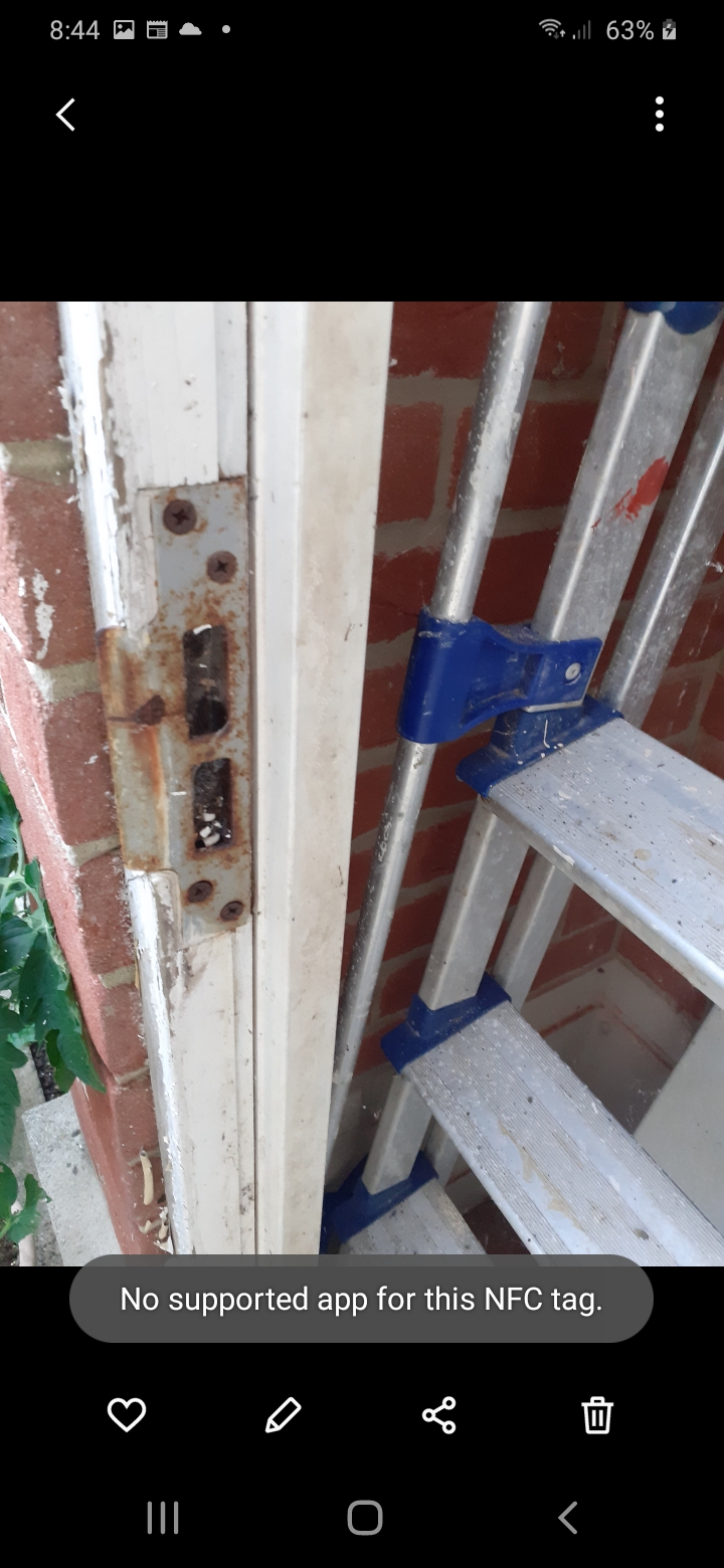

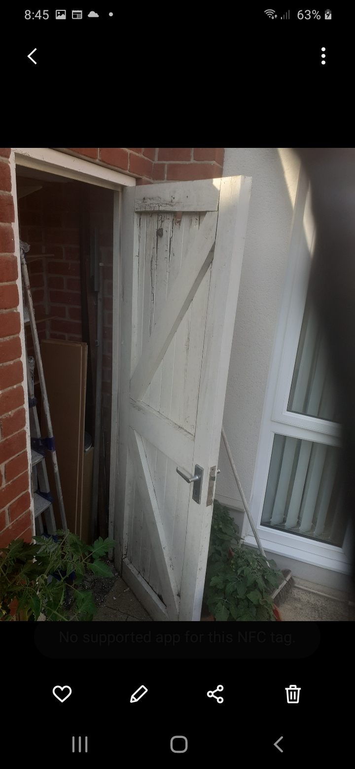

Got a heavy external door to hang for outside cupboard. Three sturdy looking hinges. Not a fire door.
Same as internal door?
I'm thinking of marking hinges with top of door pushed right up into the top as my internal doors always seem to drop. I'll then plane top.
Mark lock with marking gauge set with two pins . When planing the top over edge , if you plane at an angle (plane at 45 degree) will that stop it breaking out?
I presume that you mean you are getting break-out at the end of the planing stroke on the stile when planing a traditional (rail and stile construction) door? In that case don't chamfer the top corners of the door - that's a 100% real bodge merchant's approach!
At the bottom of this page is one technique:
Note the need to constantly check and recheck that you are planing square to the face of the door by using an accurate try square.
BTW, don't try that technique for holding a plane at the top of the page when using a power planer - it is strictly for hand planes only. A power planer requires a side fence to be fitted, ideally with a piece of plywood screwed onto it to increase the area of the fence plate. The enlarged fence plate also makes it easier to edge plane doors when they are supported horizontally on a pair of trestles. If the door is pre-finished it may be necessary to protect the face (where the fence runs) with a run of low-tack (green/blue) masking tape
An alternative technique is to plane into the middle from both edges, in which case the long cramp and break-out block aren't required

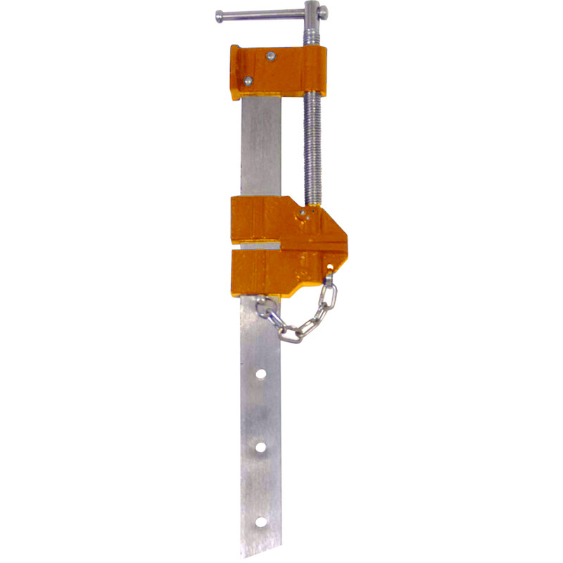

Thxs. What's the name of that massive clamp?

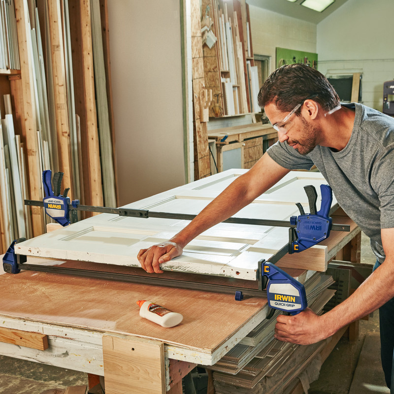

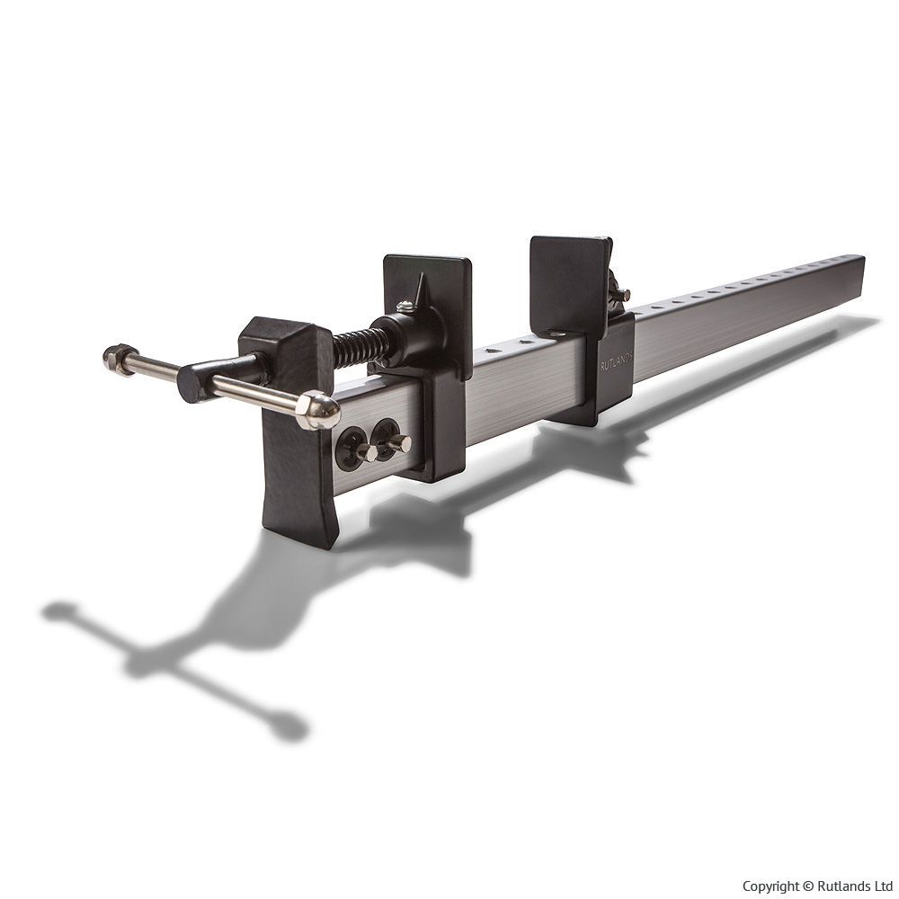

That's a sash cramp - a large enough QR- or F-cramp (900mm) would do as well or a pair of cramp heads and a piece of softwood. I have sash cramps in various sizes, a few 900mm Irwin heavy-duty QR cramps , various F-cramps and some sash cramp heads for this sort of thing, plus assembling door casings, repairing stuff, etc - but I have no particular preferences so far as this job goes. If I had no cramps with me I'd resort to planing in from both edges, although that takes a little more care
Above: Toolstation Expert sash cramp
Below: Low cost aluminium sash cramp
Above: Irwin heavy duty QR (quick release) clamps, 900mm long, being used to assemble/repair (?) a door

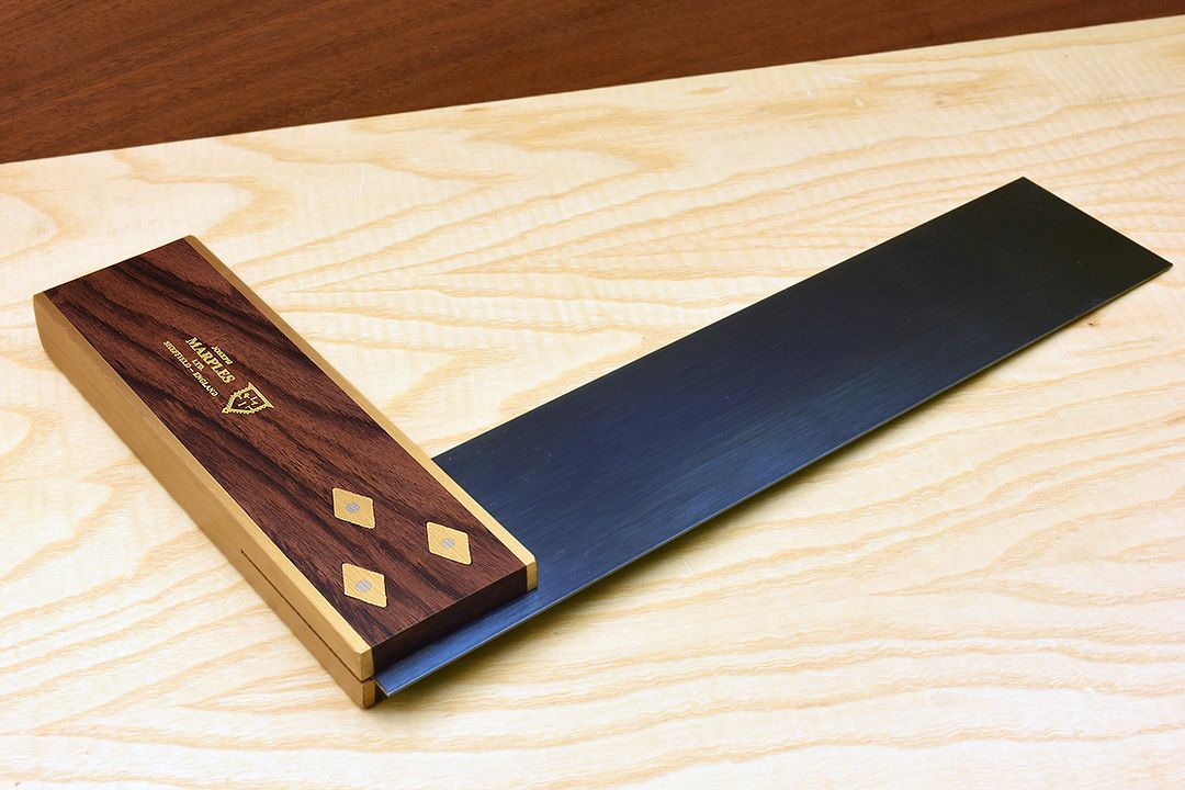

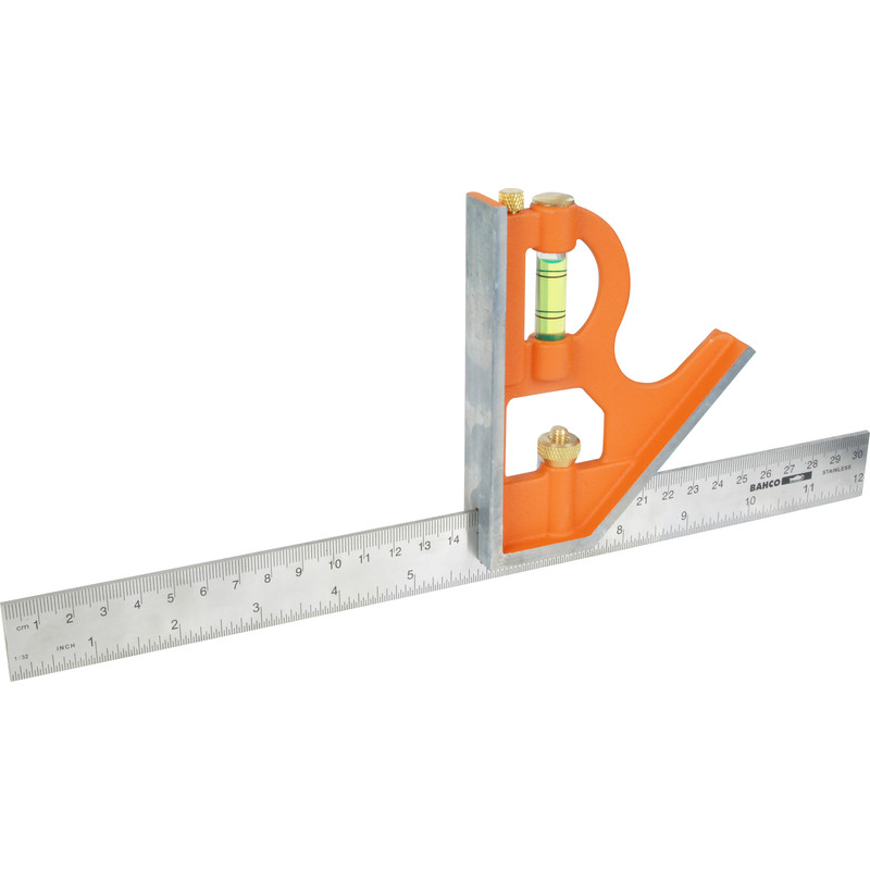

I guess set square is a good as try square
This is a set square:
It is used for drawing, but is absolutely NBG for checking for squareness in woodwork, especially in the middle of an edge (i.e. the middle of the door - see drawing above for how to check squareness in an edge), or for that matter marking out hinge recesses. For checking squareness joiners use a try square:
or a combination square:
The combi is generally the most useful of the two on installation as it can be used for checking square, setting out (square and mitre), marking parallels, measuring depths, etc (but unlike my apprentice it can't make a decent cup of tea - thinking about it neither can he!). The combi is also the ideal tool for setting out hinge recesses accurately, IMHO only bettered by a butt marking gauge, which in comparison is a bit of a one trick pony. As with any square check that it is actually square before using it for the first time and periodically afterwards (they can go out of whack if dropped)

What book is that?
I've recently been reading some modern C&G guides that the trainees use for various trades, which do have some interesting info for anyone from other trades.
So I wanted to get hold of an old skool carpentry book that may have been used back in the day just to compare.
It's from one of Charles Hayward's books called "Carpentry for Beginners" which were published by Evans (in the UK) and Sterling (USA) until the 1990s. Lost Arts Press in the USA has recently republished some of his stuff, too. Nice, but pricey.
