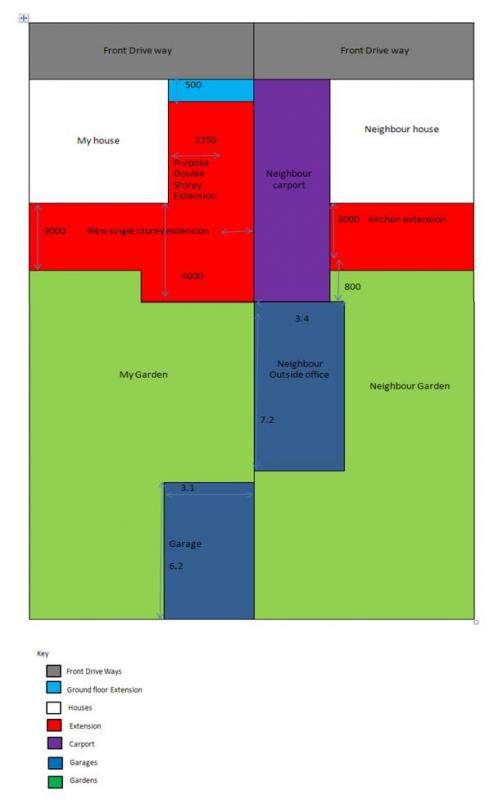

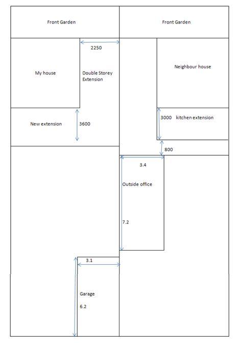

Do you think I should leave the rear extension on 3.6 depth or should I reduce it to 3 meter which the planner told me to reduce it. He stated on refusal that the proposed development by reason of the excessive depth of the single storey rear extension would adversely affect the residential amenities of number 152 the proposed development and overbearing when viewed from that neighbouring property and would result in loss of light to that property. As such the proposal is contrary to policies 4.1,5.5& 5.9
Even though on the side where the double storey extension I am going be building on my left side. Neighbour got an extension of 3 meter depth by the width of the property, and right after that extension he got another outbuilding office extension along the boundary line the size is 7.2 X 4.2 between the two extension is just a walk way of 800mm
So another word more than 10 meter covered with extension on my left side of the house along the boundary. The planner said i can build 4 meter in depth on left hand side where the 10 meter cover by the neighbour extension but 3 meter depth on the other side. So it going to be like a L shape, because on the other side neighbour has no extension. i draw a sketch of the my house and the side house i am going to build the extension. for you give you a better picture of site
thank you
It's hard to say exactly what you'll get approved - or allowed on appeal. All I can say is I have secured planning permission for half a dozen extensions more or less exactly the same as yours in the last 2 years. All were tight to the side boundary (or directly on the boundary) but all had to be set back from the front.

Do you think I should leave the rear extension on 3.6 depth as original planning or should I reduce it to 3 meter on right side and 4 meter on the left side which the planner told me to reduce it. So the ground floor extension going to be L shape.
Even though on the side where the double storey extension I am going to be building on my left side. My Neighbour got 2 extensions. 1) extension of 3 meter depth by the width of the property, and right after that extension he got another outbuilding office extension along the boundary line the size is 7.2 X 4.2 between the two extension is just a walking way of 800mm.
So another word my neighbour covered more than 10 meter with extension on my left side of the house along the boundary wall. The planner said i can build 4 meter in depth on left hand side where more than 10 meter cover by the neighbour extension but 3 meter depth on the other side. So it going to be like an L shape on the ground floor, because on the right side neighbour has no extension. I am going to draw another colour plan to give you a better picture about my and my left side neighbour extension in Red and the outbuilding in Blue colour. but the original plan was 3.6 depth and i like the depth of 3.6 or 4 meter depth straight not the L shape. what do you think.
Thank you for your help
