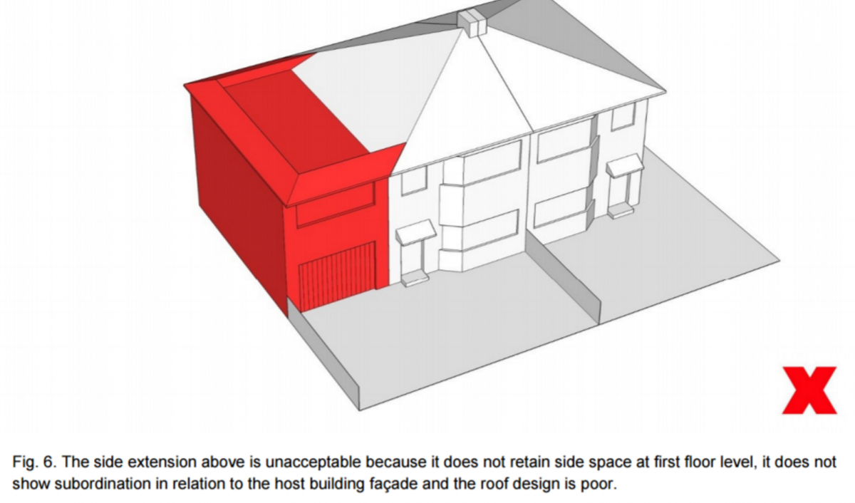

Being surprised at the case officer's feedback, I did some search work myself, and found an example from the council's local planning guidance (as attached), which I thought can be clearly applied to refusing our application. Therefore I asked the designer again, and he said that the planning guidance is for guide purpose only. He had many cases that didn't fully meet the requirements from the Lambeth guidance but still succeeded in the application. He insisted that it's because the planning officer being difficult to us and unwilling to negotiate.
Now our application has been officially refused. From the portal, one of the two main reasons is: "The proposed side and rear extensions, by virtue of their design, size, scale, siting and wrap-around nature at ground floor level, would fail to archive subordination with the host building." We were planning to finish the project by the end of the year, which is no longer possible. The designer suggested us to proceed with appeal, and they have a third party inspector experienced in appealing who charges 1,500 pounds upfront. At the same time we can submit another application to Lambeth with a modified design, which can be proceeded at the same time to save time.

- Do we have to strictly follow council's local guidance? In this particular example, whether the 1m minimum side space on the first floor still applicable for our end of terrace house facing an unused playground?

You have been given terrible advice and poor service.
First and foremost, all extensions should be designed in full accordance with the council's planning policy and any published supplementary guidance.
Invariably, this requires an extension to be subservient to the main house - ie smaller, set back at the front and with a lower ridge. Roofs tend to need to match too.
Some council's have a policy requiring a gap to any side boundary too.
No application should be made that does not accord with the policies, unless there is significant reason to deviate. A standard side extension on a standard house won't have any good reason to deviate.

An appeal tends to be on the council's interpretation of their planning policy, and not just that you don't agree with the decision.
If your proposal does not conform to the planning policy, and there is no merit in the design or non conformity, then the inspectorate can't allow the appeal.
So you need to be clear on what basis you have for the appeal - ie how are the council wrong not to grant permission.
