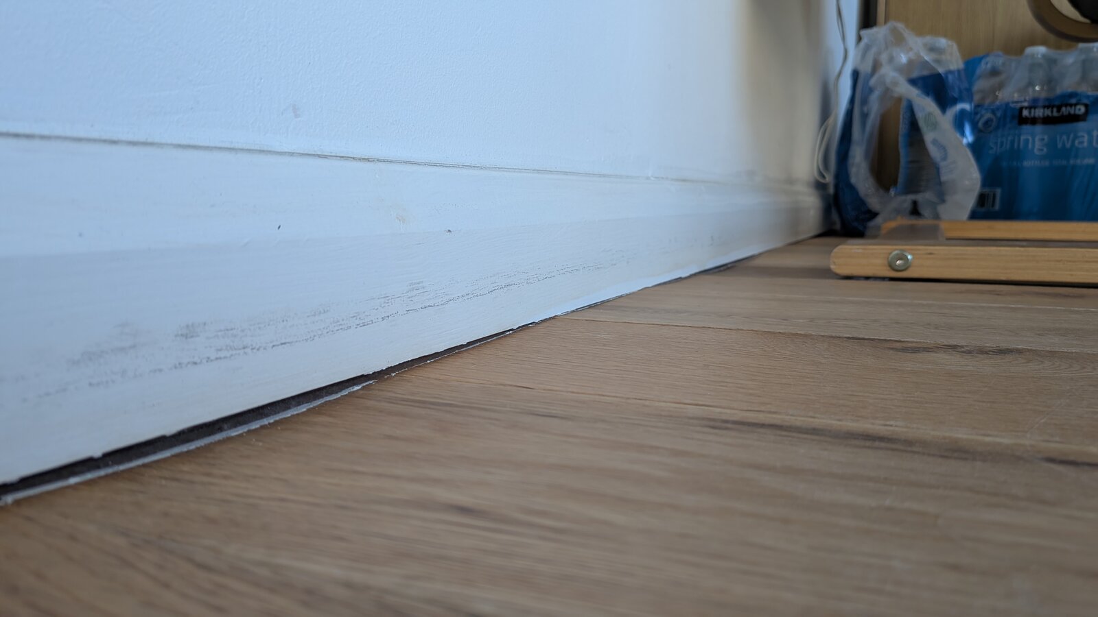

Had hardwood floor laid when extension was built in 2023 and planks started to form deform/warp in 6 months or so. So decided to get rid of it, remove the glue and lay tiles instead (dont want to risk with wood again).
Any advice on glue removal ? Tools ? Chemicals ? Or how much could be for someone with proper tools to remove it ?

Unlikely to be an issue with the wood flooring, almost certainly an issue with the floor prep and/or moisture issues if the subfloor was not correctly dries out before the flooring issue.
Was the wood flooring floated on an underlay or fully bonded to the subfloor? Is the subfloor wood or Concrete?
The floor will come up with a pryer. You'll likely need to remove and re-use or replace the skirtings.

Glue applied to the concrete and then planks on top. Removing floor wont be a problem.
Was told glue will have to come off for tiles to be installed, thats my concern and looking for solution to be ready for spring ;)

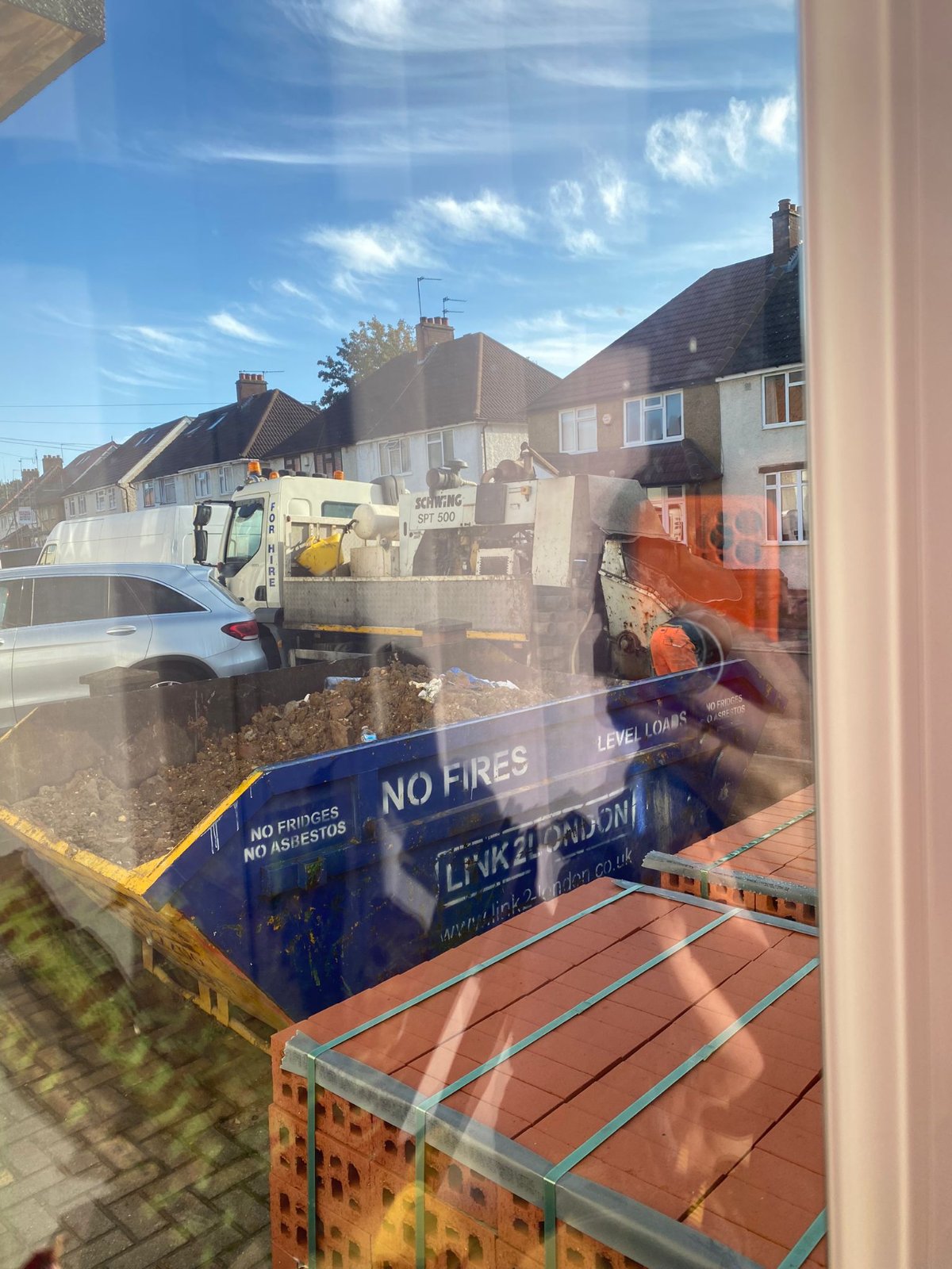

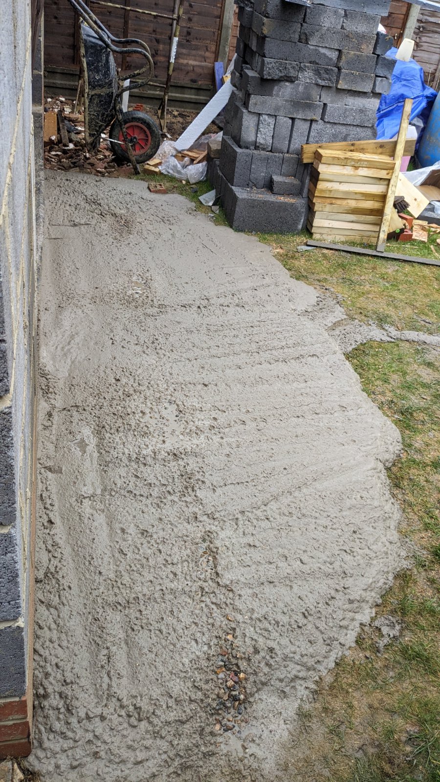

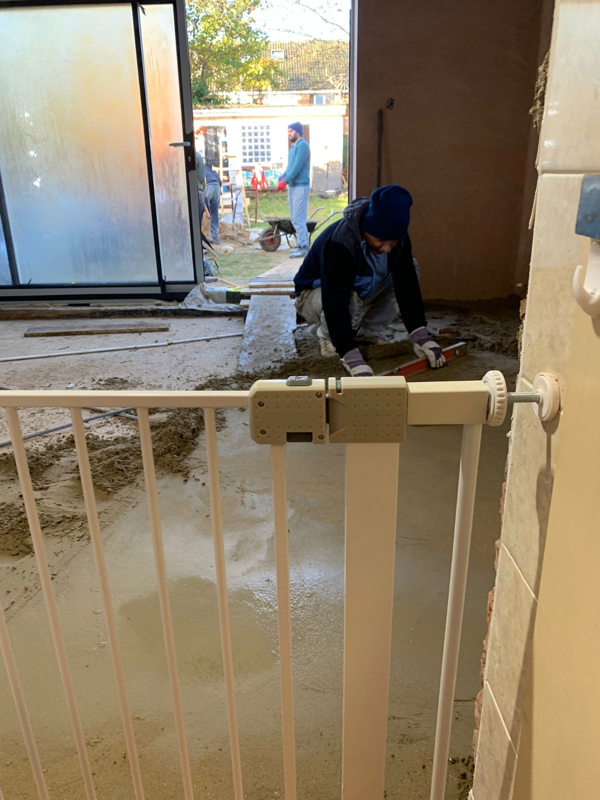

Found these photos. Dont know if it would be any help to determine the type of screed that was used ...
That just looks like normal sand cement screed to me. What was the time gap between screed an flooring?
Was poured in in mid november. Floor laid mid december ...
So sand cement screed, is it good or bad news. ;)
I would say the screed looks like S&C, good news.
What was pumped in then... presume it was the concrete under the screed?
