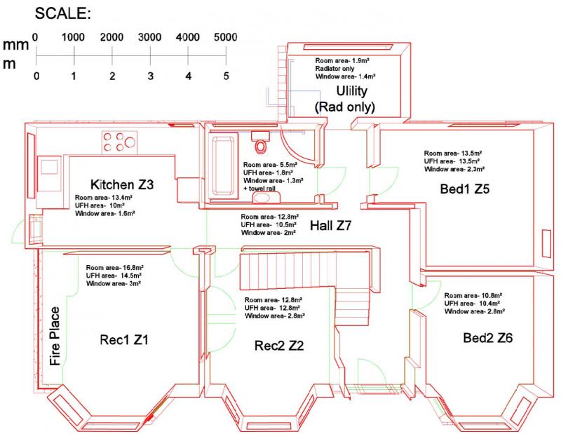

Hi guys,
Having finally had our sub floors laid we are in a position to start thinking about plumbing. Currently the only pipe work we have is a 15mm copper main through the kitchen wall (giving approx 22l/m), flow and return going to 1 rad in conservatory, pipe work for backboiler and all original pipework in the loft conversion and the old toilet soil pipes
Ive rang quite a few local plumbers but many are too busy (1-3month waits!), dont want a full house to do or dont know anything about thermal store systems :(.
So im thinking of having a go myself :twisted: and get someone to make connections where required and commission everything when done (found a guy busy with new builds for next few months but willing to call in to keep me right and test everything)
Its a bungalow with 2 rooms upstairs,
Water draws - me + other half, no kids for while
1 bath, 1 shower,1 hand basin,1 toilet, kitchen sink, wash machine.
Heating -
UFH throughout groundfloor, 6/7 zones
1 Rad in Conservatory
1 Rad in Utility room
1 Towel rail in bathroom
2 Rads upstairs
Heat sources -
Old oil boiler - will be changed for modern condensing down the line
Would like to utilise back boiler to make a contribution to CH when fire/stove is going
Add solar panel down the line
Given the above desires im looking at a system based around a thermal store to give flexibility and mains pressure DHW.
Planning on using Polypipe 22mm "pipe in pipe" under the insulation so there are no joins under the floor and problems should be easily rectified. Then use distribution manifolds to connect 15/22mm to outlets.
As for the existing copper id like to solder extensions and run them back to a manifold or striaght into the heating circuit if sensible.
Thermal store will be beside the bathoom with the shower being the shortest pipe run and kitchen being the farthest for DHW. Boiler will be about 1m from thermal store but in an exisitng outdoor boiler house. Im hoping by keeping the pipe runs short it should minimise losses and give good response.
So my basic plan of attack is:
Figure out what our main supply pipe is from the water meter, if MDPE trace exisiting copper and replace with MDPE, if not replace the whole thing and have it checked for compliance before filling in and connected by someone qualified.
Run 22mm for the hot/cold water to sensibly located manifolds in kitchen and bathroom
Figure out rad/back boiler circuit
Fit UFH Manifold
fit Insulation and UFH pipework
Fit Thermal store and check it all works before pouring the screed.
Does this sounds right?

Thanks for the reply and some good questions,
Bungalow is an old 1930's solid brick building (60m²) with a more modern cavity walled extension (40m²). We are fitting 100mm insualtion to the floors and 75mm interally to all external walls and fitting as much as feasible in the roofspace conversion, using 75-100mm kingspan board where we cant get decent depth of wool due to the conversion. All walls - floor junctions will have 25mm upstand insualtion to prevent bridging.
Going on the vastly upgraded insulation (currently 50mm wool in some parts of the loft only!), most people we have spoke to reckon it should be fine with underfloor provided ALL insualtion is done. Some have suggested we go with tighter UFH pipe spacings to ensure it will work at the expense of pipe/pumping but if not required we can offset the excessive pipe by running a lower flow temperature..
Solar tbh is just something im considering down the line, prefer to spec the option now and not use it rather than have to replace the tank later if it becomes more affordable / i find a cheap used panel. Friend has it on his new house and reckons for his family wife and 3 kids, his panels provide all his DHW between April and October he is ideally situated for solar so he gets maximum gains.
Pipe in pipe is purely for water/rad circuits, UFH will be 16mm Pex-Al-Pex ontop of the insualtion and covered in 50mm "ThermaFlo" screed.
Interestingly i came across a company that offer UFH using an insulated pipe in pipe design to allow radiator flow temps in the UFH circuit but not over heat the floor. Means you pump less water because it hotter (smaller bore pipes) and removes the need for blending valve and extra pump if mixing rads and UFH.
google Rotex system 70
We have approx 100m² on the ground floor, 80m² that can be used as heat surface planning 6-7 zones to fill this + rads on a seperate zone to give maximum control.
Thankfully were mostly on 1 floor with only 2 rads upstairs, that probably will we switched off most of the time (main bedroom is on ground floor).

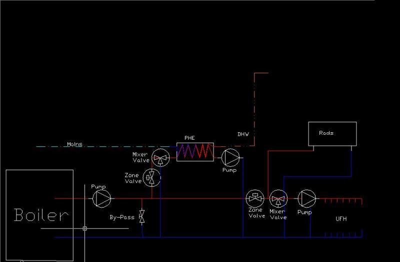

Was thinking last night
Given that a thermal store is more or less a heat bank for the boiler and other heat sources. With a heat exchanger to give DHW,
Is it possible to plumb a plate heat exchanger to the boiler flow and return directly to make what is essentially a DIY combi?
Probably a hugely inefficient use of the boiler but would it be ok for a few months? Would allow us put off the 1.5k for the tank till over the summer and use money now on better/more thorough insulation and get us in a few months early and save on rent.
Do you think this would pose any significant issues down the line when fitting a proper Thermal store?
This is my thinking
Probably a hugely inefficient use of the boiler ...
Don't see why not, it's more or less all a combi is anyway. It'll be no less efficient - or only a little if you have the boiler flow temp set at a reasonable value.
This is my thinking
As there would be no effective temperature control to the DHW a temperature controlled mixer would need to be used.
But those systems can bew prone to lime scaling in hard water areas.
Tony
Cheers Tony,
We are quite lucky in that we are in a soft water area so not expecting too much trouble :)
