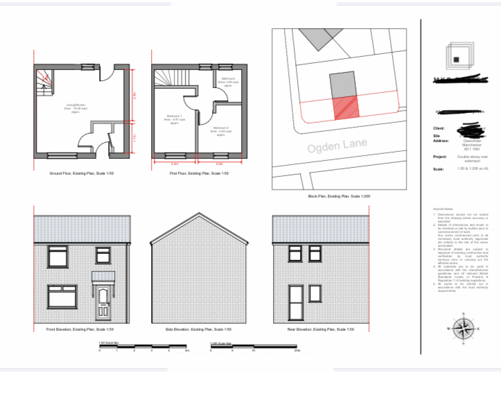

Hi all I’ve had some drawings made up for planning but been told to to apply for pre planning with the drawings to see what is achieved. I’ve been searching For pre planning but can’t seem to find any information.
It’s for a Double story extension what I’m 100% certain will be knocked back due to light issues. But was hoping they would give me some information what would be approved etc
I’m based in Manchester the drawings I’ve had made is the pre existing plan and the proposed plan
Any info would be very much appreciated

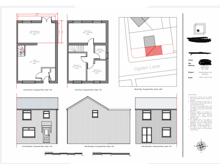

Basically a student architect family friend. Drew me some drawings And told me to go in for pre planning. Doing a bit of searching I couldn’t find anything on pre planning. He’s basically done a Me a favour as I have a feeling planning will be rejected. I was hoping they would give me an alternative.. here the drawings are they good enough to go for full planning

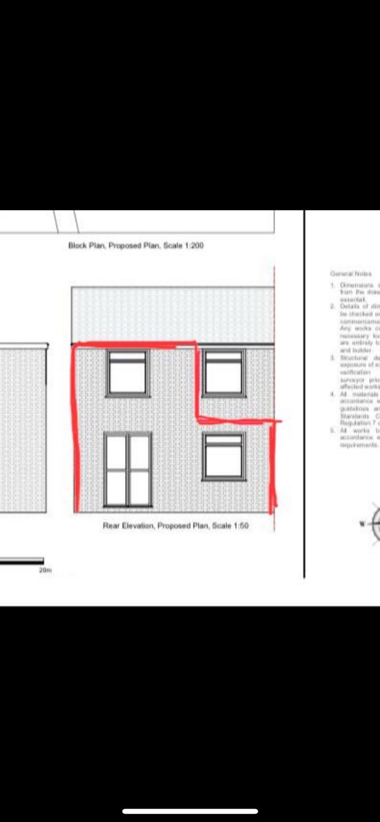

Double story extension I know it won’t be approved due to right to light but fort it was worth a try before I make the top half smaller

In my opinion, the drawings do need a few changes so it’s clearer as to what’s existing and what’s proposed. You’d only need to dimension (externally) the proposed extension. Dimensions should also be on the block plan. The existing and proposed block/site plans show the red hatching, which is why I think @tony1851 thought it may be a new build as did I. You’d only need to hatch the proposed extension.
The drawings shown a flat roof over the new extension, which the LPA may be against. As it’s on the rear, it’s not normally an issue but the roof would be seen as the property is a corner plot. Any reason why the architect couldn’t have a rear facing gable along with a parapet on the boundary line?
Also in relation to the flat roof, the way it has been drawn is indicating your internal floor to ceiling will be window head height, so approx. 2.1m. You’d normally see and have that in a dormer for a loft conversion but not for first floor Bedrooms.

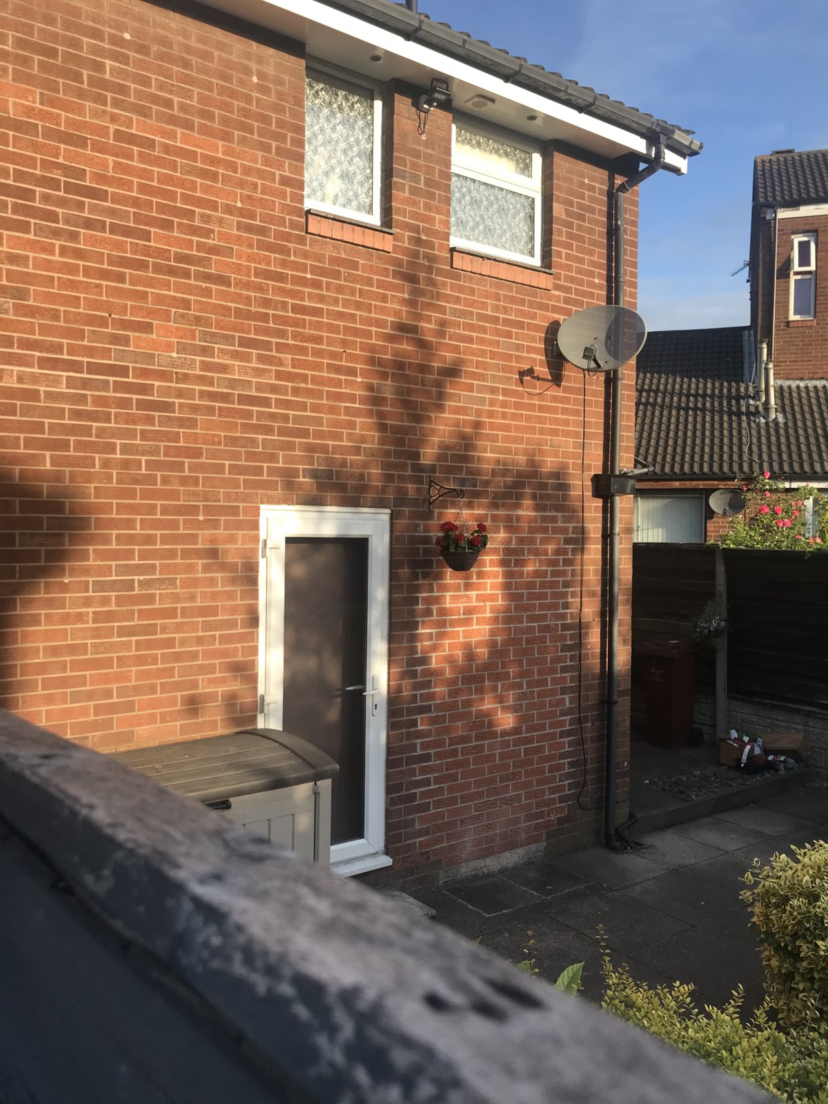

What windows are to the rear of the adjoining property, are there are any photos? LPA’s have varying policies and guidelines on the siting and design of extensions and something that may impact your proposals are windows of the neighbouring property that serve habitable rooms. This is the outlook, privacy, daylight guidance and is normally done by a 45 degree line on the centre of a neighbouring habitable window.

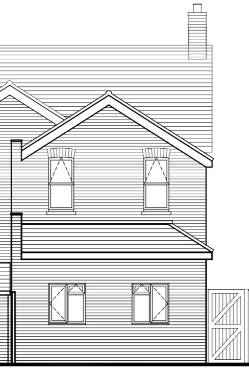

I will put all these to my friend would it have to be step in slightly for the the gable so the guttering will be on my property. Sorry to sound silly what’s a parapet
here pic on the neighbours property she seems to have had her back door moved and the bottom window bricked up.. boot upstairs windows is obscured glass the Furthest being the bathroom window and the closes is the hallway window

No part of the extension should overhang the boundary line, which includes any new foundations, guttering, etc... As you’d normally expect to see a 600mm wide foundation under the new side wall, you’d end up with a gap of at least 150mm between the face of the side wall and the boundary/fence line. Attached is an example of a rear first floor gable with a parapet wall but obviously your parapet wall will be on the right hand side.
Due to the lack of the neighbours’ windows/doors serving habitable rooms, the Council shouldn’t really take into account any loss of daylight.
