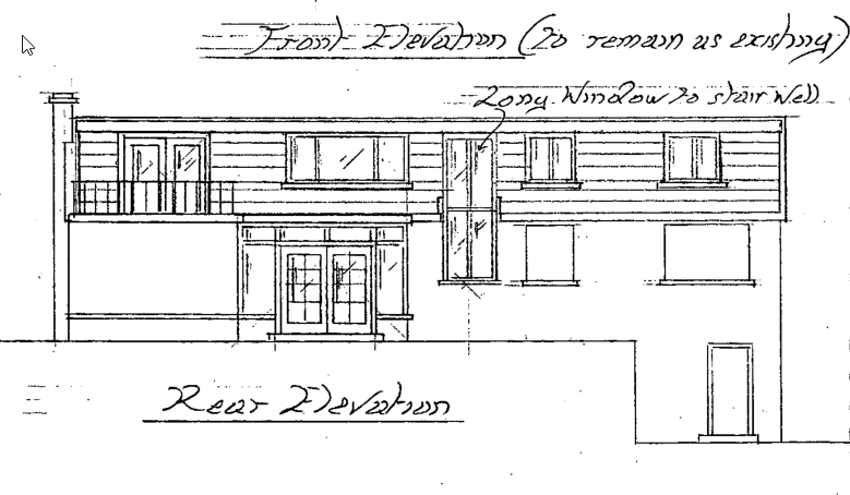

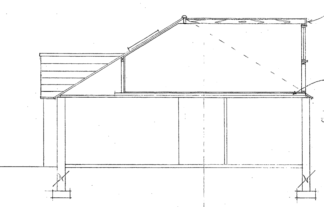

Both the planning and appeals officers have found the rear dormers too bulky. The proposed rear dormers are less bulky than the neighbours that went in without a hitch. I can make them even smaller t appease the planners but then I am left with a much smaller space than the neighbours, proportionally.
I attach the neighbours plans that went in without a hitch. As you can see especially on the cross section this is using 100% of the possible roof space.
