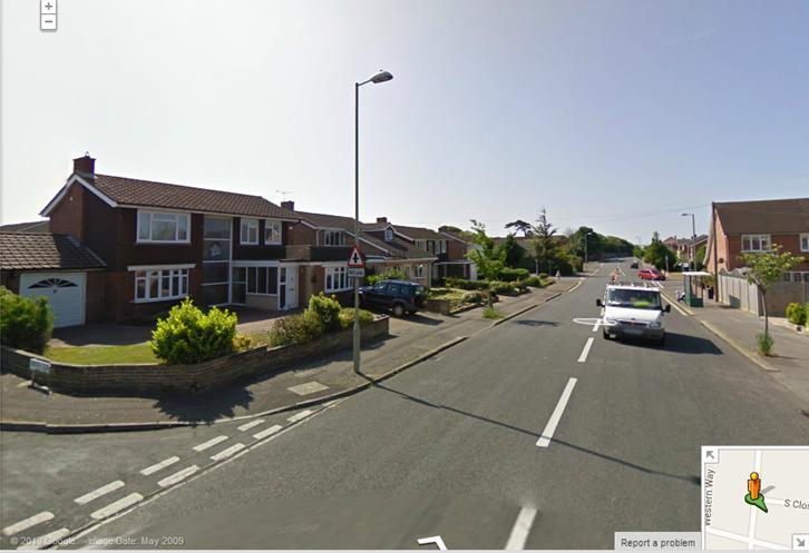

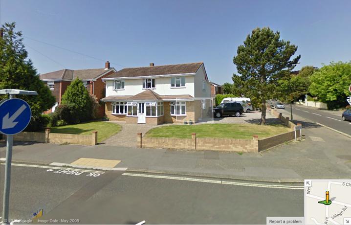

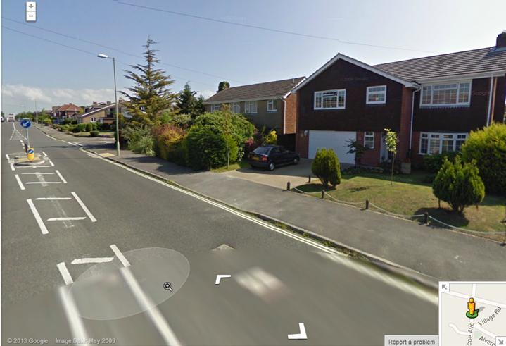

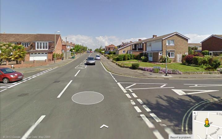

Anyway. here is a few images of the street to help put all this into context. I have put some captions with them to explain the view.
So firstly this is a picture of the house as it currently stands.
This is a picture looking up the road with the house on the right hand side.
This is also looking up the road but from a bit further down. The house is just behind the tree.
This is looking down the road. My house is the last one on the left just before the road junction (you can just see part of it)
As my house sits on a corner plot this is the house on the diagonally opposite corner
This is further up the road. There is a real mix of houses but pleanty which are of similar design / size to what I am proposing.
Lastly is another house on the road just showing an unusual design. it is a bit marmite, personally I like it. We are looking at using similar materials for ours (grey windows, light render and cedar cladding). The planning department seem fine with this.
Hopefully that helps put our house / plans into context. What are your thoughts?

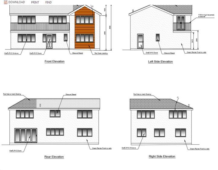

Thing is, being on a corner plot you also have to consider the street scene on the road that runs away from the rear of your house.. It has a short terrace of smaller houses before going to bigger semis. If you take a look at the roofs of those terraces, they're simple gabled style, stepped to provide some interest. If you extend your house as proposed then there will be this BIG extension sticking out of the side of your hose and up to their building line with a gable end on it. From across the road, looking at your gable, it looks incongruous with the others. At the moment it's accepted because it's set back from their building line and is less imposing. Perhaps consider changing the design of your roof on this end so your house has a gable end front and back, and standing across the road (south of your house, looking north) reveals a roof that slopes towards the viewer, just like those stepped terraces do. This will make it less imposing, more in keeping with their style and conceptually your house is the same volume because you merely moved a roof point 90 degrees round...
If they still moan, you could take the brown bit of your extension as a whole and step it right a few brick lengths, leaving the back of the extension where it is.. this would visually sympathise with the stepping present in that row of houses, break the face of your south elevation and make things seem less large
Thanks cjard - your ideas are great. We had originally actually had the roof as you suggest however changed it. I hadnt thought about the roofs of the other houses and keeping it inline with theirs.
Is this the roof style you are thinking of?
With regards to your second comment I am trying to get my head around what you are suggesting. Do you think I should make the house a tad wider and then on the south side step it back slightly?
Greg
If you see the South elevation in my pic. . Your roof above the rear extension is hipped mine is gabled. . If the house were cake, cut along red line in South elevation and push the smaller part away from you, you stagger the roof planes without a loss of space.. just a bit more of a staggered roof plane
