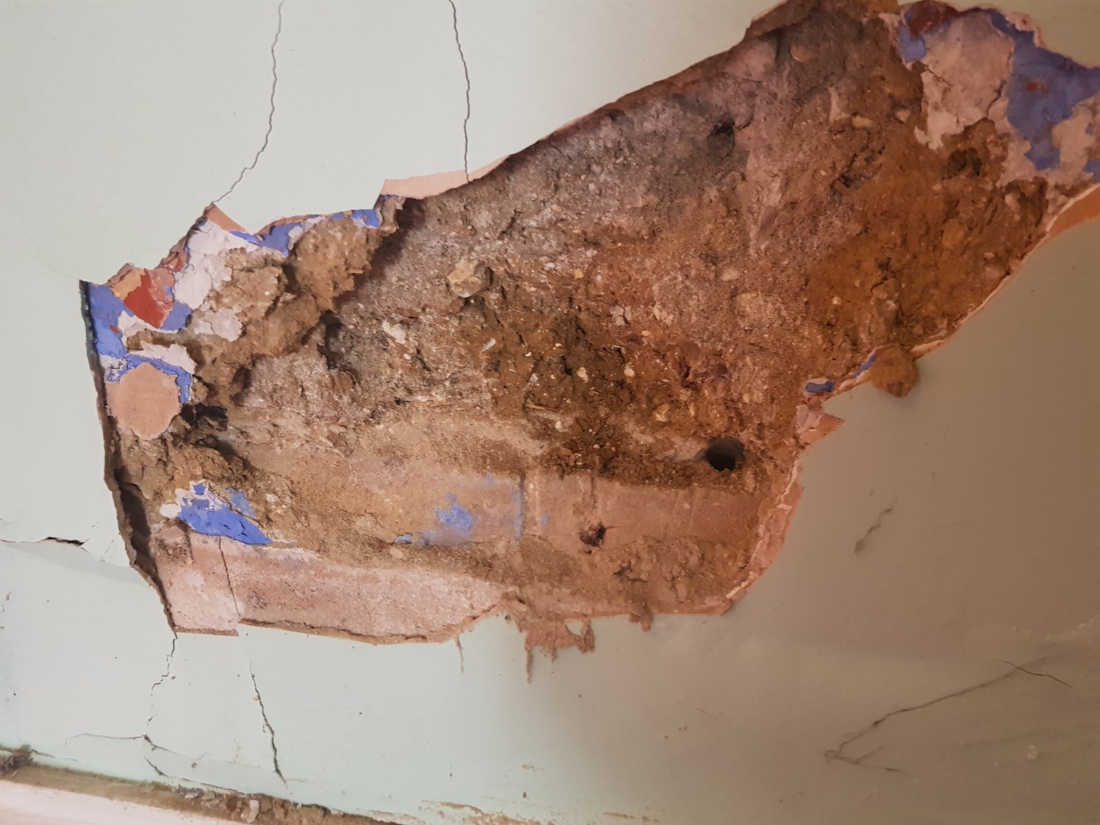

Hi,
I have a house under offer which is probably pre-ww2.
In 2 corners of the downstairs living room plaster is falling off presumably from damp in the past, although it doesnt feel damp now and there is no other evidence of damp either coming down the walls or from beneath (floor and carpet is bone dry)
On closer inspection, I picked away at it a bit expecting to see brickwork under the plaster which i was originally planning on stripping off up to waist height, but the inner layer of brickwork only comes up to about shin level. Above this (and behind the plaster layers) is a brittle clay-like material which i can only assume is adhered to the outer layer of brickwork which continues up the house (otherwise the house would fall down!).
Any ideas what this material is, is it standard material for walls to be made of? Would this all need to be taken off ? I've attached a couple of photos.

Encountered this before, it’s like a load of rubble/stone/cr@p on the inner skin. Not sure how far up it normally continues, but it’s a nightmare to fix to.

The plaster was fixed to it before, so i assume can be done again.
I guess my main question was given that it's quite soft and brittle, would it all need to come up up to a certain point? It constitutes a major part of the wall, so what would replace it, brickwork?
as above - possibly Cobb.

you show a failing gypsum skim plaster with backing coats of whatever?
lower down the wall there seems to be some kind of skirting?
on the info so far its difficult to say anything definite.

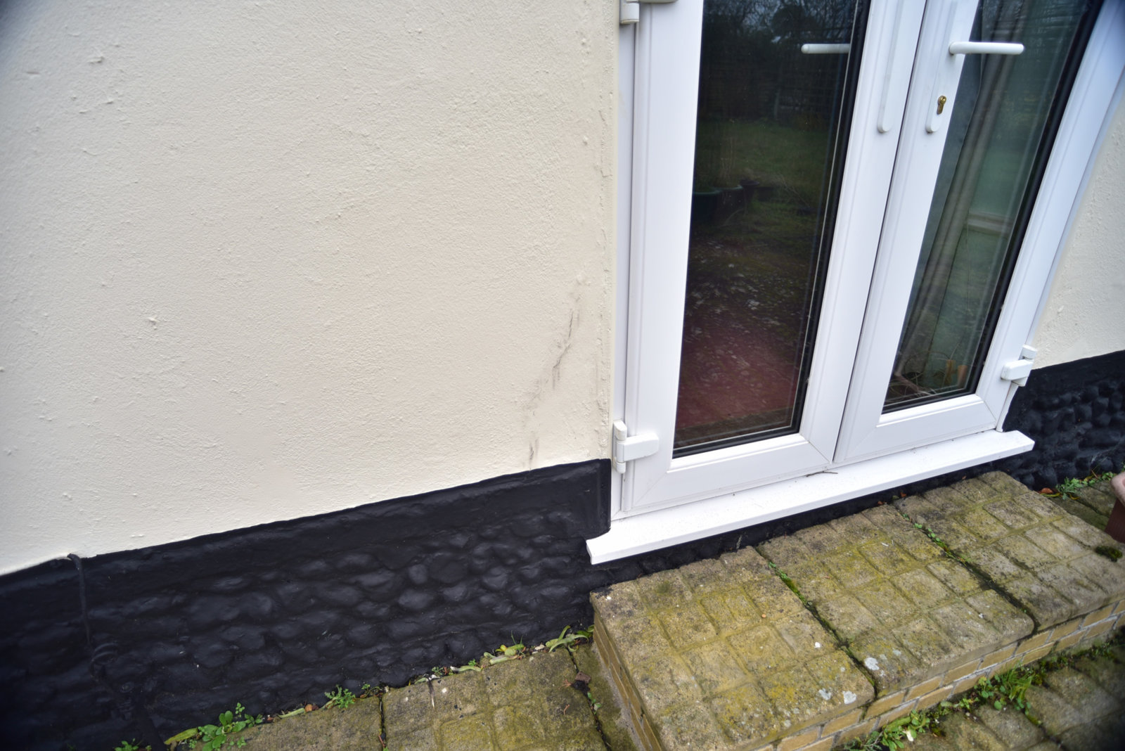

It's in Norfolk, although i'm not sure about the age - probably late victorian although the original building may well be earlier.

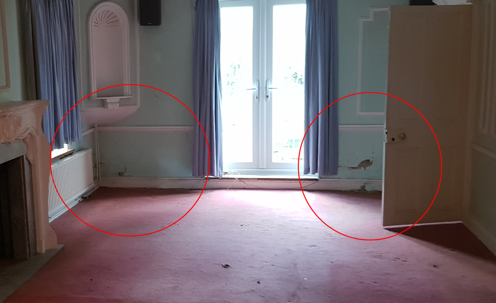

I've attached a few more images. On the outside there is cobble up to the same point where the brick comes up to on the inside. As you can see, there is no evidence of existing water ingress on the outside from leaking gutters or sitting water. I've noticed that there is a line around the entire internal wall which marks the

in the second internal picture what is going on with the skirting on the right side of the room?

That's just where the fallen plaster is leaning on the skirting. There's nothing untoward about the skirting. The walls are quite thick, perhaps 30cm
on the outside pic, roughly in line with the step tread, there appears to be what could be a DPC?
however, where the exposed pebbles (black) meet the cobb (white) - the cobb, or perhaps its render, should have finished with a Bell Cast to throw the water off.
instead there's a ledge which will actually catch water, and might even be directing the moisture into the cobb - causing the water damage inside the room?

the Pvc doors should have been set back 75mm from the face of the building.
