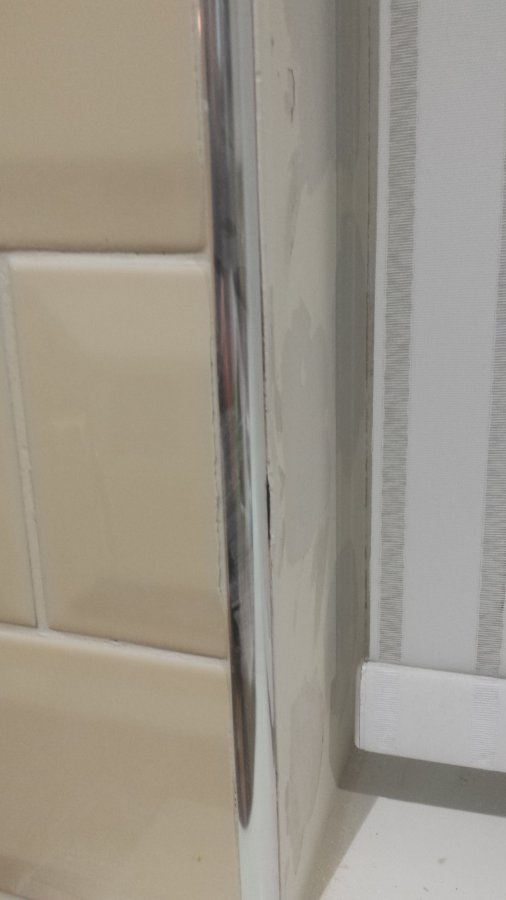

Hi folks,
I've had some tiles fitted and I've noticed that the corner of the wall has popped out. how can I fix it.
Thanks in advance.

That looks really small so maybe just pick the flakes and use easifill?
I had some blown plaster that was still on the wall and I used a drill to whack a few holes in the area and injected pva into the gap before using a wooden plate and long timber to press the original plaster to the backing. It worked. So far.
carefully chip it out and fill with filler and sand back
Hi Scott,
what room is that in please? Kitchen or Bathroom?
When you say the corner of the wall do you mean the silver bead running vertically or do you mean the flat window reveal?
I can't quite make it out from the photo but is that reveal plasterboard or a solid wall?

Hi there, it's the kitchen and it's a plasterboard wall. I sanded it back and filled it with this stuff called devil filler or something. Looks loads better now it's been painted.
Thanks for the help everyone!
