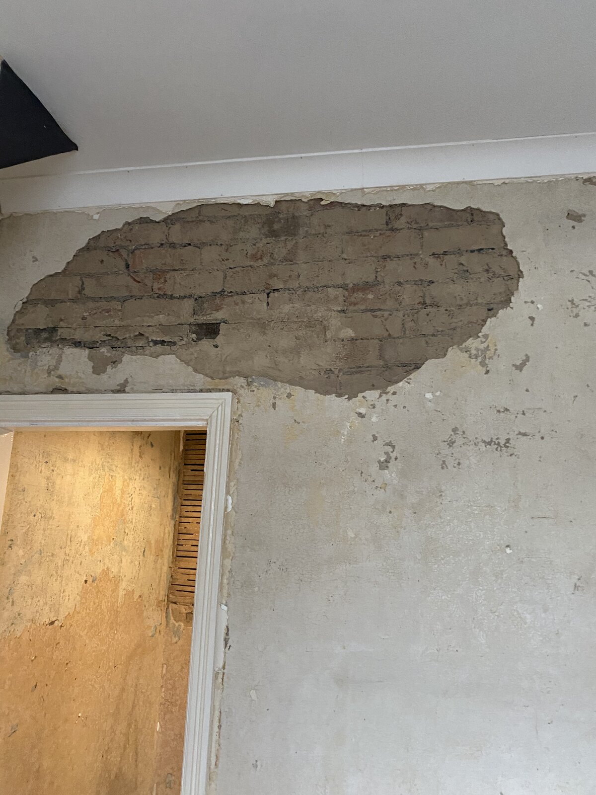

Hello, I was wondering if anyone could tell me what type of plaster is on this wall, how I should patch this up and with what products, as you can see from the wall behind most of the property is lath and lime plaster but this wall seems different so I’m not sure if I need to use a lime based product? I removed all of the loose plaster and now have this huge hole the rest of the plaster around this is solid and has no gap between the brick work so don’t want to remove it all. Any advice would be greatly appreciated. Thank you

depends what sort of finish you’ll be happy with. theres several options. i’d fill it out with cement or bonding coat , prepare and skim the whole wall .

I’d like it as flat/smooth as possible but I want to do what’s best for the wall. Is there any products that you would recommend please?
Square off the patch from the door head archietrave to the cove and vertical edges at the sides.
Two courses above the door head is that timber?
Clean off remaining old plaster and take up suction with water or Pva.
Pull it out with whatever powder or render materials you have on hand and skim with ordinary gypsum finish. the rest of the wall surface looks good.

Thank you for your reply, yeah there is a short beam of timer in there, it doesn’t seem to go anywhere just ends and the brick resumes. Thank you for your help.
use Pva and mesh on the timber or it will suck up your powder mix moisture. Dont try and remove the timber its harmless on an inner wall
