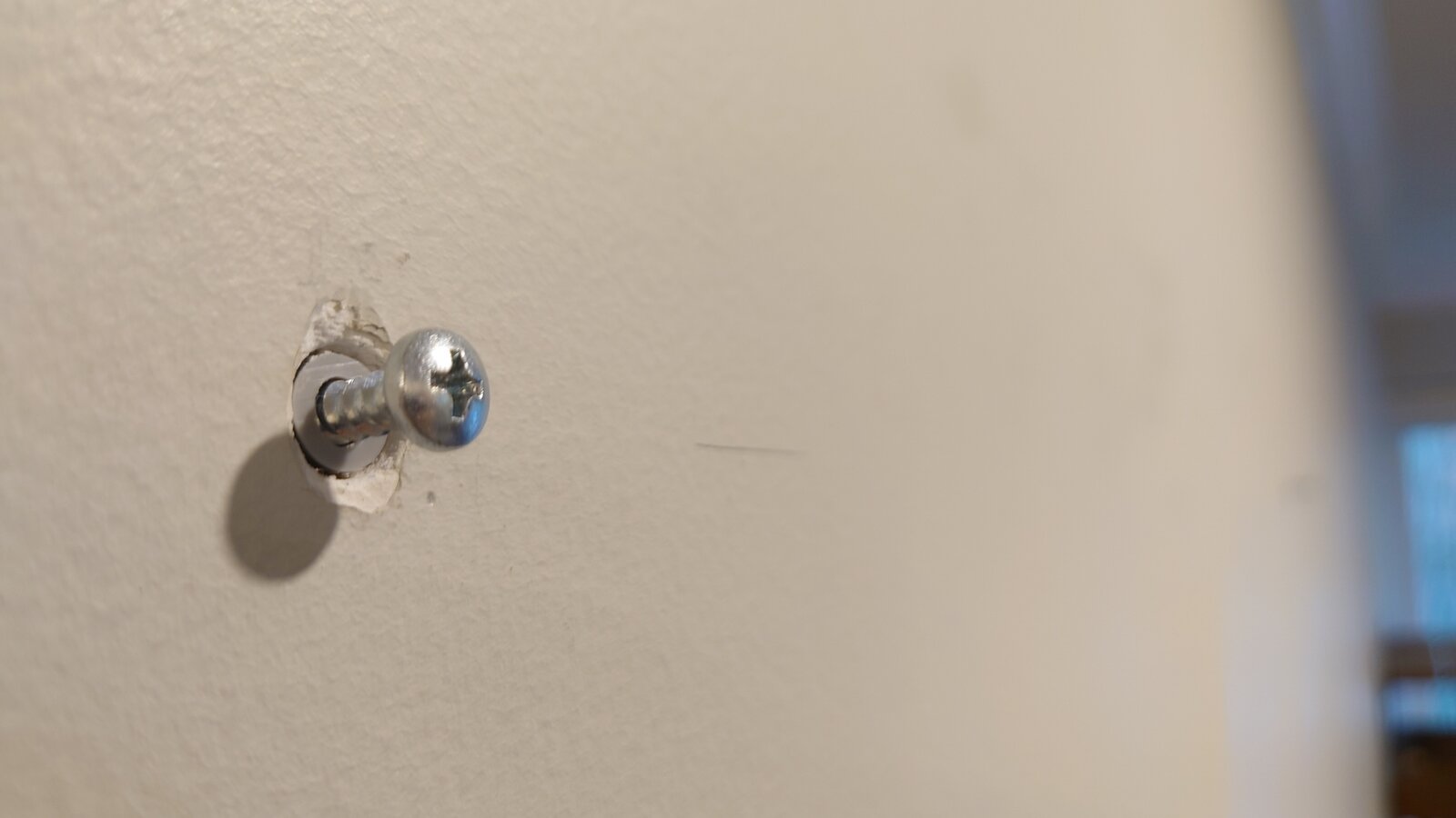

The hole in the masonry is one size - but the nylon plug is compressible to an extent, and wood screws can cut their own thread as they enter. TBH I"d avoid the smaller (#8) screws
Ok, so I also have these. They're #8-12, the anchors need a 5/16" drill bit and are 1-5/8" long, and the screw size is #10 x 2.5"
Would that be better? Maybe take the #10 screw from this set and the plugs from the #6-10 set?
Just wanted to come back in here and say thanks to all of you.
Firstly, I went and drilled a 1/4" hole, useda #6-10 anchor/fastener but used a #10 screw from the next set up instead of the #8 the #6-10s came with. Here's how it looks, complete with the same stripped hole reused just made a bit bigger, self evident in the photos.

Because I'm clearly not going to be able to use these screws anymore in that hole.
So, that's where I am.
Generally, unless it's some bizarre design with a significant projection away from a wall, the force exterted by the mirror on the fixing is vertically downwards so the fixing's requirement to resist pull-out is minimal
You could slide a smooth nail into that hole and hang the mirror on it; no one is going to be yanking the mirror away from the wall in normal use or even cleaning
