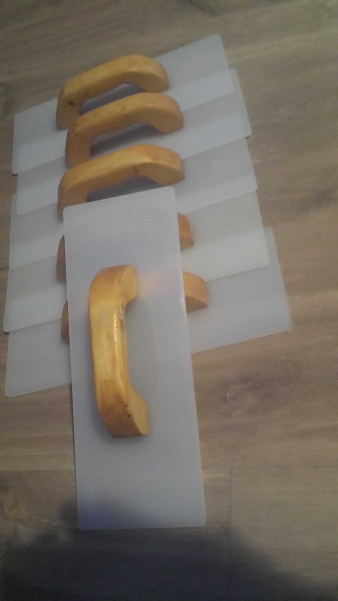

Hi lads I maybe making some of those plastic trowels again I got a supplier whose selling me 50 blades just got to do a deal on the handles so if you need another or need a replacement blade for your old trowel let me know, for those that have not used them before they can be used in conjunction with the steel trowel or the refina plazi for the final finish if your in a rush this trowel let's you put a finish on the plaster way before its set or changed colour saving you about half hour to 40 mins depending on the conditions
Now I've heard good things about them, but haven't seen any yet. What's the size of them, and the price Steve
I've uploaded pics of them on my profile for you Doggit they are 14 inches I'm expecting them to be around £ 20 also I will give you aftercare such as how to use them and spare blades ,so far there's 5 spreads from here that's used them that can vouch how good they are cheers

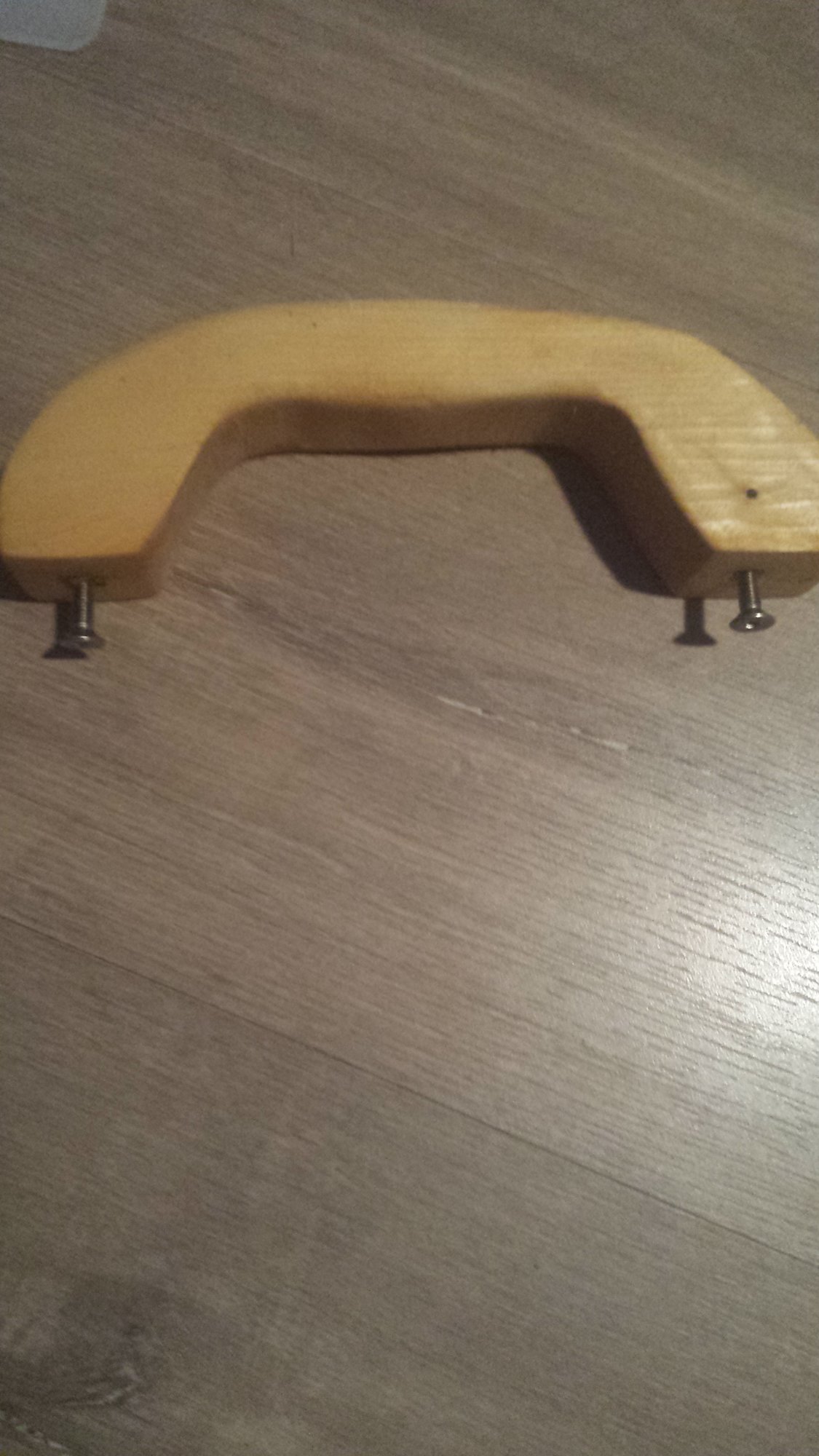

Well i was messed about by Indians from India trying to get the plasic handles so I decided to make my own done them in wood for the traditional wood feel I've used zinc alloy threaded inserts and stainless steel bolts I've done several versions of the handles progressing to what I felt was comforatable I started off with the profile of original handle and refined it I also have blades the same size as the 14 in Mt if you want a thinner version also a smaller foot long for tight spots above doors tinkering with the idea of putting them on ebay
