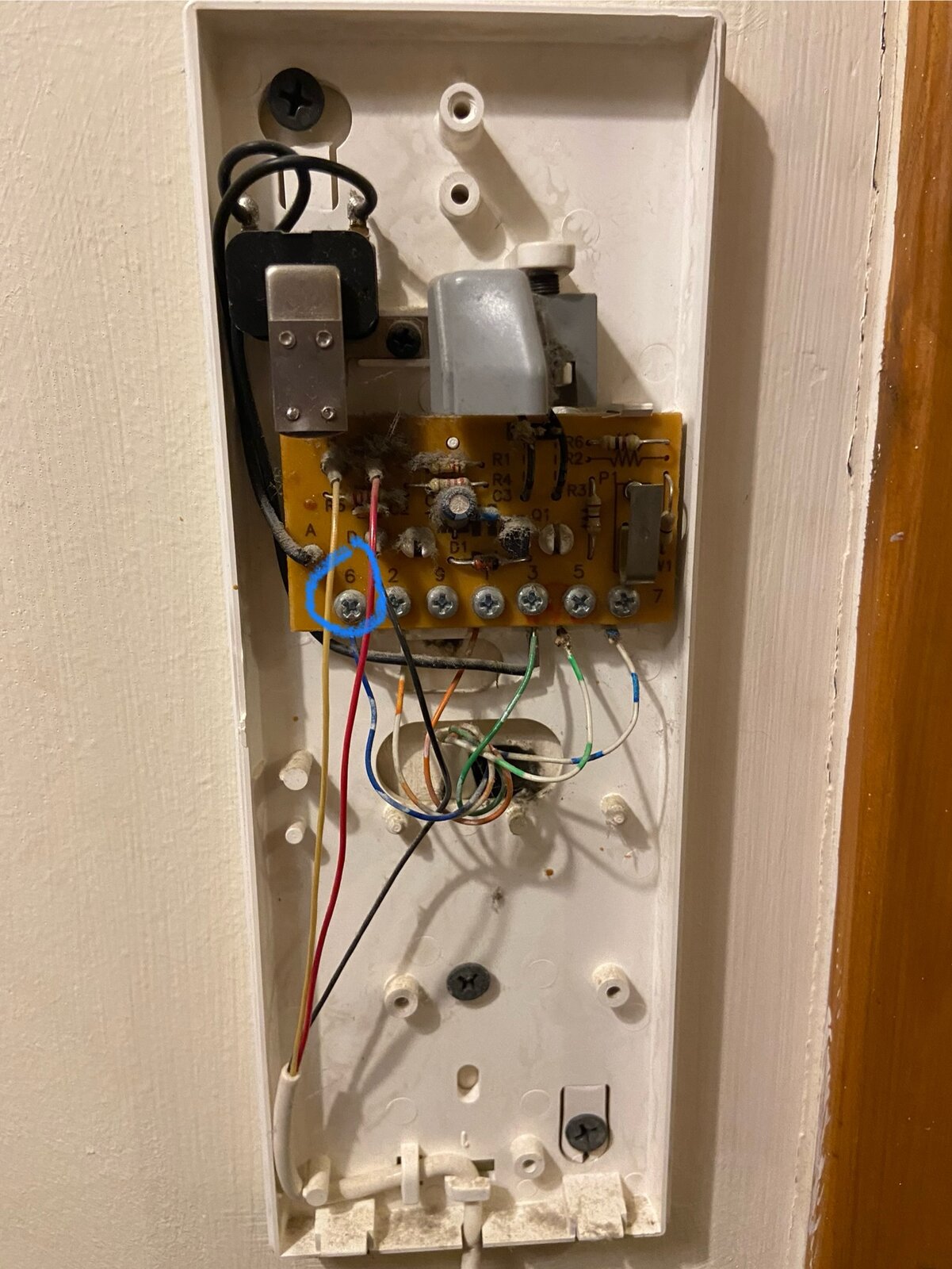

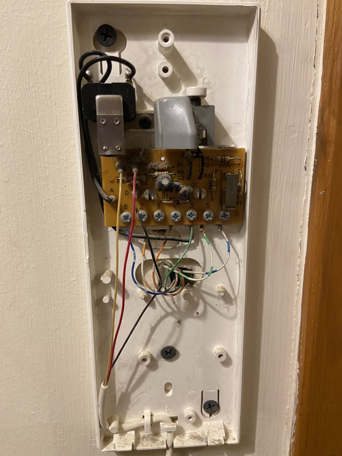

I have tried asking in other places, searching it myself etc but I’m having no luck at all.

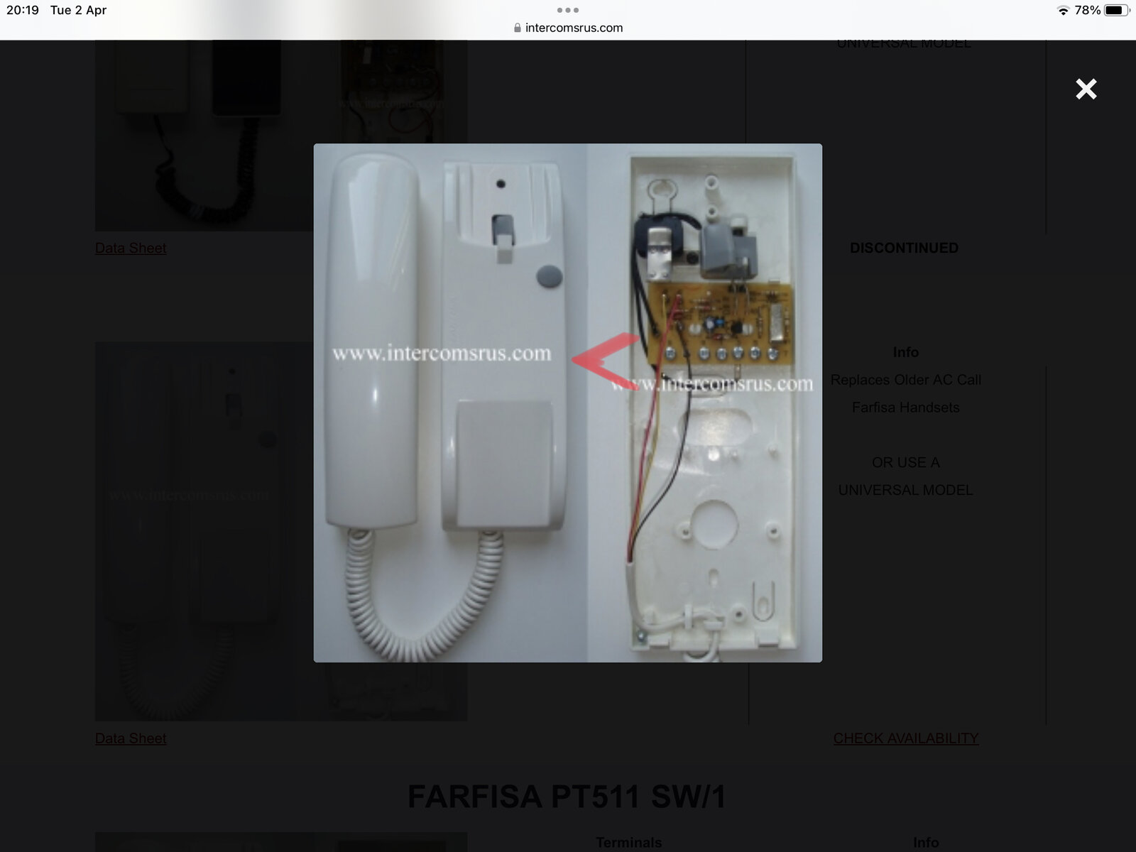

I THINK I have a Farfisa PT510 - https://www.farfisa.com/en/catalogue/basic-intercom-pt510w.html
It seems to have no silence option.
Photo 1 - this is the unit up high on the wall.
Will post next photo in new post
The attached image is behind the internal phone.
I have no idea which one the buzzing comes from, and how to silence it. Is there a way to do this while being able to put it back the way it was? (I’m renting!)
Thank you so much in advance. I’ve tried looking at the wiring manual and I just don’t understand it.

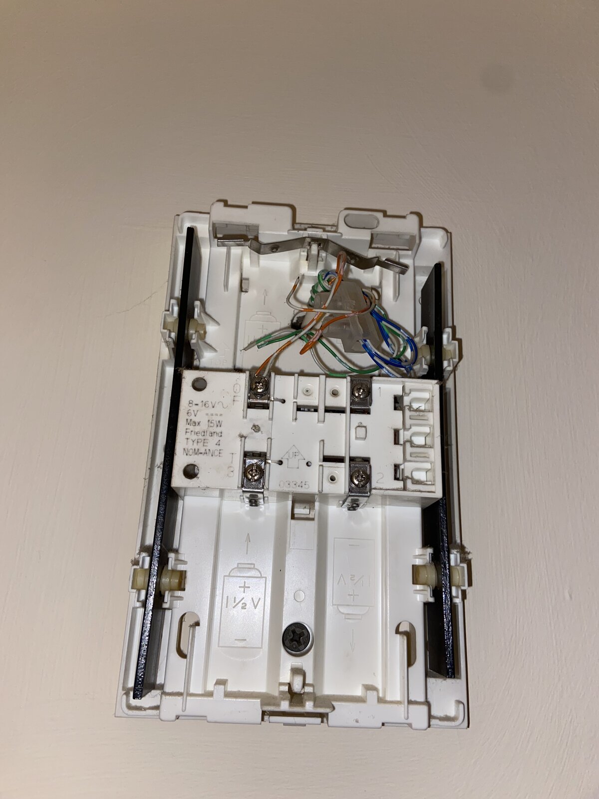

Image 1 is a door bell…check that your door bell isn’t jammed in ….it looks as if it’s not connected anyway….image 2 is a Farfisa intercom ….remove wire from terminal 6

Hi, thank you so much. This makes sense as we actually have a doorbell at the entrance to our flat which has never worked (and I’m not bothered about it) but I had no idea that was the box for the doorbell.

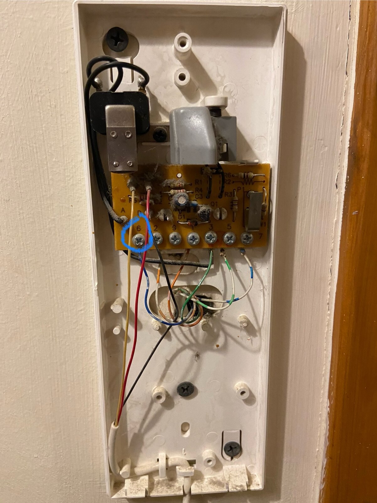

In relation to terminal 6 - I have circled where I think that is (sorry, really no idea what I’m doing). Is it the blue wire? How do I remove that safely, and if I remove it can I put it back in? Thank you

Hi sorry someone else said I need to unscrew terminal 6, not just pull the blue wire out. Which is it? Thank you
Image number 1- the unit only has cables running into port zero. It clearly doesn't function.

Jesus …it’s not rocket science….undo the screw and pull it out ….it may not even be that making the noise ….put your finger on the metal buzzer plate top left …..can you feel it vibrating ?

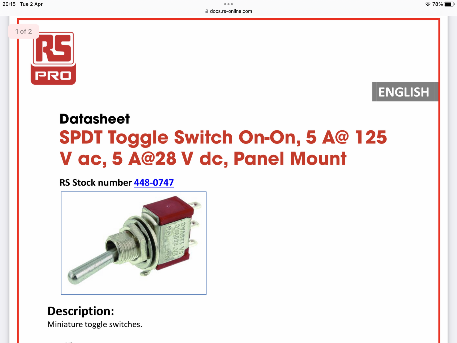

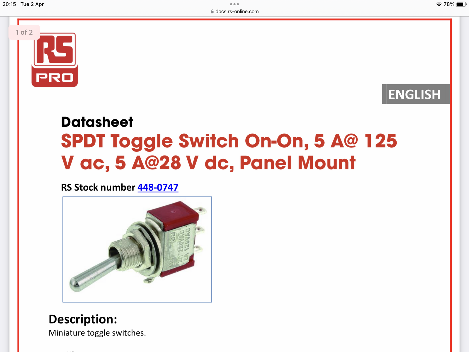

Sorry I read it as it’s buzzing and won’t stop ….fit one of these inline with terminal 6
Fit it on the side 6mm hole low enough to not touch the phone pcb

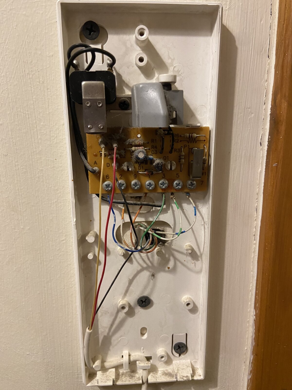

I appreciate your help, and sorry for all the silly questions but I’ve never looked at anything like this in my life. Yes, the issue is I want to completely stop it buzzing when someone presses the button on the outside door. I’m not particularly confident in fitting anything .. can I just unscrew terminal 6, so the blue wire comes out/is loosened and that’ll be it? Thank you
