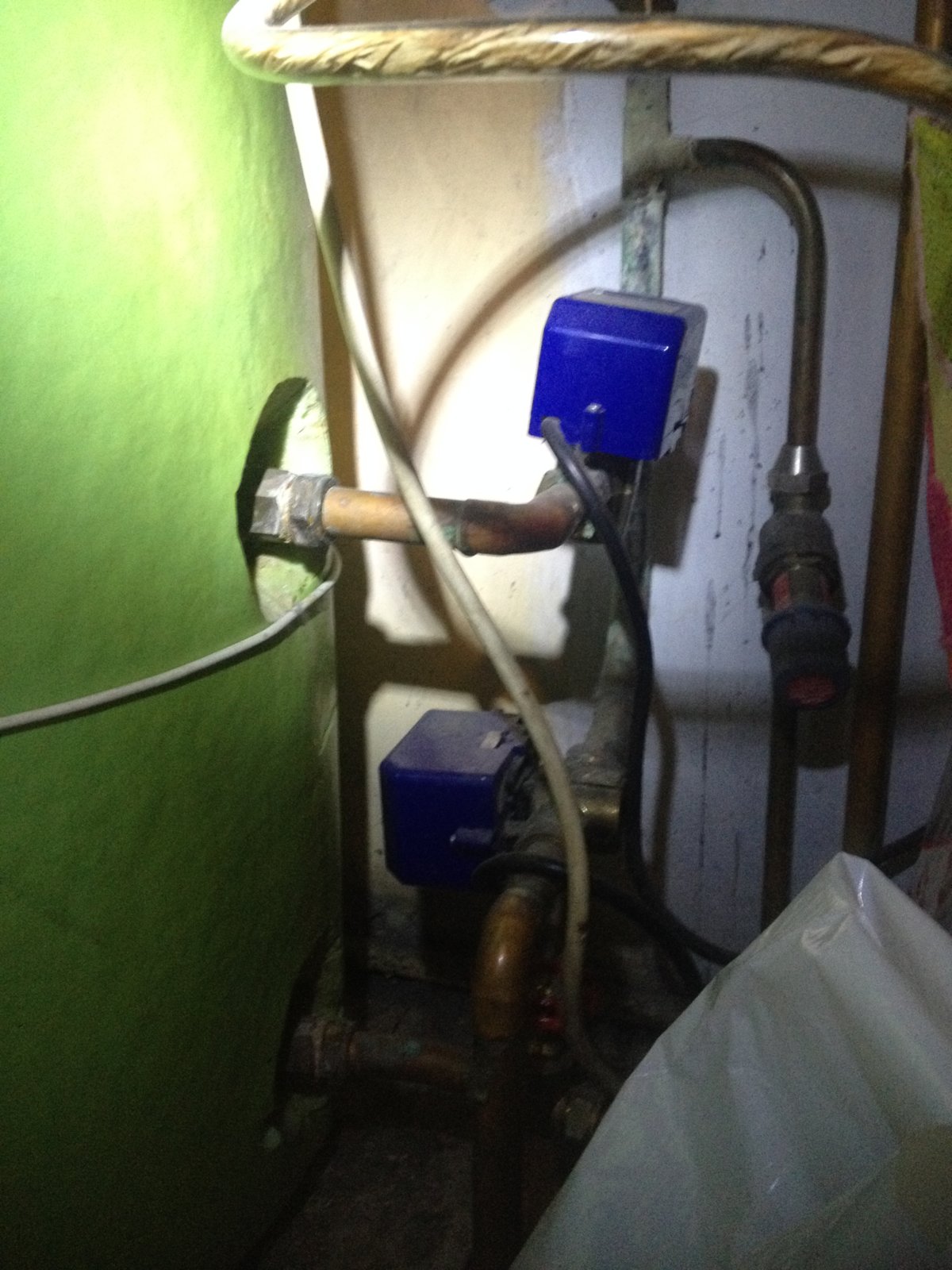

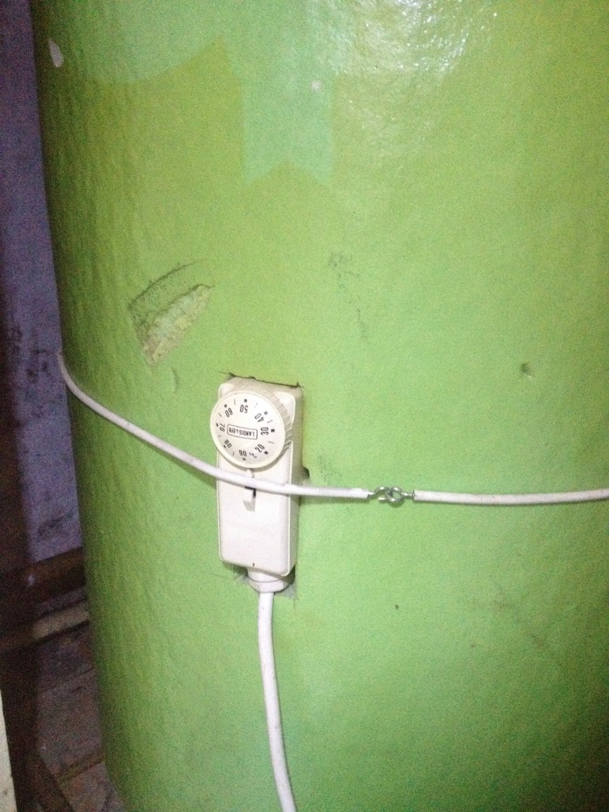

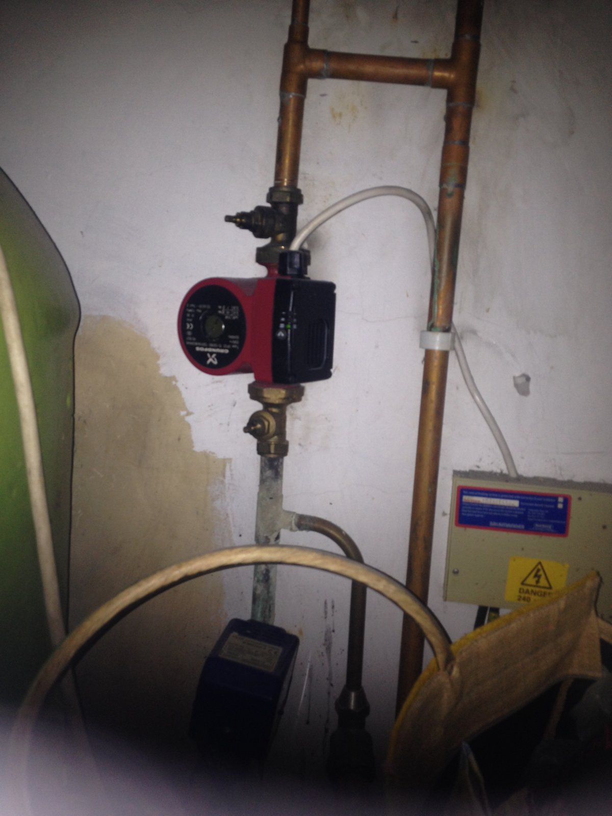

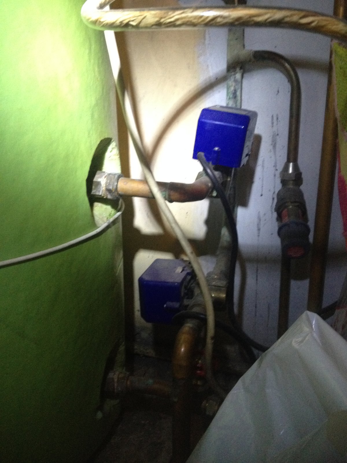

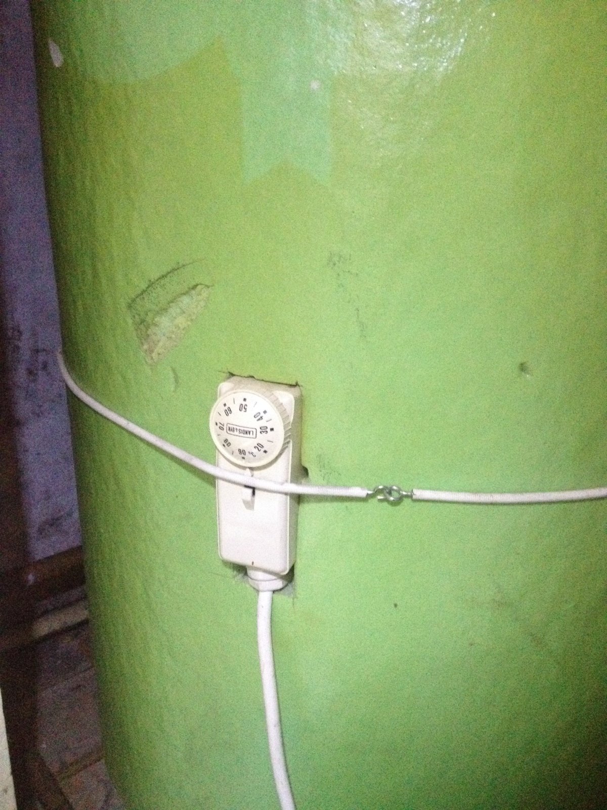

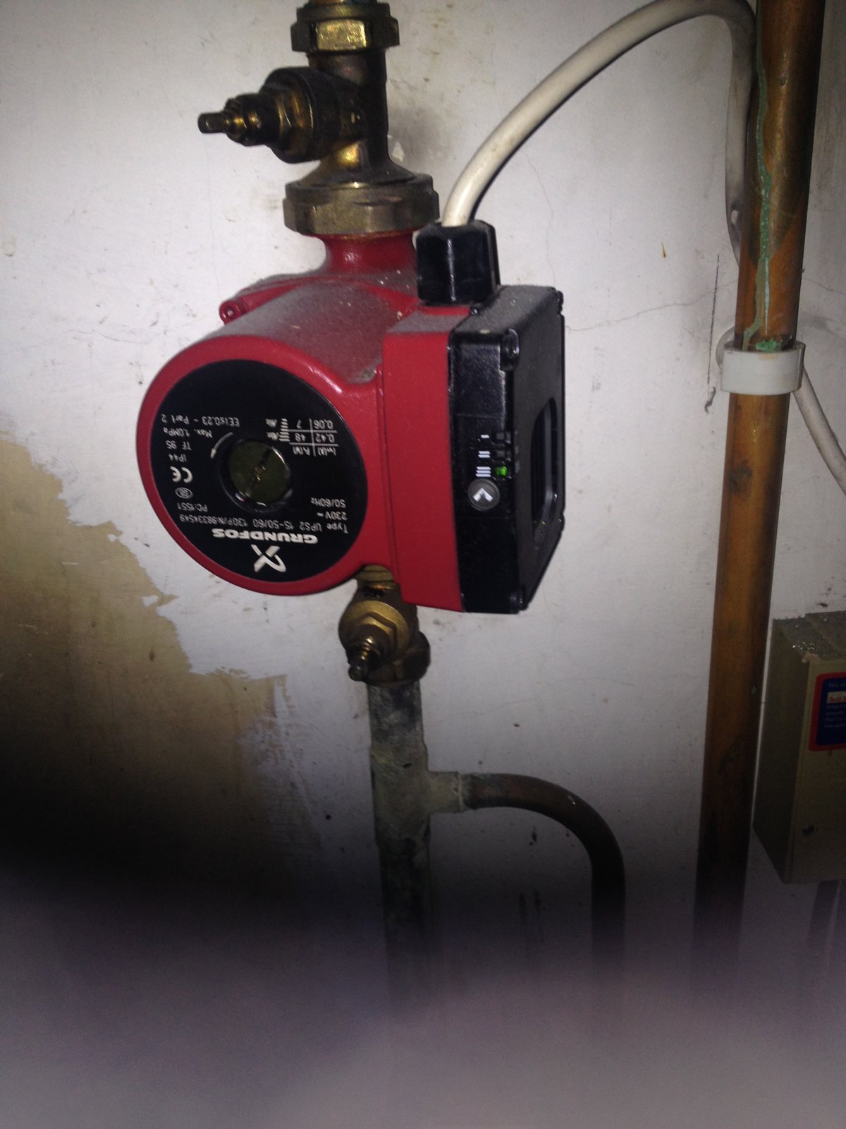

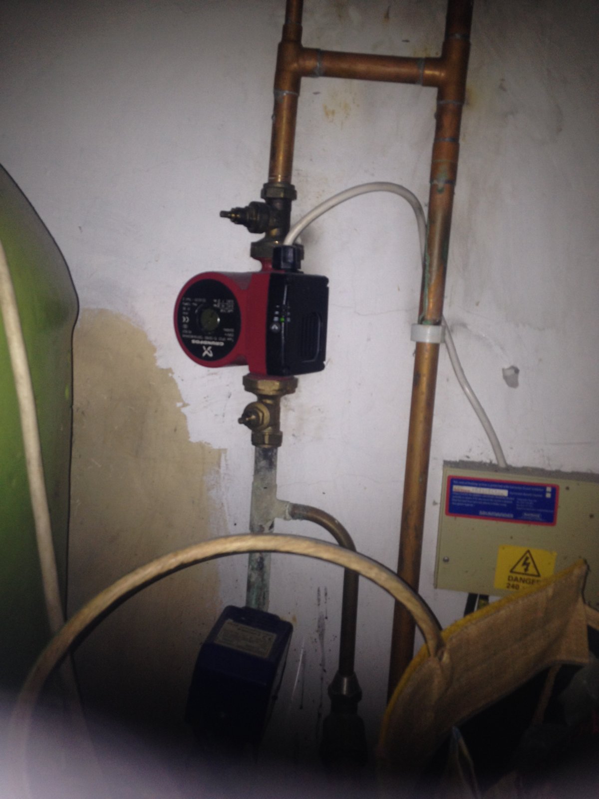

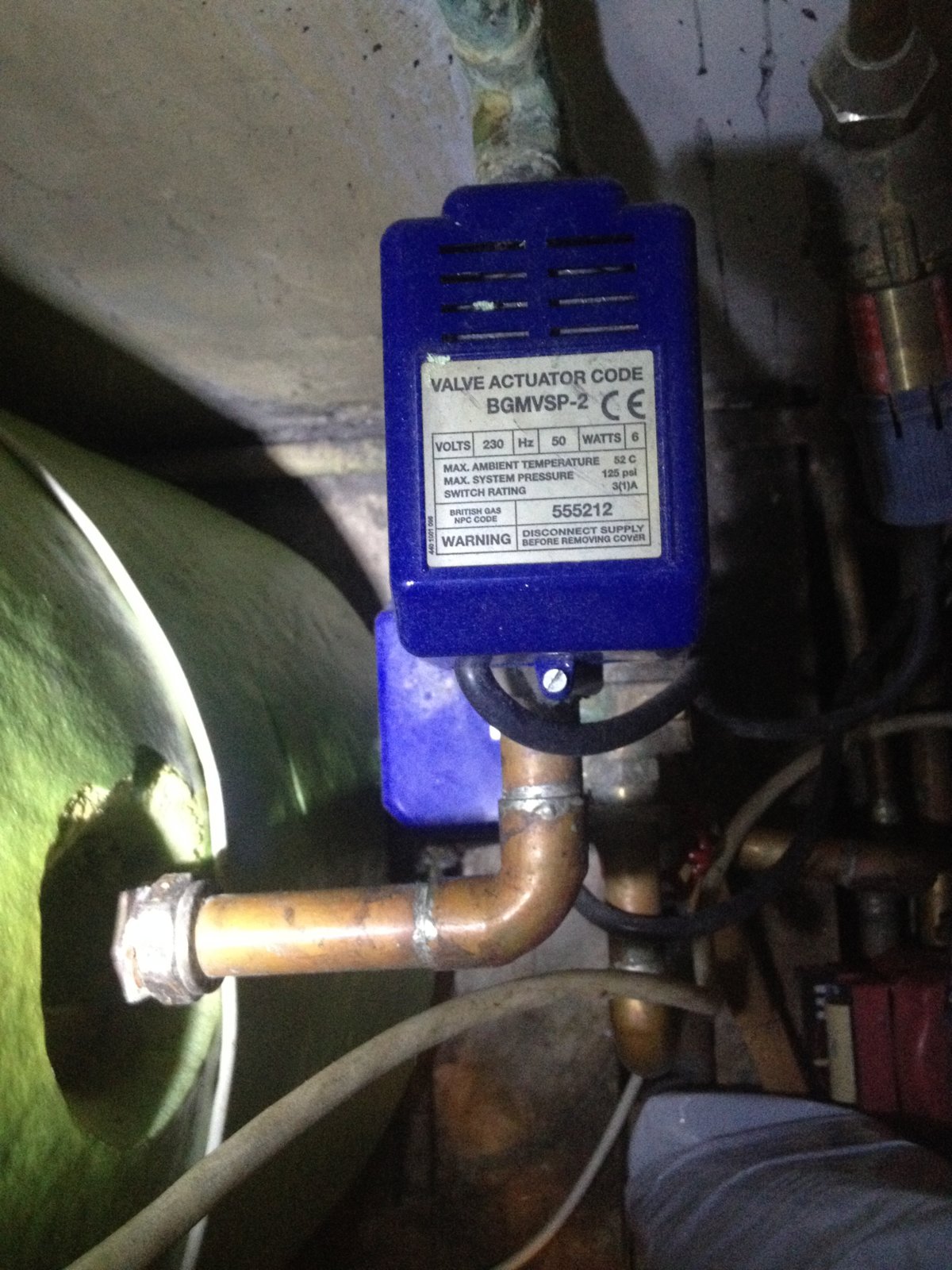

Ok, so I managed to take some photos of the water cylinder set up, any of these responsible for the perpetual hot water?

Your cylinder thermostat is set to 90° it will never reach that but keep trying that is why it won't turn off.
Turning it down to 60° should cure it.
Thanks everyone for your responses! Sorry for the delayed reply, I was working :)
I turned the thermostat down to 60 so hopefully this will help :)

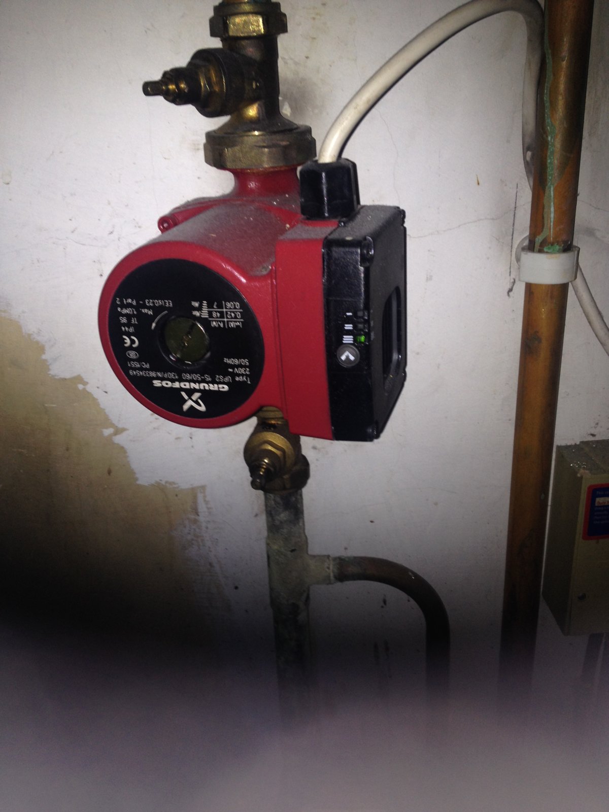

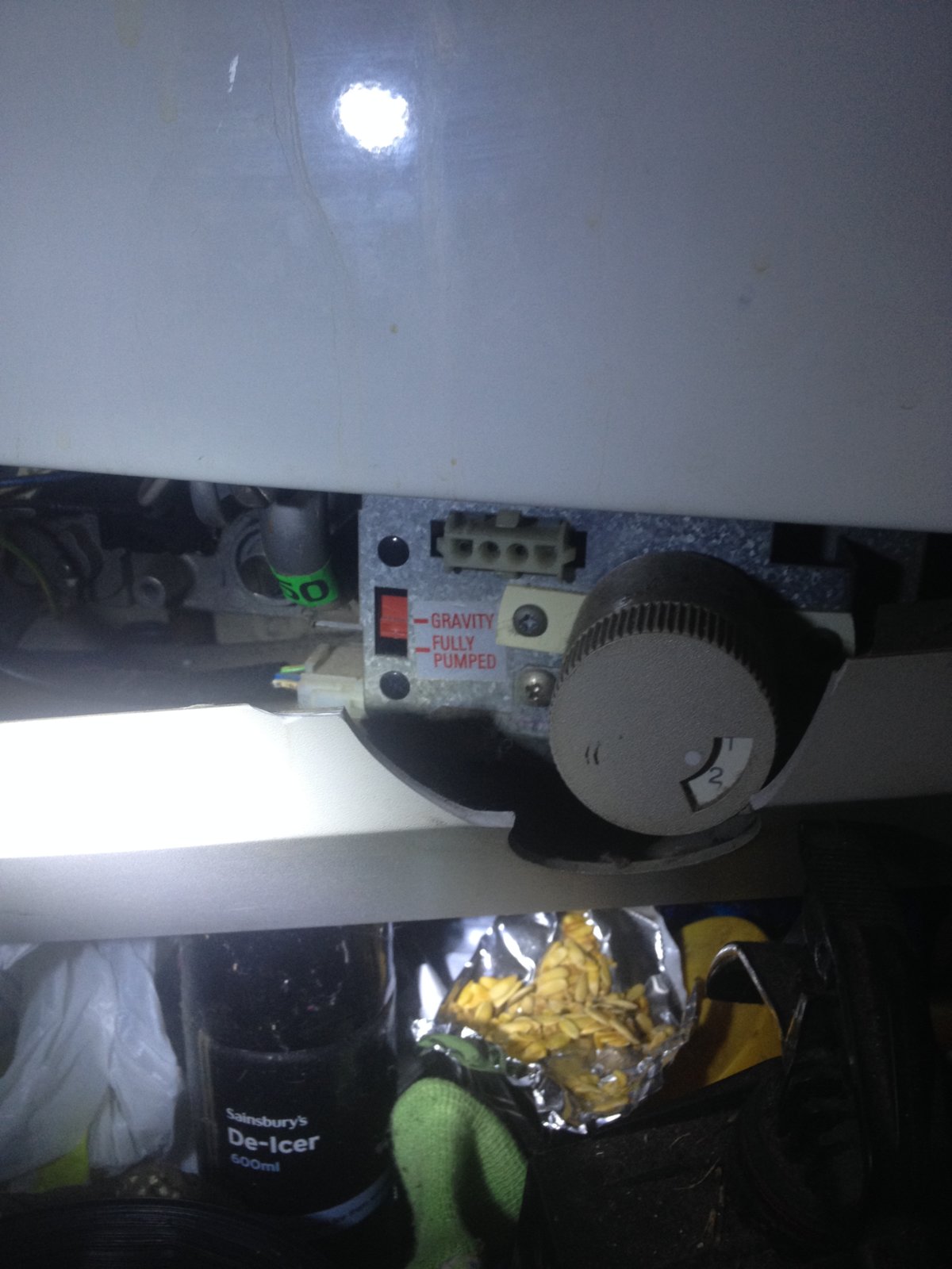

Also, I just noticed this about the boiler...it is selected to "gravity". The timer (previous and present) was set to fully pumped and I thought the red item in the image above is the pump?
