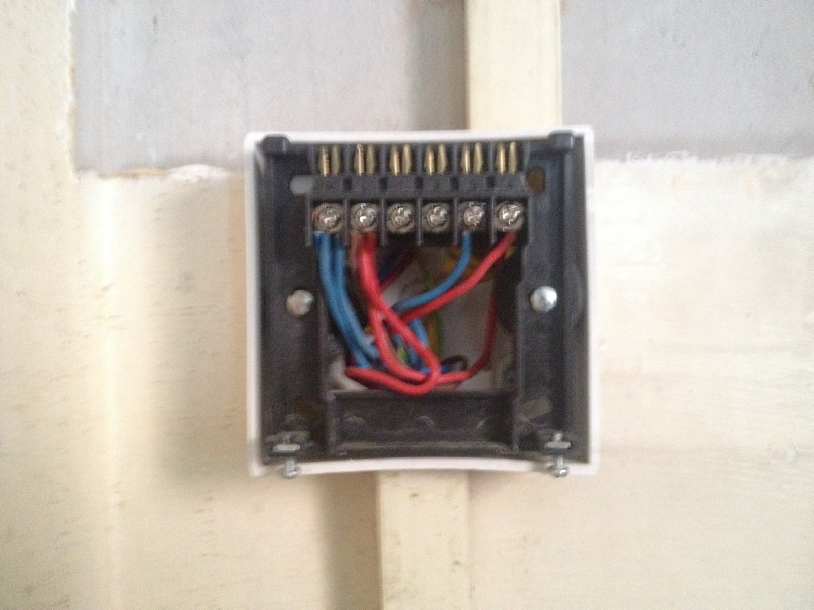

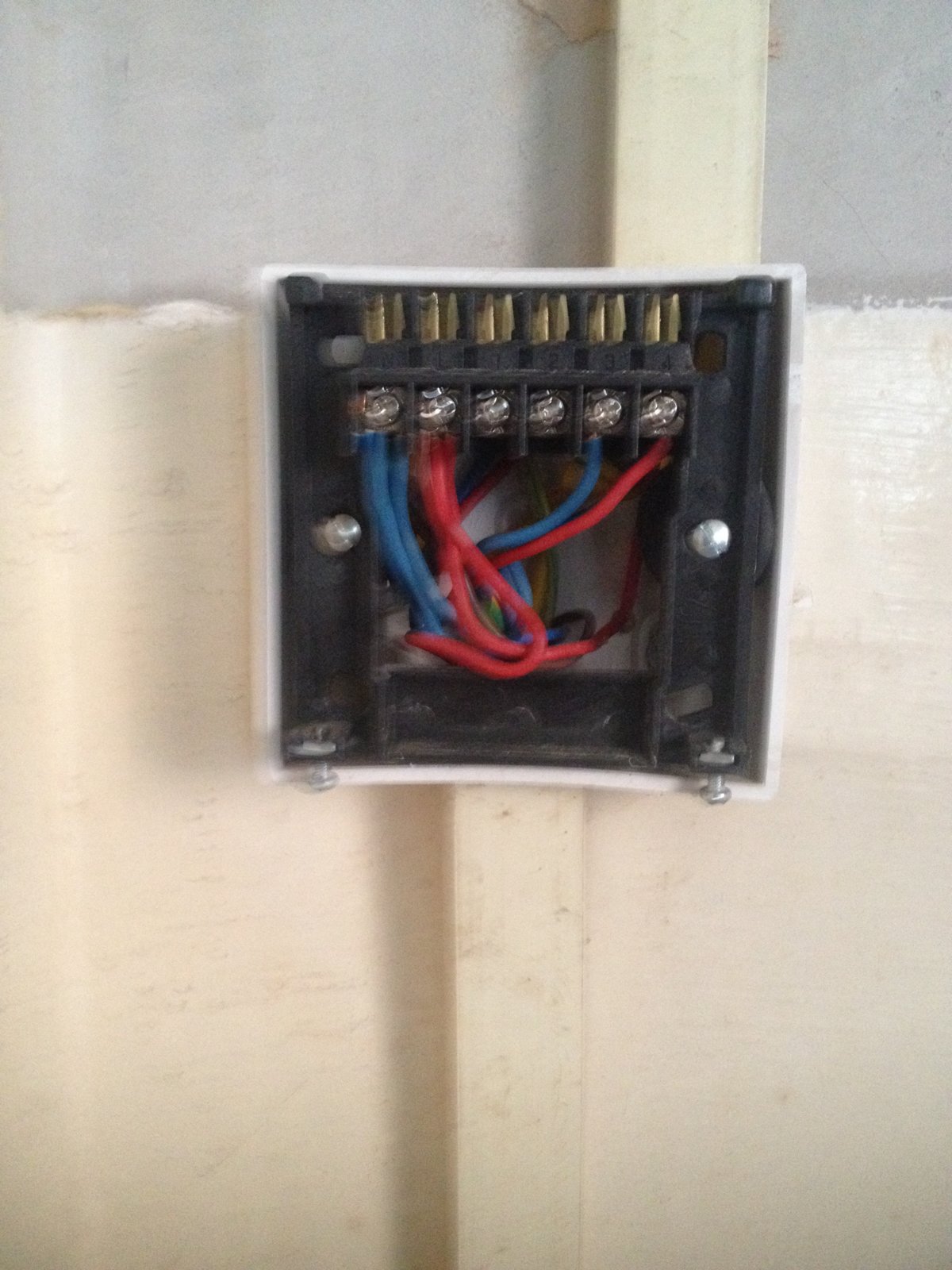

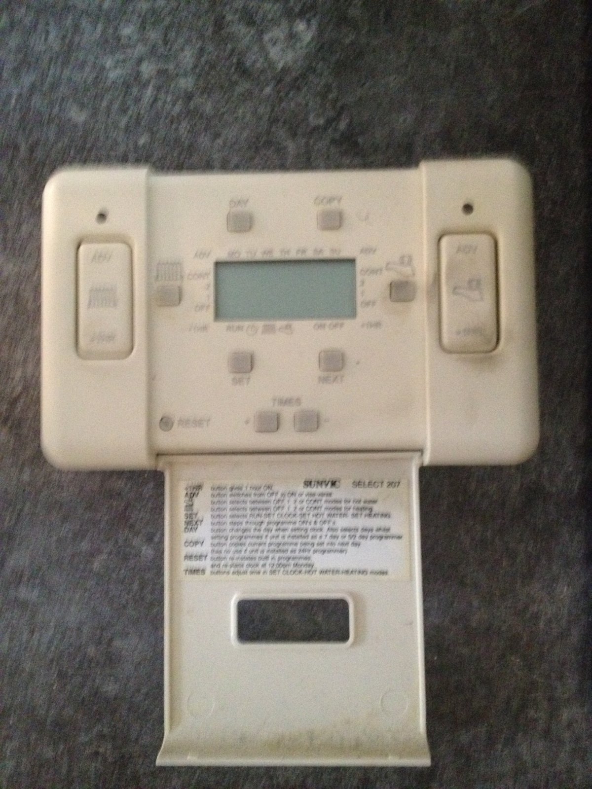

The engineer (an electrician who works with a plumber) said the programmer wasn't wired correctly and so for safety he was disconnecting it so that the boiler bypassed it. I asked repeatedly which one to buy but he hasn't updated me. I have some pics of the programmer and the wiring

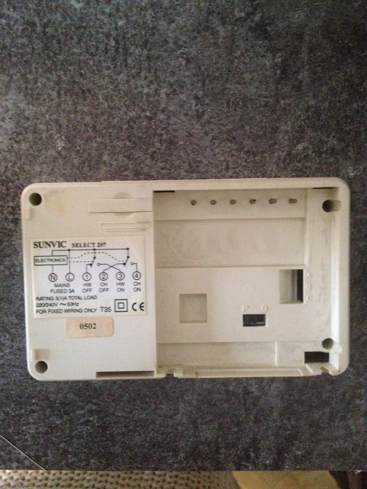

I have uploaded some pics of the programmer backplate. Do these come as standard fit?, can I buy any standard two channel programmer and slot it on? Thank you :)
Weird why he has removed the programmer stating it was wired incorrectly. It certainly seems to be wired for CH and HW control.
Without seeing it back at the boiler/wiring centre it's impossible to be sure how it's wired and hard to confirm if a standard programmer will be suitable as it stands. Back plate look universal though.
Better to get someone in to check and fit a new one for you.
Yes it's a standard backplate. But not all programmers use the same terminals for the same function. Having said that, yours is by far the most common format with terminal (3) for 'Hot Water On' and terminal (4) for 'Central Heating On' just make sure that you buy one that has the same configuration.
If you take your existing programmer to a reputable plumbers merchant and show them the diagram on the back as per your second photo, they will help you select one with the same format.
You say it's been disconnected! However, I can't see any disconnected wires at the programmer. So you will also need to find out where and how it has been disconnected.
