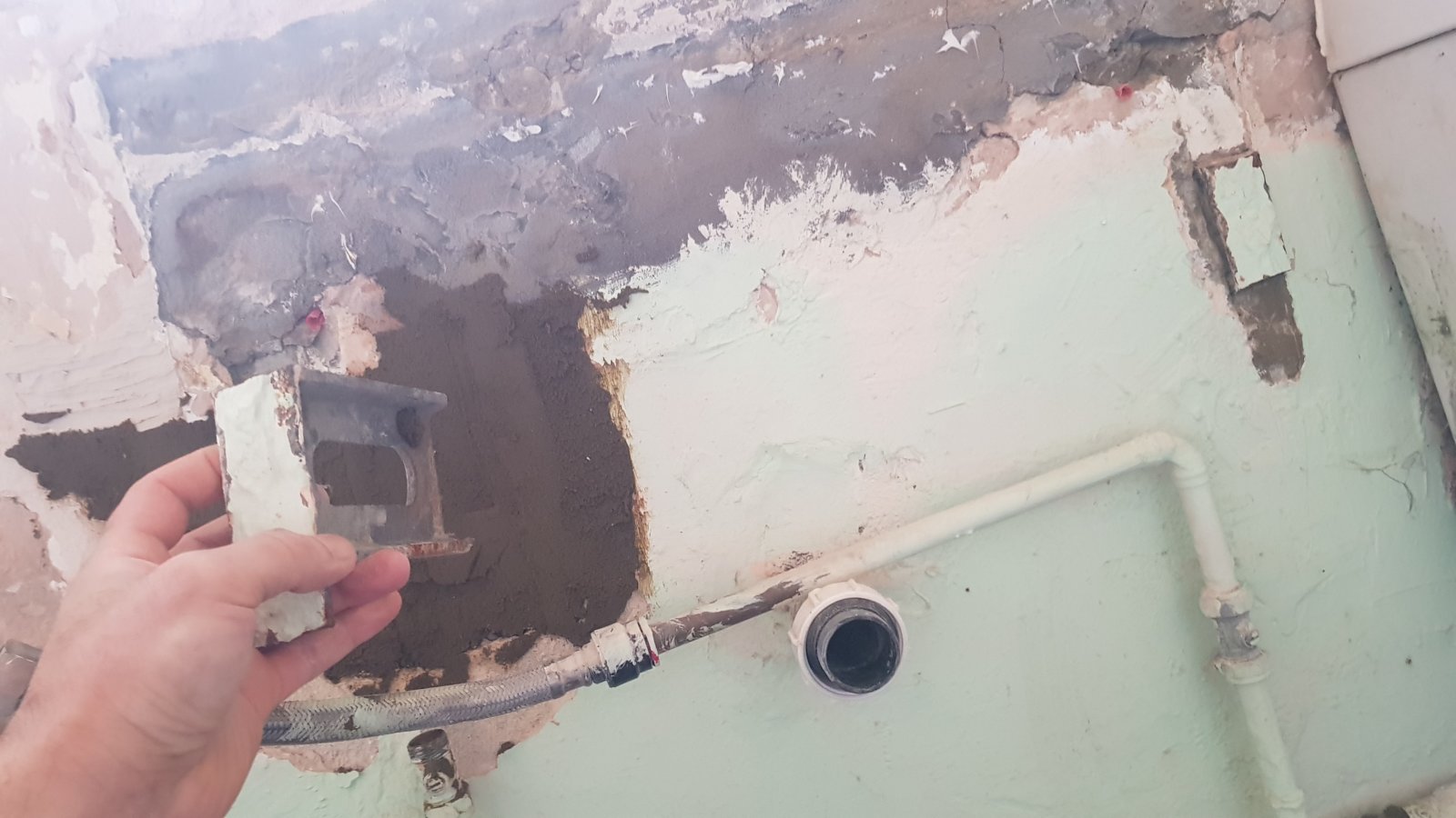

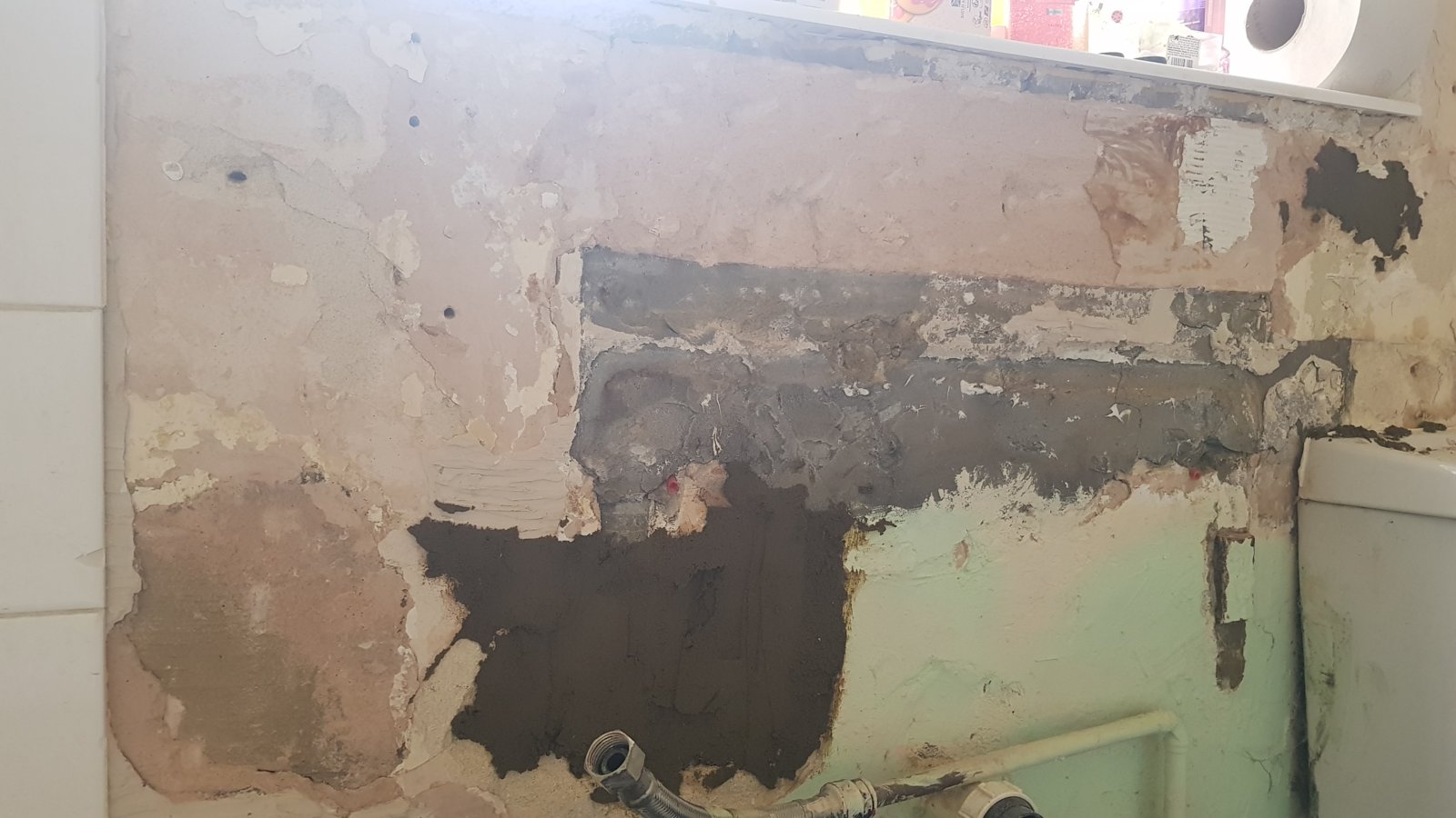

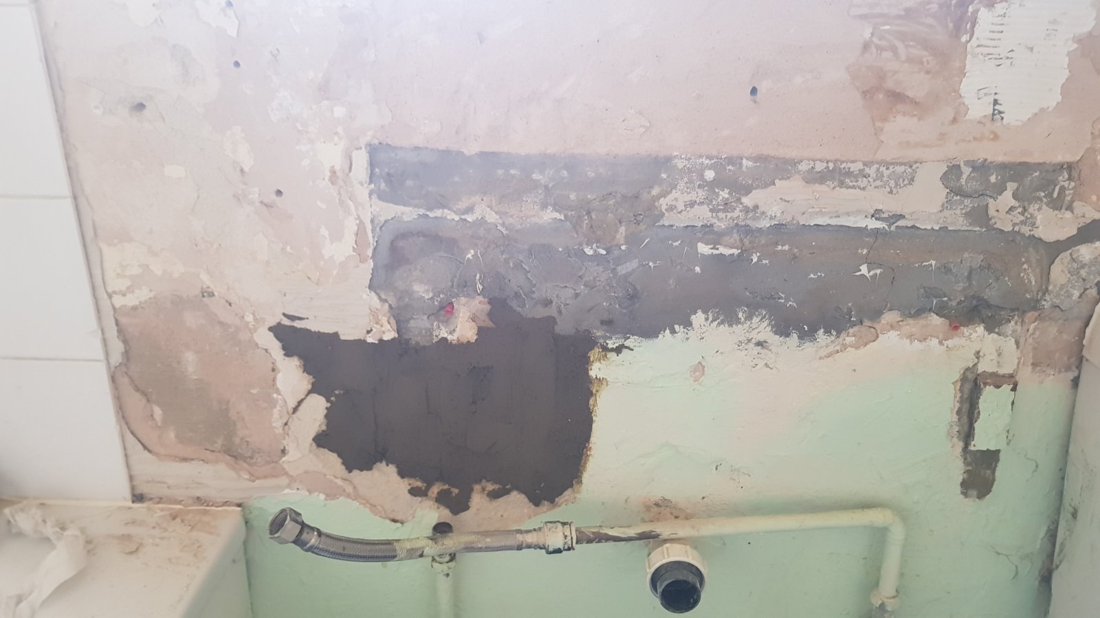

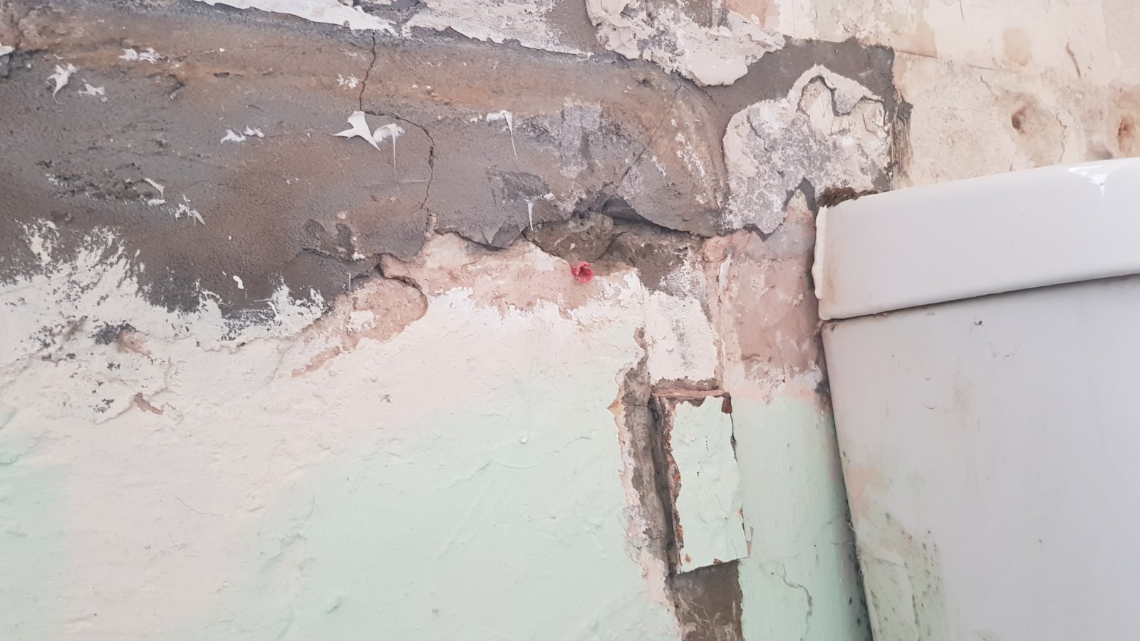

Hello is there a solution to this nightmare i took the old tiles off the wall is a complete wreck and found something to be bonded to the wall which is sticking out, also had to fill a massive hole, whats the solution here guys?

Chop out or cut off the old sink brackets then, bonding plaster in holes and skim the walls before retiling.[Remove all fittings first].
