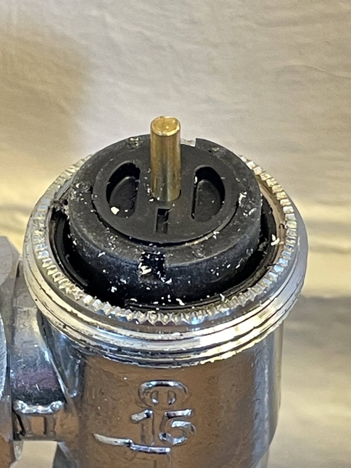

Hi all
I found the cause of one of my radiators being cold. It is 5-year-old 15mm British Gas TRV' plastic head. When I took the plastic head off, when the system was working, to check for stuck pin, the radiator suddenly started heating up properly. When I put the TRV's top back - it stopped, even on the highest setting. It looks like the inside movable part is not moving up and down.
Does anyone know of any compatible TRV's heads I can buy from plumbing merchants to replace the BG' TRV's head so I don't replace the whole thing?
Many thanks for your help

No interchangeability, unless by shear chance. However the BG TRV is probably a re-badged version of another brand. What do BG say?

Hi. If its the plastic one the part No is 555641 , If its the chrome one its 555617.
Ring 01162503128 (British Gas Spares By Post). p&p is about £3 i think
If it is the chrome one then a drayton TRV4 head will fit it.
Not sure about the plastic one.

I did more online research and accidently found this info:
"We fit a branded version of the Drayton RT212, same body as TRV4 but a different top, in white, with BG logo."
I looked at the picture of RT212 and it's almost identical to my TRV, apart from the top bit. Bull's eye.
I am posting this finding just in case anyone else needs to replace their or other people's broken British Gas TRV heads without replacing the whole valve.
Happy ending!
Spoke to Drayton technical support on Monday and they confirmed that British Gas TRVs are rebadged Drayton TRVs. They also told me that TRV4 and RT212 heads are interchangeable and can fit on the same valve body.
Off I went to my local Leyland and bought TRV4. My radiator never worked better.

I’m coming late to this thread. Searching Amazon for a RT212 valve cover got me a Homgen TRV head which does not fit. It sits too high and the underneath is different from my 2009 British Gas version. I’d be grateful for help. I spent a long time with a BG chatbot and online adviser without getting anywhere. Direct phone call endless delay.
