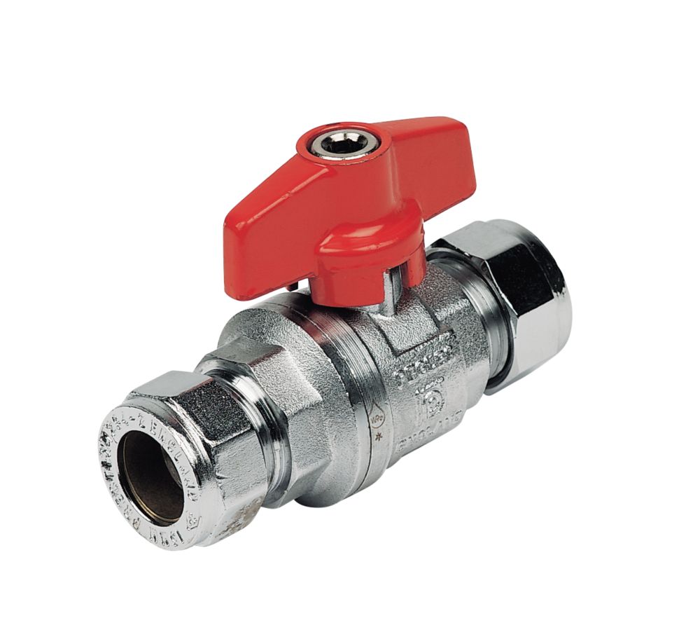

There are usually flexible hoses connecting the heater to the central heating pipes. Usually, there are isolating valves where the flexible hoses join the central heating pipework.
They may look like these
ae235
ae235
ae235
or they may not be present at all.
If they are present, they need to fully open (slot/handle in-line with the pipe as in the pics).
If they are both fully open, and one pipe only is getting warm but not hot, it's looking like a blockage in the heater.

Ok, I have just checked...
I have the first iso valves from the picture above and they are opened (as shown on the picture).
Assuming there is a blockage...how can I solve it?
