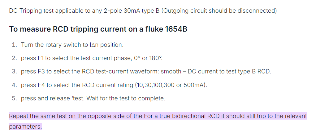

Here is some more confusion:
from here: https://www.voltimum.co.uk/news/doe... should still trip to the relevant parameters.
Hmmmmm !
Almost everything I've previously thought and written about this 'directionality' issue has been in the context of an AC residual current and, as I've said, I really can't see, in that context, how on earth the direction of flow of AC residual current (sensed by two conductors passing though a sensing coil) can possibly have any effect on the residual current sensing or RCD functionality (whether the device is called 'unidirectional' or 'bidirectional'!).
However, what you have just posted moves that goalpost by saying ....
If we're now talking about a DC residual current then, since I don't really know how a Type B device detects that (I guess probably with the use of Hall-effect devices), there's not a lot I can say with any certainty - although I would again strongly suspect that any Type B device (whether called 'unidirectional' or 'bidirectional'!) would have to able to detect a residual DC current equally with either direction of current flow - not the least because unless/until it arises the device can't possibly know anything about the polarity of a DC residual current that may subsequently arise!!
So, yes, I for one am certainly still very confused!
I must be missing something. So the supply comes from either DNO or the inverter, and the cable to be connecting them both together has a RCD placed at the DNO end, as once the device opens, the inverter will auto shut down.
So DNO to inverter flow direction easy, turn off DC isolator, and it can only go DNO to inverter, but to ensure current goes from inverter to DNO the panels need to be generating, and we need a method to measure the RCD time delay independent to the anti-island time delay, how?
I think the only thing you're probably missing is that, as flameport implied, most things written about this business seem to be confused/confusing!
So the supply comes from either DNO or the inverter, and the cable to be connecting them both together has a RCD placed at the DNO end, as once the device opens, the inverter will auto shut down. .... So DNO to inverter flow direction easy, turn off DC isolator, and it can only go DNO to inverter, but to ensure current goes from inverter to DNO the panels need to be generating....
Who knows? It could mean at least some if that, but what flameport posted didn't 'actually say' much of it! It doesn't say that it's anything specifically to do with PV or inverters but, rather, says that it is describing how to use a Fluke 1654B to test "any Type B RCD".
It might be talking of something akin to 'bench testing', with the "...repeat the test on the opposite side", meaning that the DNO should be moved to 'the other side' of the device, and with "...outgoing circuit should be disconnected" meaning that no inverter (or anything else) should be connected to the 'other side' of the RCD in either case - if it's intended as just a test of an RCD that could make sense, since connection of an inverter (or anything else) could confuse measurement of the performance of an RCD. For example, as you go on to say ....
.... we need a method to measure the RCD time delay independent to the anti-island time delay, how?
Indeed- and, for what it's worth, my personal opinion is that it's any such "anti-island time delay" would be one of the most iffy things about all this - since it's another way of describing a deliberate extension of the period of time during which there could/would be a 'widow maker' available to be touched!
As, I've said, I don't think that we (at least, I) know/understand enough to be able to comment particularly intelligently or usefully about any of this!
