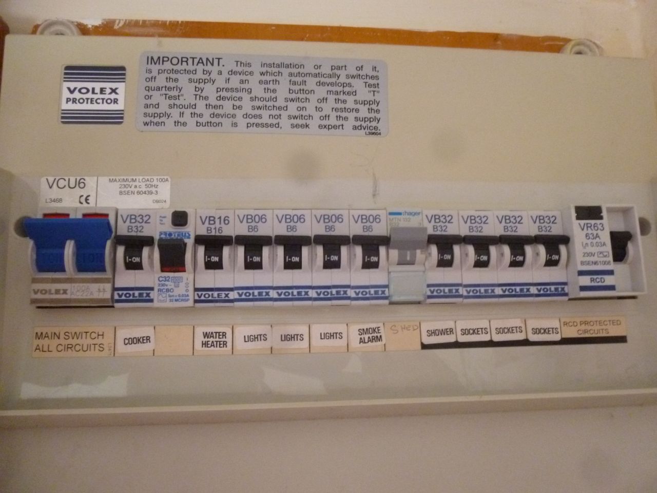

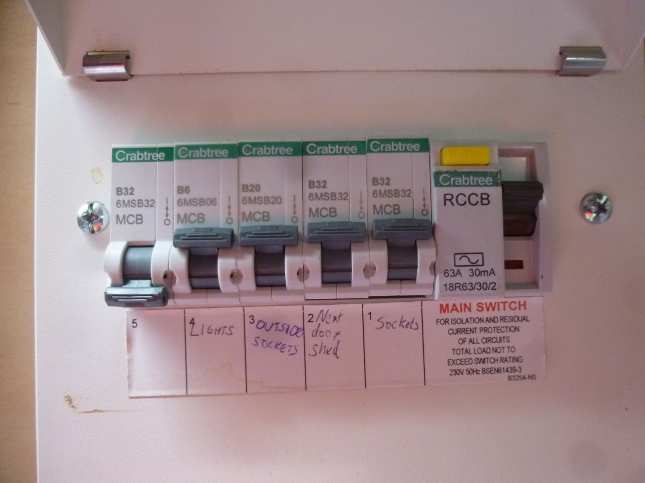

Hi everyone, excuse my electrical ignorance.
I'm looking at adding a little plug in solar system, two panels and a 800w microinverter.
Doing some reading online, I've seen mention of needing bidirectional RCBO, and others saying it's not needed.
My current setup is in the photos, the older consumer unit in the house, and the newer 5-way one in the shed which was put in about 2018.
There's a few potential locations for the panels, either adding an outside socket to one of the house circuits, or plugging straight in to the existing outside socket on the shed.
Is anything needing changed?
In the shed:

Three two are apparent, one three B32 MCBs in a consumer unit supplied by a B32 MCB is pointless, the B32 and the RCBO in the main consumer unit is the wrong make.

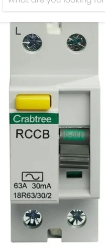

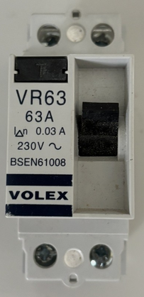

So assuming the supply to shed is not RCD protected and the picture of the RCD 1790782990834.pngshows no in or out, so OK type AC where we would like type A, but it appears to be OK with Bidirectional supply. The other RCD would technically 0.5 amp under the limit with a 60 amp DNO fuse, as 800 watt is 3.5 amps, and so 60 + 3.5 is over the limit, but it is so close I would not worry, you can't have an 80 or 100 amp DNO fuse as the MCBs total over the 63 amp rating of the RCD.
Personally, I would not have put all sockets on one RCD, clearly you can't have one on cooker circuit as not RCD protected on that side. But as far as plug in solar goes, there does not seem to be a problem, again I see no feed, in, or out markings on the RCD 1790783848822.png so that also seems OK for plug in solar.
The RCBO I can't read the writing to find a picture where the termials are not hidden, but it should not be there in the first place.
So all in all, can't see a problem with plug in solar, but can see a few other departures from what should be done.
