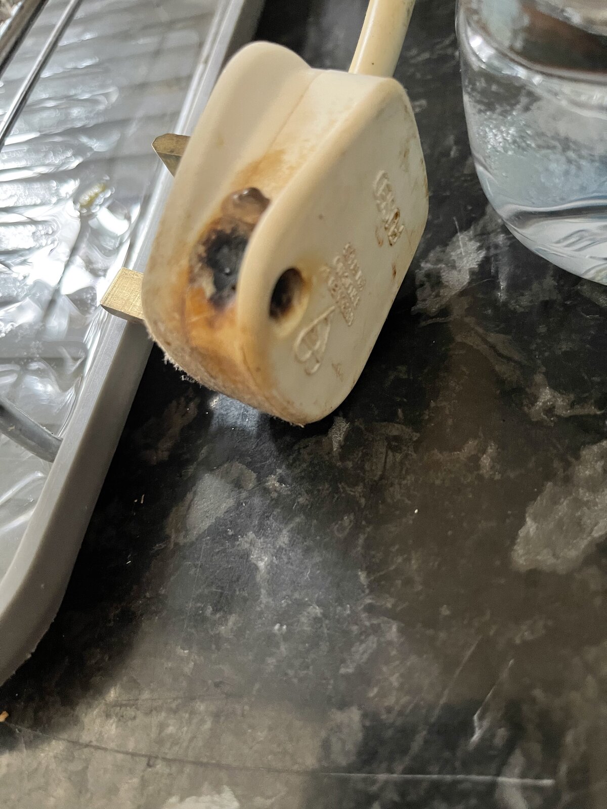

I looked at my washing machine plug and for some reason it has burnt spots. There are melt spots around the plug. I was also getting a burning smell. Turned it off.
How come this happened?

Probably the clips that should hold the fuse being a bit loose, giving a bad connection. This causes heat, which makes them looser, so more heat etc.
The cure is obvious, a new plug and probably socket as well. Fit something decent like an MK or Crabtree plug and socket, not a B&Q 99p cheapie, to avoid a repeat performance.
Cut back the flex a couple of inches if possible to give new, clean copper to remake the connections onto.

The socket does have a slight crack on it.
Also can you link me a good three pin uk plug? On amazon
That is what happens when they suffer overheating damage. You must change the socket as well

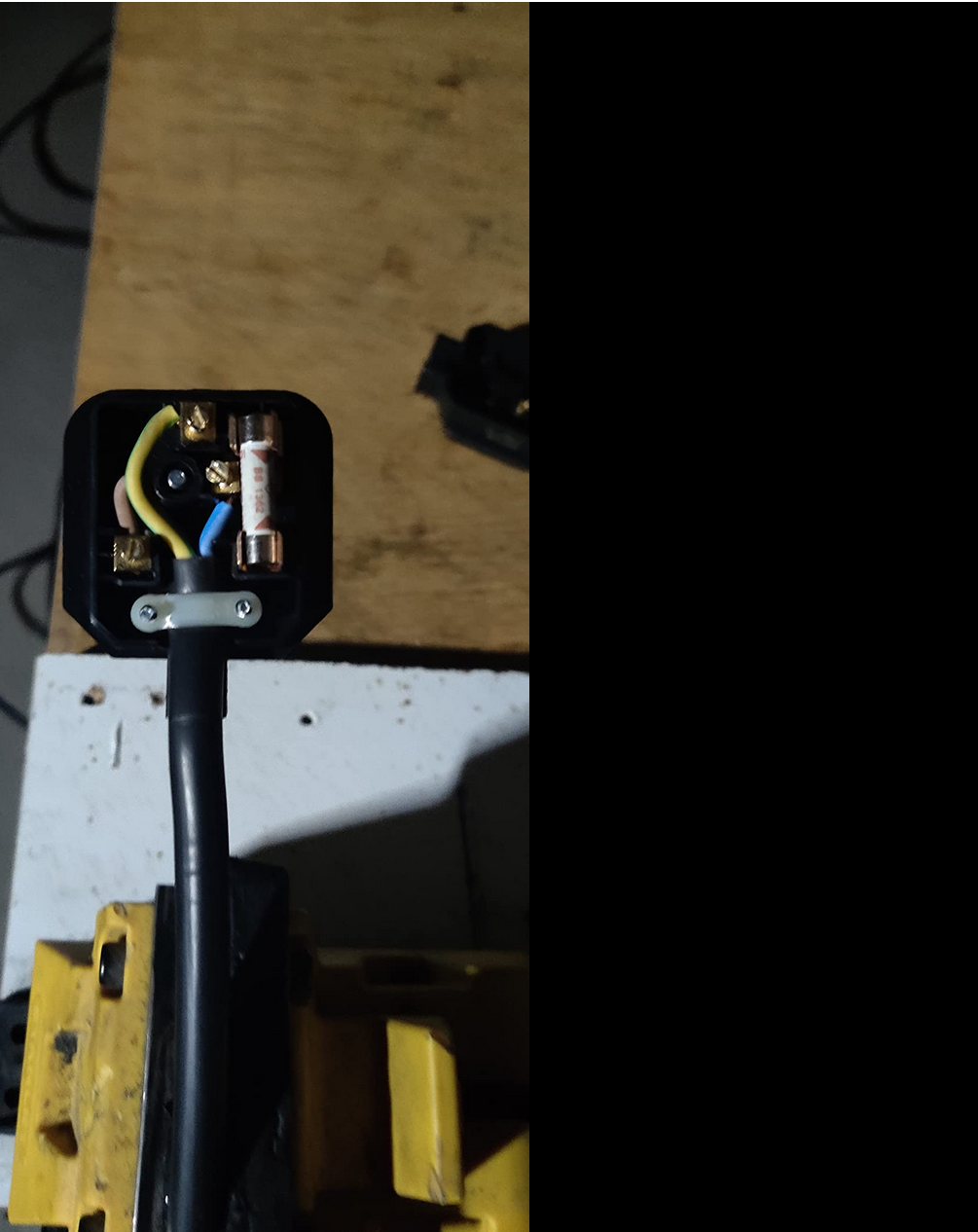

Nice !!
  • Screenshot 2022-09-11 at 14-06-06 Masterplug HDPT13B-MP Heavy Duty 13 Amp Rewireable Plug 57.5...png
Other than the conductors are not then identified correctly, does it really matter?
The fuse is still in the line conductor.
Perhaps not - but if the colours of the conductors correctly reflect 'the understanding of' the equipment being supplied, then, for example, any fuses within the equipment might be in the neutral...
The fuse we can see almost certainly is - but see above..
Kind Regards, John
Does that matter inside equipment? Many internal switches are on the neutral.
OR
See the rest of the world.
It may well not. However, if an L-E fault develops within the equipment, then a fuse in the neutral will do nothing to protect the equipment (assuming that the presence of an internal fuse indicates that such protection was deemed necessary/desirable).
OR .... See the rest of the world.
Yes, things are different in much of the rest of the world.
Kind Regards, John
