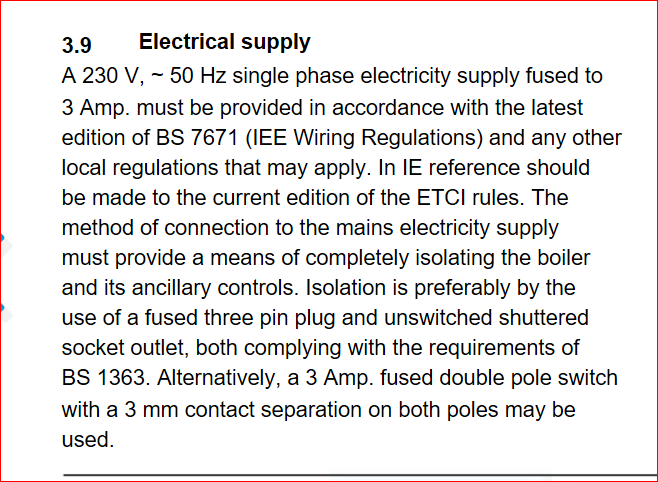

This is from a vaillant ecotec manual.
Isolation requires both Live and Neutral to be dis-connected

Thats similar to the instruction in the manufacture installation instructions for the boiler in the video :LOL:
diagrams are shown for a 3 pin plug & a fused spur. take your choice.

I reckon at some point most (all ?) installation manuals specified a fused switch (double pole with min 3mm contact separation) and so using a plug & socket doesn't technically comply with the installation instructions - even if it's better for several reasons. Thus it's become "the law" (to all those plumbers who know nowt about that new fangled electrical pipework stuff) that a boiler must be fed off an FCU and not a plug/socket.
