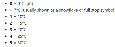

Heating experts share what the numbers on your radiator valve really mean "says Daily Express"
According to British Gas, the numbers on the radiator typically correspond to the following temperatures: 1 = 10°C, 2 = 15°C, 3 = 20°C, 4 = 25°C, and 5 = 30°C.
Really?
I have found the mechanical valve head has around 4°C between fully open and fully closed. Where an electronic head, more like 0.5 to 1°C. So the number to give 20°C varies depending on room size, radiator size, and outside temperature.
As to why headlines again, I don't know. If the 3 = 20°C then why not just write on it 20°C.

The numbers on TRV, cannot be directly translated to a temperature, because the numbers are only a rough guide. Actual room temperatures achieved will vary - because TRV's are mounted in far from ideal temperature sensing locations, and orientations. Some mounted vertically, some horizontal, some at floor level, some at the top of radiators. Some on outside walls, others on inside walls, and they are affected by the flow temperature of the boiler itself.
Mechanical TRV "fully open" stroke varies with the setting, the lower the setting, the less the stroke/opening when "fully open", so obviously cannot maintain a set temperature (see below) depending on conditions, however, in tests I did years ago I found that the hysteresis, at least on the one that I tested, was only ~ 1C, but it did/does take a very long time for the valve to fully stroke, probably due to the mass of the wax/liquid in the actuator.
The valve seat though is probaby of the "quick opening" type, nothing to do with the opening speed but based on the valve seat which is designed to give a big flow with a small opening, one might find that say 30% of the maximum valve stroke gives almost full flow to give reasonable room temperature control.
