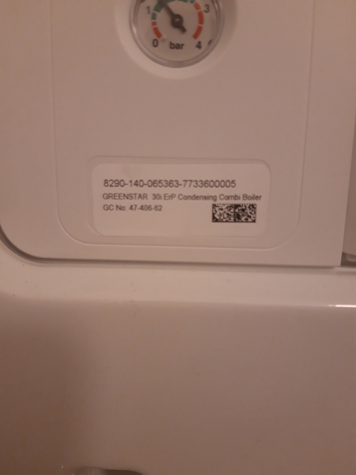

Hi all,
Hopefully someone can give some direction. We have just moved into a house which has a combi boiler fitted, we also have a hot water tank in a cupboard on upstairs landing and a cold water tank in the attic. Is it normal to have all 3 or is it possible to get rid of the hot water tank or the cold tank? The main bathroom has an electric shower and the ensuit is a pressure shower. Ive also noticed that the combi only heats water upstairs and not down stairs. Do I have any options?

What I would like is to have the combi boiler heat all of upstairs and downstairs whilst keeping the hot water tank as a back up, id like to get rid of the water tank in the loft if possible. Def a combi

If it’s possible to do, then you’d also need to draw off some water, to prevent stagnation. Also you’d probably need to keep the cylinder heated to 60 degrees to keep bacteria at bay.
