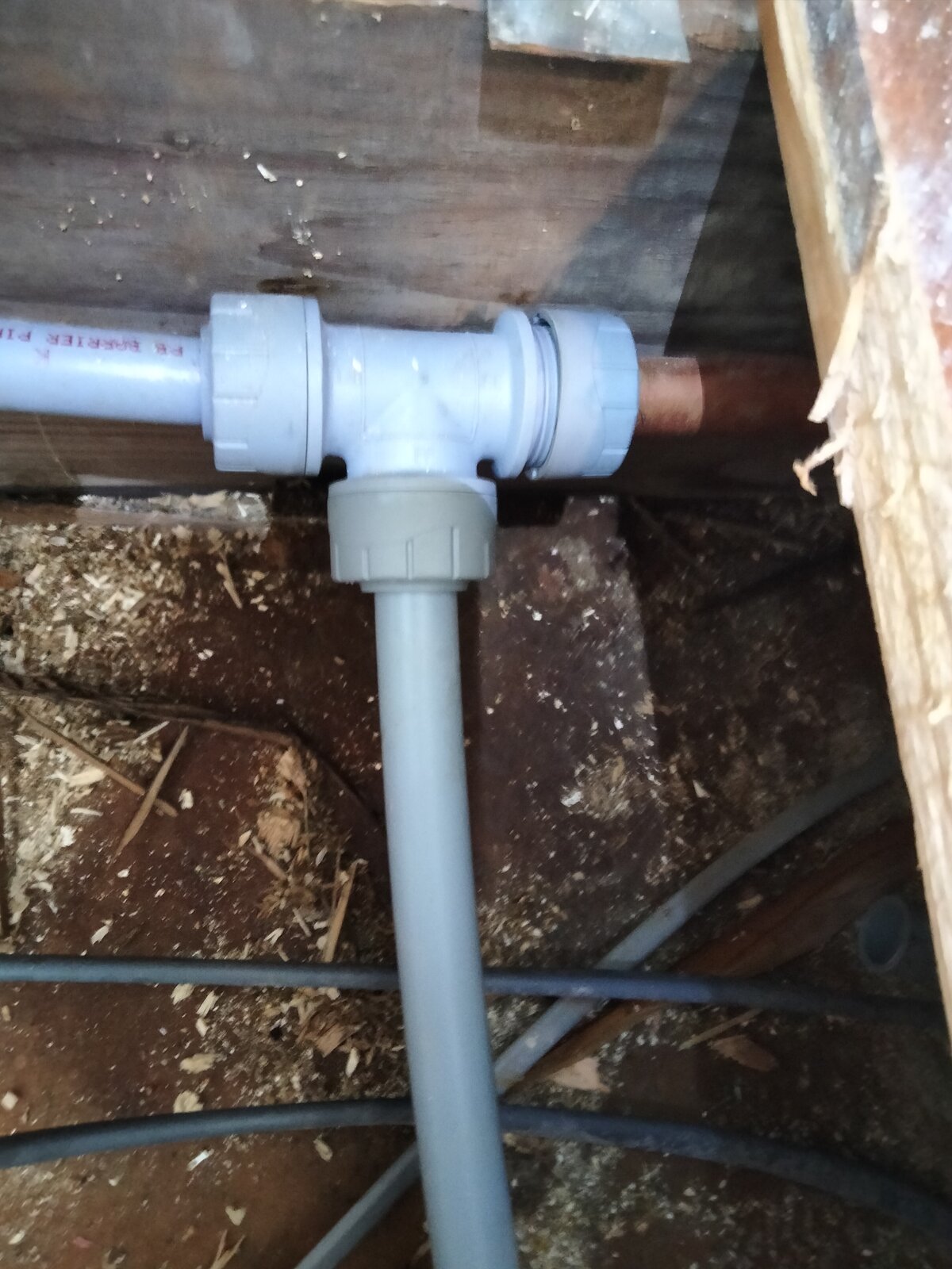

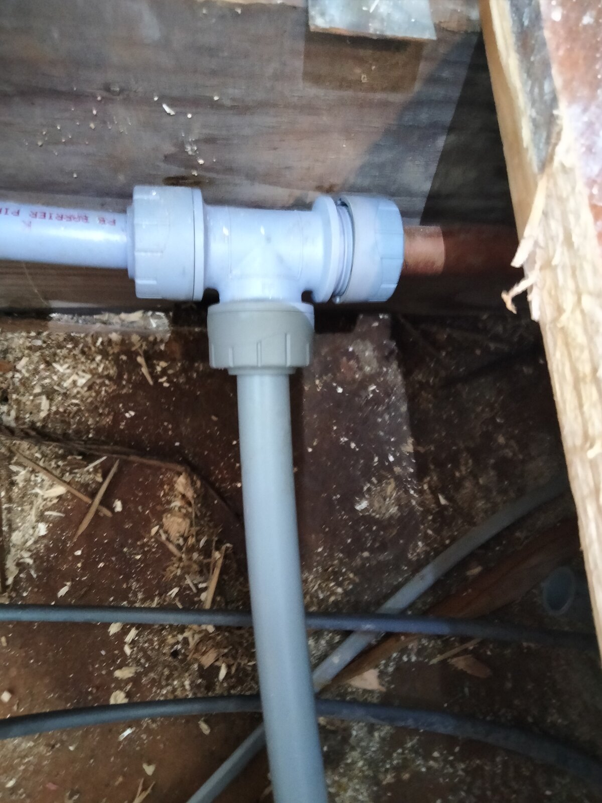

Polypipe fitting failed after 1.5/2years
That had happened was 100percent screwed on right when left the job 2 years ago.
The fitting is touching the joist could the heating and cooling over time or caused the fitting to unscrew?
There is a copper insert.
Dunno if this is relevant here but micro strains between different materials in a pipe junction can cause havoc over time.
Plastic expands at a greater rate than copper.
If the plastic has expanded faster than the copper then the junction looses its tightness. In this configuration, perhaps it waa loose enough to undo over time as the fitting rails up and down the beam during cycling.
Maybe.
So it could be the use of copper that was the issue. Have used copper before with poly with no problems.
Maybe.
If that was the case surely they should say not to use copper and poly together on a tee section. Was done to save fittings on the pipe leaving to the rad. It's 15mm copper bent straight up to the rad. Valve. As appose to 15mm poly, poly elbow and copper to rad valve.
Never used any of this (not a pro plumber) so this is just observation.
One thing to note as well is the configuration and stiffness of the various branches. There is a lot going on at this juncture. The copper pipe is much stiffer than the poly and crucially, this stiffness appears to be in the worst branch as its resisting the movement and flexure of the poly.
Could well be a install issue but there is enough going on here to not do something like this again.
Copper on the branch. Ok. But on one half of the header? Hmm.
