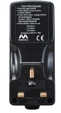

Does the first of those really contain a fuse? If so, what on earth purpose does it serve?
Photos show no evidence of a fuse (unless it's hidden on the bottom) - so what does "fused" in the name of the first one (but not the second, which is entitled "unfused") mean?
Kind Regards, John

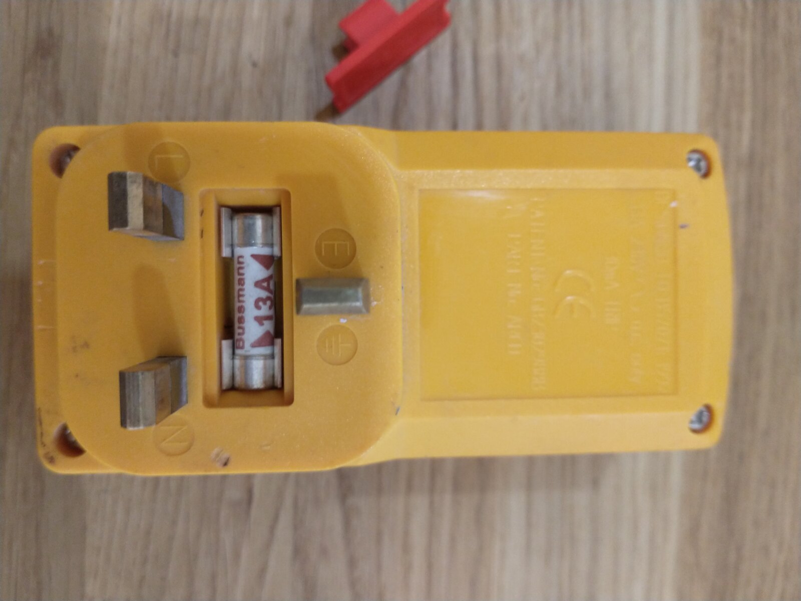

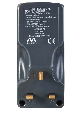

Oh, I was looking at the wrong one - confusing 'cos the colours of the two (on Masterplug website) were the opposite of the Screwfix photos . So it does have a fuse. Very odd!
Kind Regards, John
... and the description of the unfused one (but not the fused one) includes ...
It is non-latching, therefore power needs to be reset at each use and it is ideal for home appliance spike protection.
Kind Regards, John

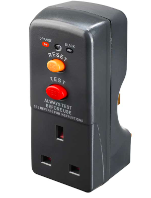

Is that a flex outlet at the bottom - for wiring direct to the appliance and no socket on the other side?
I'm doing well at getting confused and hence confusing everyone else. You're right - the fused one is hardwired and doesn't have a 'socket' to plug into. Whether the one depicted by Screwfix ("fused" AND with a socket outlet, described as a 'plug-through adapter) actyal exists or not, I don't know. The front of the fused one of which I recently posted the back view (showing the fuse) looks like this (no 'socket')

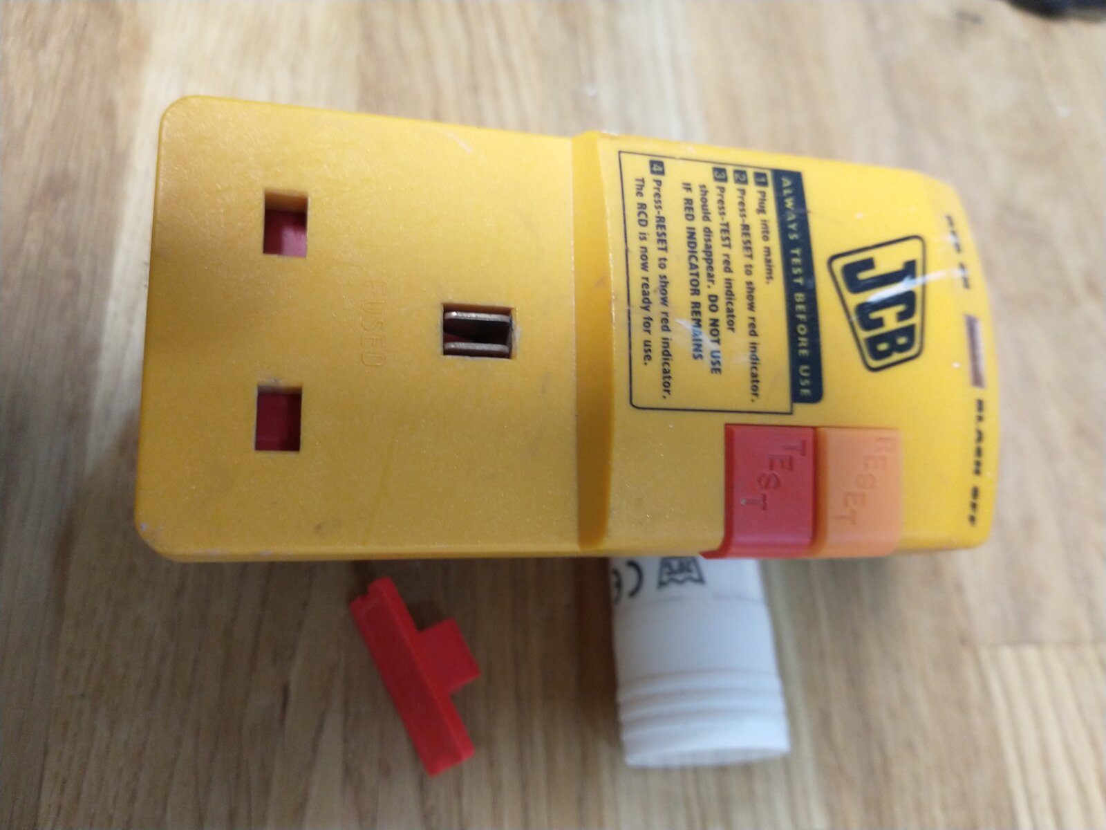

Just to add to the maddness - photos of my JCB 30mA RCD 'Socket' with a 13A fuse in the back.
Which brings us back to the question
Which brings us back to the question ....
Quite. It really makes little sense - as you may well agree, the two suggestions you previously offered (as regards 'what on earth is the purpose of the fuse?') seem a little far-fetched - although I can't say that I can think of any better explanations!
