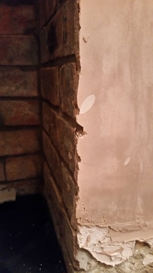

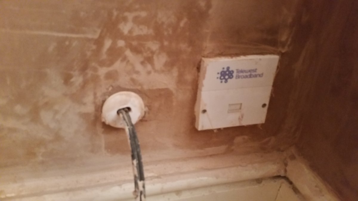

Our lounge was replastered this weekend and I'm not happy with the results. Its my first time having any plastering done, so can I get some advice on whether I'm being unreasonable.
This is the first time I've had any plastering done.
I agreed £600 for the lounge to be replastered. It's 5m x 4.5m with a bay window (but he said above and around the window was too hard so I agreed to leave that part).
I expected the walls to be smooth and flat afterwards, ready to paint.

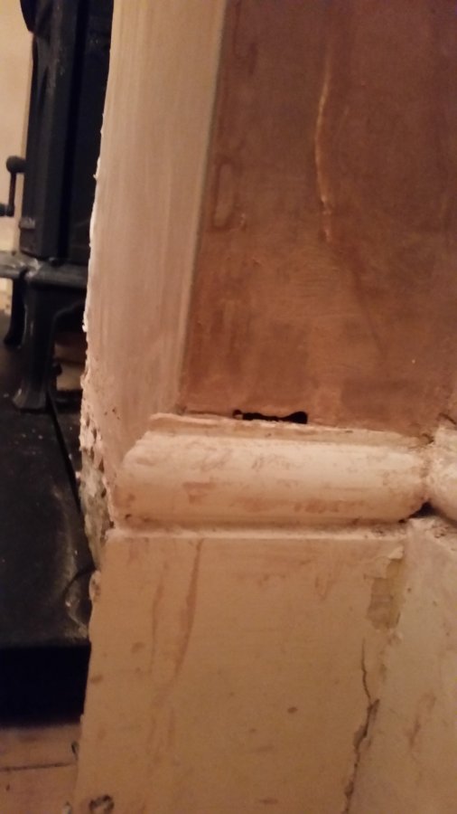

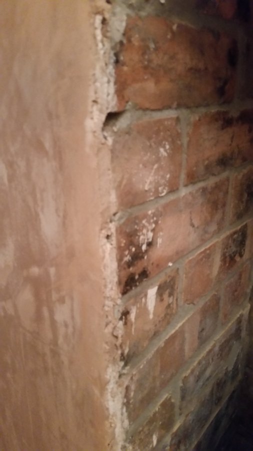

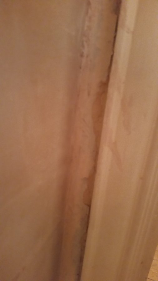

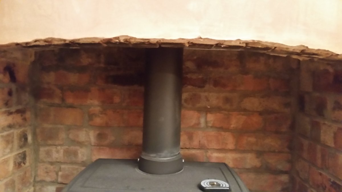

Instead there are many uneven and bumpy parts. The exposed chimney arch is particularly bad and I think painting will make it even more obvious. The skirting boards used to have a neat line and are now blurring into the walls in places.
I asked if he would remove the plug sockets before plastering and he said he would, but didn't, so they look a mess with plaster smeared against them. If I change the socket front I worry the plaster will crack?

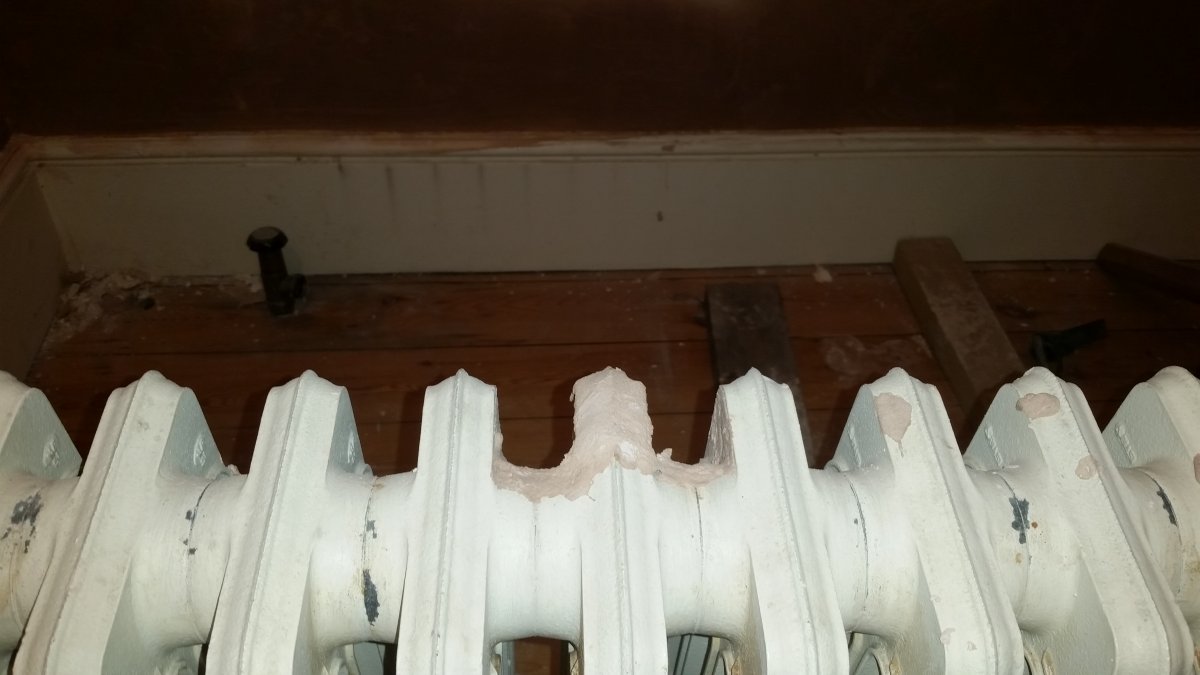

As well as the uneven finish he left a real mess, with chunks of plaster stuck to the radiator and log burner that I installed last week, and plaster ground into the wood floor.
I've paid half so far. The other £300 is due today. Am I right to be annoyed at the poor finish?
I don't know what to do now. I can't paint it like this. But there are so many uneven parts. If I send them all and polyfilla can I still get the perfect finish I am after?
Any advice would be really appreciated.

How would I remediate this in the areas where there is far too much plaster around the skirting? Does it need to be chipped off and done again?

As soon as you said 'checkatrade' all our eyes rolled round and round. That's just had one coat and no polish. I'm not the world's fastest plasterer but I get perfect results.

An absolute rubbish job,, and the "plasterer" said "he couldn't plaster above and around the window, because it was too hard", says it all. It looks like a job done by an amateur rather than a firm. A real/good plasterer would NEVER "plaster in" any socket the way yours are. A real plasterer would "at least" loosen the socket and get behind it. Cleaning off skirtings, sockets, ceiling lines etc as you go is paramount in a good tradesman too,, clean/tidy. A real plasterer would "never" go into any room and tell the customer "well, i can do this and i can do that, but i can't do that over there because it's too hard",,, dohh. CheckATrade in my opinion, means absolutely nothing really, I mean, who wants to pay someone to get work. Your plasterers can't be much good if they have to pay CheckATrade to find them work. As Joe90 said, a good tradesman doesn't have to rely on CheckATrade to get work,, building a reputation gets you work. If you can't sort out this mess with the firm that did your job, then get an opinion from a "reputable" local plasterer and take it from there. As I said at the begining, "it's a rubbish job", and an insult to the plastering trade.

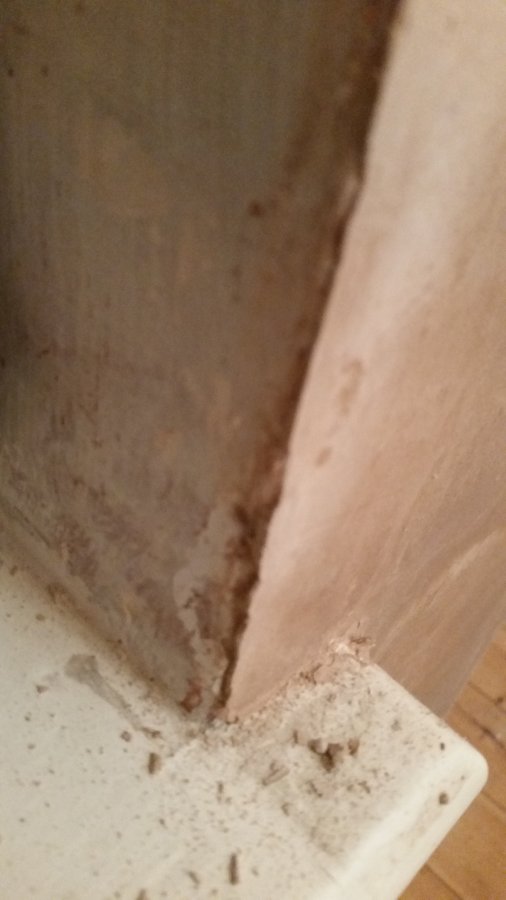

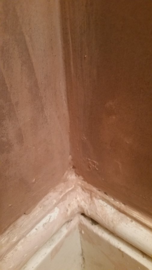

He came back yesterday to "put it all right" but really only spent an hour cleaning (and not at all well). The surface is still very lumpy on two walls (the first two are fine) and the corners are all very rough. He told me that it is the decorator's job to put right not his (but I am the decorator!).
The chimney breast arch he repaired with polyfilla, but it still looks not at all smooth or even. Shouldn't this be done with some kind of edge bead?
What to do now? He's chasing the other £300. I know I will have to spend at least that to put this right. I feel like the £300 I paid already is already more than enough for one man for one day and a shoddy job (given that the quote was based on 2 men for 2 days).
Below are pictures taken after he came back and fixed it yesterday. Not much better.
