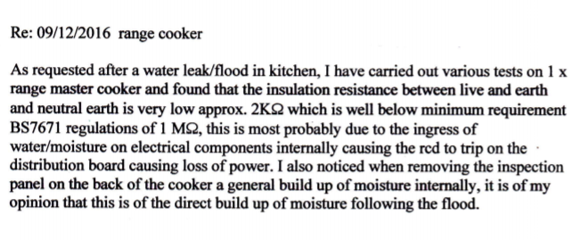

I'm having ongoing issues with my insurance company, and the loss adjuster.
This is regarding a leak/flood from our kitchen stop cock. The "wife's washing machine and tumble dryer failed a test, conducted by Rainbow Flood management. Unfortunately they failed to test our range cooker which was sighted close to the wife's appliances.
The loss adjusters told us to arrange for the cooker to be tested. The report was tested failed on resistance.
The loss adjusters need to know if vhe cooker could be repaired, as we are having contact issues with appointef electrician.
The loss adjuster appointed a 3rd party to retest the cooker 8 months after the water leak/flood. Electrical Logistics technician reported back that the cooker passed the testing. The technician never used his electrical meter, or even switched on the electricity to the cooker????
The washing machine and tumble dryer got replaced, instead of being repaired.
Any ideas on the cooker??

If the 3rd party electrician didn't use any tester then I'm not sure how he could report back to them saying it "passed". What did he actually test/do to the cooker? Or was you not present throughout his inspection/testing?
We turn the electrical supply off every time it's not in use, due to previous issues with the RCD tripping. Don't want to ruin my frozen steaks etc.

He actually only did a visual inspection on the back panel, and a few pics of the actual cooker. He might have been interested in the rangemaster.
He didn't do any testing!
You can quote and reply in the same post btw. As for the next step, you need to speak to your insurance company and explain what they did/didnt do and that your not satisfied with the testing (or lack of) that happened, and if they can have someone else actually do the testing so that you/they can be confident the appliance is safe to use.
Only then can you know if the cooker requires repair/replacement (if anything at all). As for the other items getting replaced, that depends if you have a new for old policy or most likely it was just more economic/simpler to replace.
Has it dried out yet?
You would not be able to use it without an RCD tripping with results like 2kΩ.
