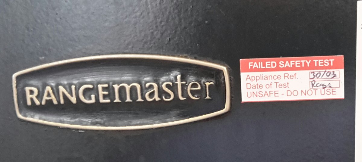

Finally had the cooker retested by a nominated company.
Suprise suprise it FAILED
For what reason did it fail? Do you have a copy of the paperwork? Also it failing might/might not have anything to do with the leak.
