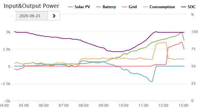

This shows the use, just before 8 am AC turned on, to start with running on battery, by 9:30 am the solar was powering it, but was 11:30 am before the battery was fully recharged, so then the domestic hot water started using solar it was 12 an hour before noon (we are in British summer-time) before that too was satisfied, from than exporting at this moment 3.5 kW being exported, my array is 6 kW with a 5 kW inverter.
So about on the 5 kW limit. It is costing me, loss of revenue at 12p/kWh so 9p an hour, so may not be efficient, but at 9p an hour, I am willing to pay that. If it keeps being so hot, then out with the SDS drill and a hole in the wall for the condensate.
